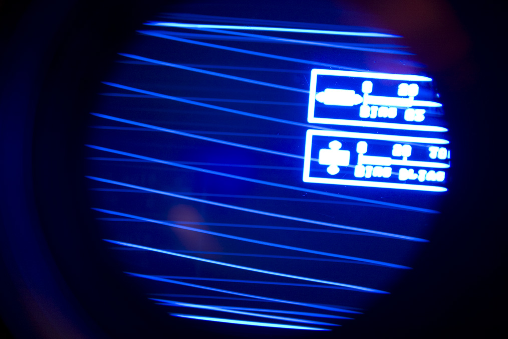

My PJ has been running like a top recently, so before my superbowl party yesterday I decided to tweak the astig and flare as it was looking a little off. I took the top cover off and moved the HV splitter/tube covers to tweak the astig/flare. When I started it up the blue tube problem presented itself (pic below). Other symptoms are the tube cutting in and out randomly, seems to be "off" more than "on" (this is looking on screen). However, when looking in the lens, those weird retrace lines are always there, and the pic is just really, really dim with occasional flashes of normal brightness.
I have reseated the VIM, focus board, HDM, neck board, CLM, HV leads, HVPS, LVPS. The problem seems to be independent of G2/drive controls.
I swapped the VIM and G2 leads from the blue to the green and the problem followed the wires (green got wacky, blue was fine). I didn't have time to swap the VIM/G2 leads independently to see which one was the problem.

Posted: Sun Feb 03, 2008 10:41 pm    Post subject:
Have you tried swapping the neckboard.
Try reattaching the HV lead.

Posted: Sun Feb 03, 2008 10:43 pm    Post subject:
Hi Zebu,
I didn't swap the neckboard but I just swapped the Blue G2/VIM wires with the Green G2/VIM and the problem followed the wires, so now the green tube is acting up. So it's not the tube or neckboard, it seems to be a problem with the VIM or G2 control?? I'm going to reseat the LVPS and CLM...
Posted: Sun Feb 03, 2008 10:50 pm    Post subject:
Try swapping the G2 and VIM leads indepentent of each other, this will narrow down the problem.
Also check the VIM lead connection on the VIM, I had those come loose on my 8000 and it caused all sorts of problems, however I never had anything that looked like that. My guess is it's G2 related.

Posted: Sun Feb 03, 2008 11:37 pm    Post subject:
Erik
Hey Erik,
I was going to do this but ran out of time. As another kick in the teeth, after I reseated the CLM the projector stopped responding to the IR remote after initial power-on. After letting my blood pressure settle down we'll just watch it on my 27" TV Crying or Very sad And I'll have to fix this later... Sad

Posted: Mon Feb 04, 2008 4:02 pm    Post subject:
Ok, I've edited the first post to add new information and much-needed coherency.
CRT_Ben
Joined: 28 Aug 2006
Posts: 1684
Location: Northern Virginia
Posted: Tue Feb 05, 2008 3:43 am    Post subject:
OK - I bought some contact stabilant tonight, and went through cleaning a bunch of contacts, pressing down on socketed chips, etc.
The set is responding to the remote again, which is good news - so now we're back to the original problem of the faulty G2 signal. I put the VIM wires back to their respective tubes but left the Green and Blue G2 leads swapped. The problem is still on the Green tube, so this is solely a problem with the G2 signal. Does this indicate a bad HVPS? Can the G2 section be fixed?
Thanks in advance,
Ben
Posted: Tue Feb 05, 2008 4:44 am    Post subject:
Take out the hvps and check the 560kohm reisitors see if they are all close to the same value for each G2(color). Also look and smell around to see if anything burned up on the HVPS. There are pics of modded HVPS on the Marquee group purchase thread to see what i'm talking about.

Posted: Tue Feb 05, 2008 6:09 pm    Post subject:
Thanks in advance,
Ben
yes, the G2 section is on the un-potted side and can be repaired.
