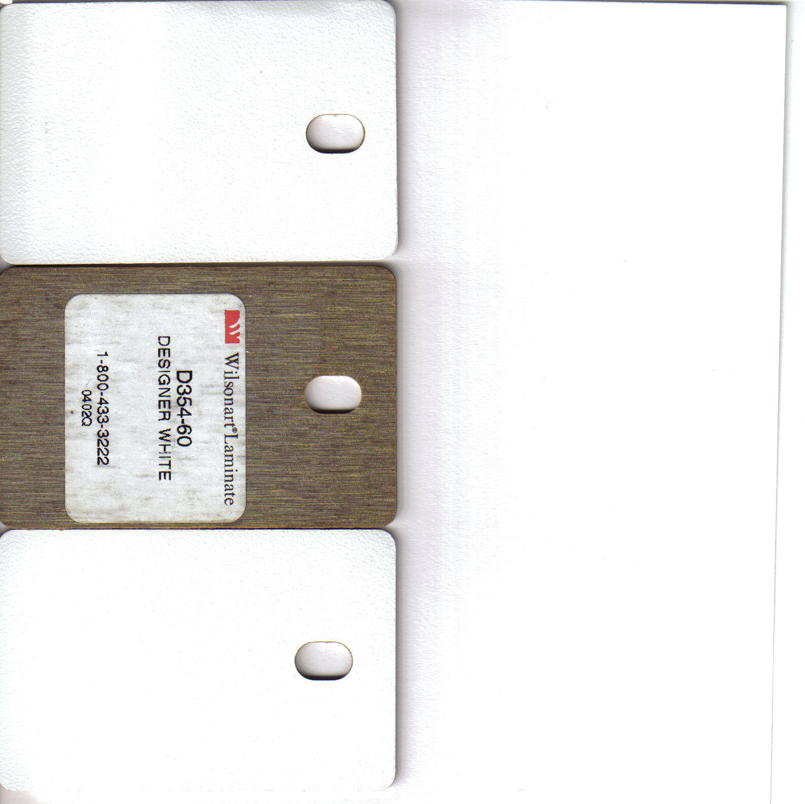

Posted: Sun Feb 10, 2008 4:27 pm    Post subject:
Yeah, DEFINITELY opaque. Thickness is around 1.22mm and it's made of a plastic composition, so you can see why it doesn't transmit any light.
Compared to most pro screens, though (like Stewart) - I wouldn't really characterize it as that 'smooth' or as that 'matte'. It's got kind of a 'pebble' or textured finish to it. WilsonArt calls the finish "60 - Matte", and they have several finishes that are much smoother all the way up to a mirror-style polished gloss.
Here's how WilsonArt describes it:
#60 Matte
Textured finish with a moderate reflective quality. Recommended for horizontal and vertical
application. Glossometer reading: MD and CD 10 ± 2.
If you want, I can try to snap a macro shot with a Post-It note or something for reference so you can get a sense of what the surface looks like in person.

Posted: Tue Feb 12, 2008 12:36 am    Post subject:
How about a scan? Here's 3 samples of Wilsonart on the left and a regular sheet of white paper on the right{HP Bright White Ink Jet paper, 24lb(90g/M2) 108+ brightness}

Posted: Tue Feb 12, 2008 1:27 pm    Post subject:
Hmm it LOOK's like it has the same texture as the paper?
BG1208 and BG1208/2
Posted: Tue Feb 12, 2008 1:58 pm    Post subject:
No, that's probably the cheap scanner causing that. The area right next to the Wilsonart is shadowed. That makes it look like it has texture. It's hard to get the texture to scan just right. The paper is smooth and the Wilsonart has a fine bumpey texture.
