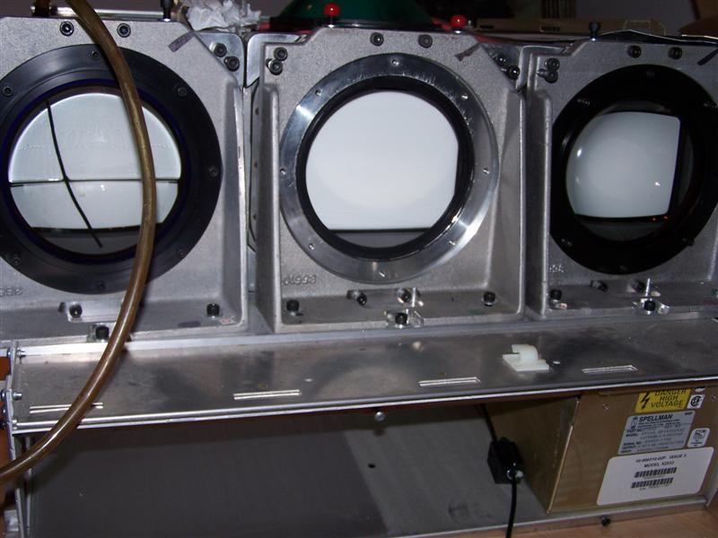

Well I got lucky this weekend with a Dec 99 Christie 9500 LC Ultra that was for sale on Videogon in Toronto. The projector was listed at 5000 odd hours, and no pics of the tubes, and just a pic of the back of the case. I was a little bit leary, and would not have bought it if I couldn't check it out. The seller didn't want to send pics of the tubes, because the projector was installed and he could not get it down or get the lenses off for a pic.
So I decided that I would make the drive and check it out. For the price he was asking and the hours on the machine, I was expecting worn tubes, or more. So I took my brother along for a hand, and we lifted the projector down, and I removed the green lens. To my suprise there was no wear on the green it is a 9, and all the tubes are the same!!! I said that the tubes must have been replaced, but he said they were originals, and the reason they are so good was for the first 4500 hours the projector was installed with 3 other 9500's on one screen showing black and white gun camera footage, and they never ran the contrast any higher than 15! No wonder they look like they have less than a 1000 on them. It even has GT17 lenses, the thing is clean as whip inside and out!
Not a bad score for $3500.....

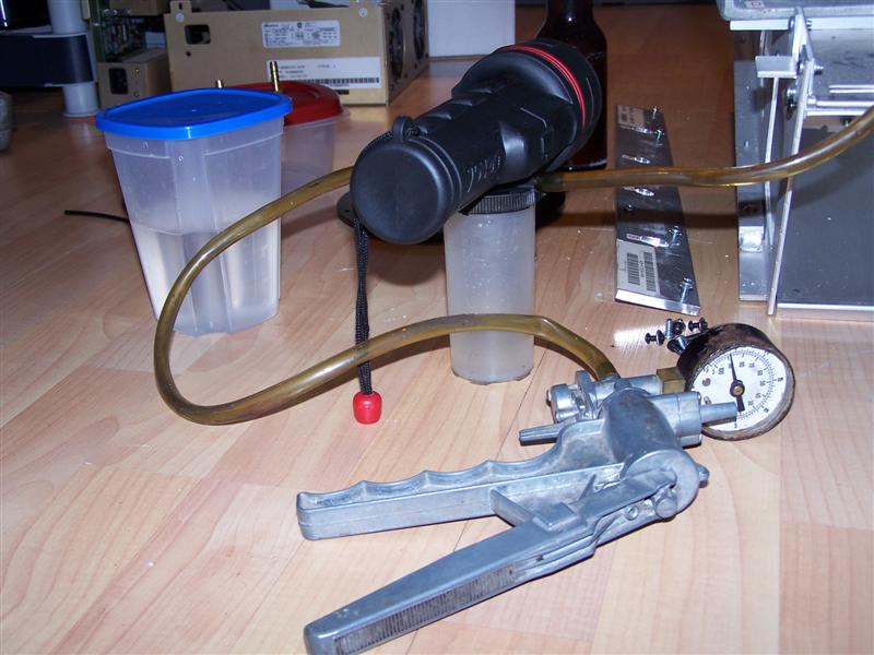

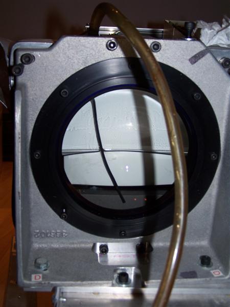

Well after trying to remove the glycol with a couple different syringes, I have discovered that it is a ROYAL PITA! Why the hell are those holes so small Twisted Evil .
So I may have come up with a better way to do it, and a lot more fun. I used a automotive vacuum pump that are used for bleeding brake systems, with the fluid canister. The canister holds 120 mL, and comes with various adapters. I could not find a hose with the right OD to fit in the hole, so I took some 18 AWG wire, removed all the copper from it, and just used the jacket for the tube. All you do is hook everything up, pump the vacuum to 30 inches, and walk away, 10 minutes later the canister is full. Saves a lot of pulling on a syringe! I did 300ml in about 15 minutes, no spills, and no work Smile
I will see if I can get some pics of the setup when I do the next tube.

Hey I was thinking of doing that with a manual brake bleader. I need to bleed my NEC's(Runco) tubes. I noticed lst night there's no air bubble.
I also have a big syringe used to prime continuous ink jet systems. I bet that would speed things up too. Hmmmm

I tried a large syringe, but I had no luck drawing that quantity of glycol threw the small tube. The brake bleeder worked the best for me.

I'll post a picture. It has check valves and is set up to pump air. It's pretty cool actually.

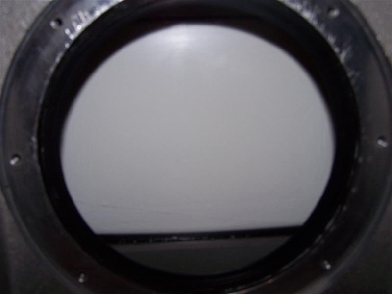

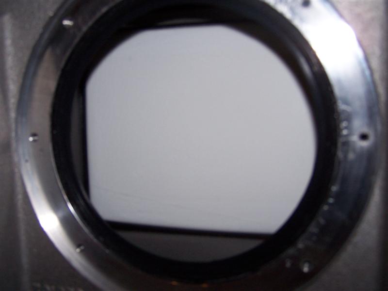

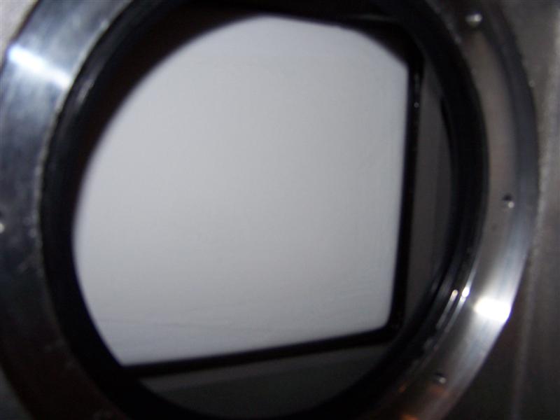

Well I got the Green drained and the C-Element out without hurting anything, just two more to go. I cannot believe the green tube, has anyone ever seen tubes this good with 5000+ hours on them...Wow.
Also here is some pics of the brake bleeder setup.
