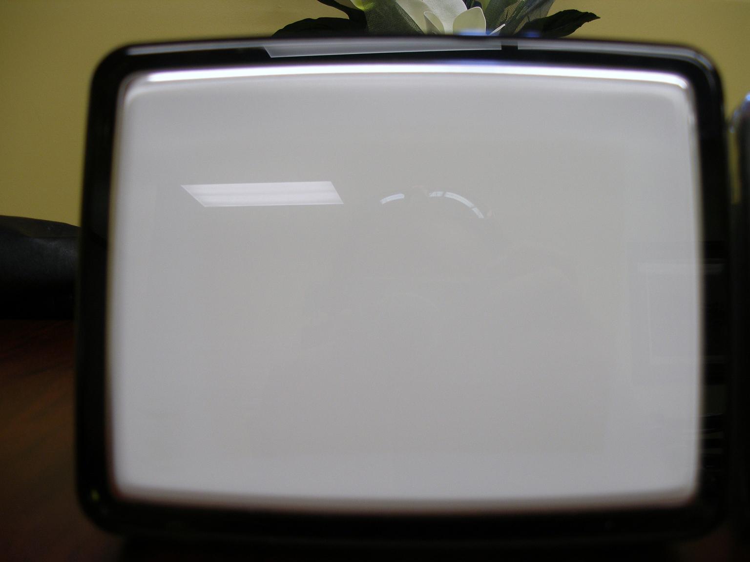

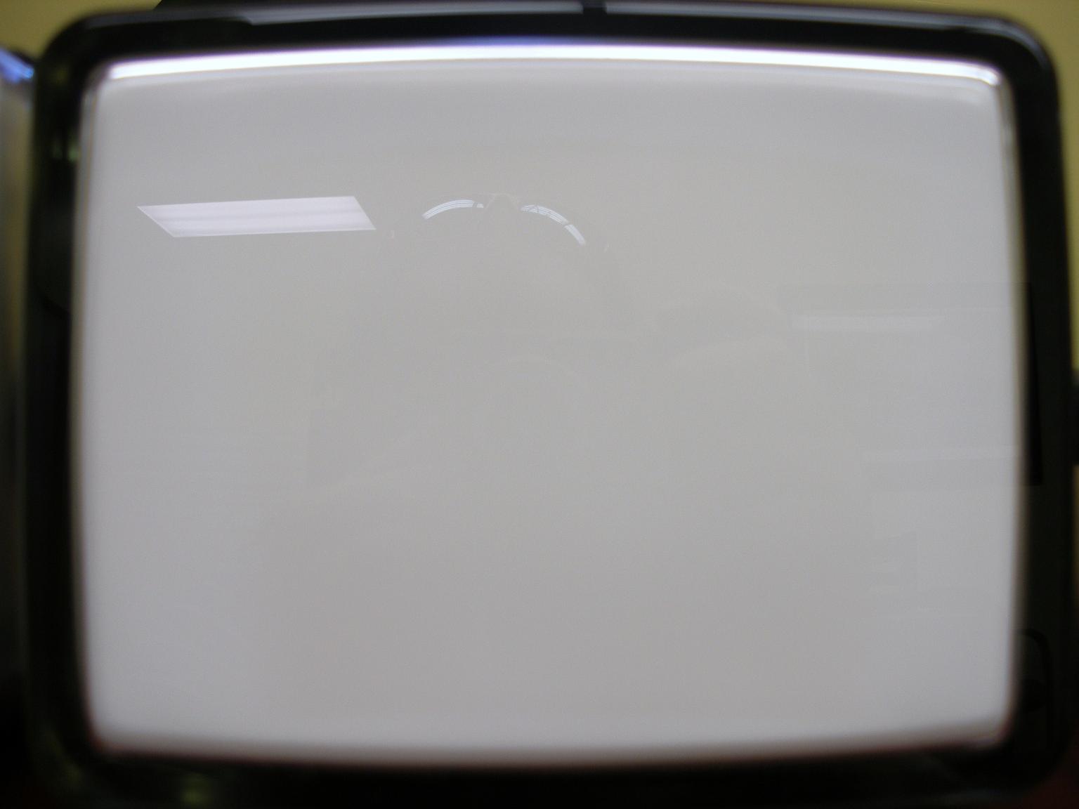

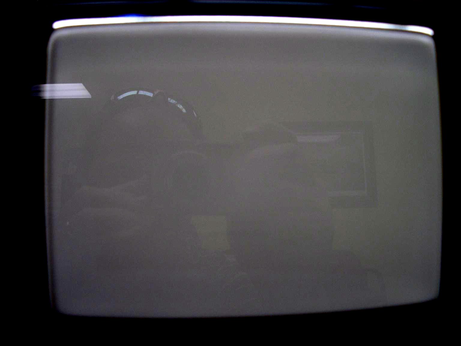

look I have been around alot longer than you think go check avs same user name I have been around since about 2005 I don't post much because I work crazy hours..
and I think many of you would use the tubes The ones i recieved you cannot even see a wear patern on the blue and red but it is so slight on green it is almost not visiable.
here are some pics for you to see what they are like.
Red Lug Used from tubular outlet
 Filesize:  86.94 KB
 Viewed:  4127 Time(s)
Green Lug Used from tubular outlet
 Filesize:  80.6 KB
 Viewed:  4153 Time(s)
Blue Lug Used from tubular outlet
 Filesize:  80.33 KB
 Viewed:  4125 Time(s)

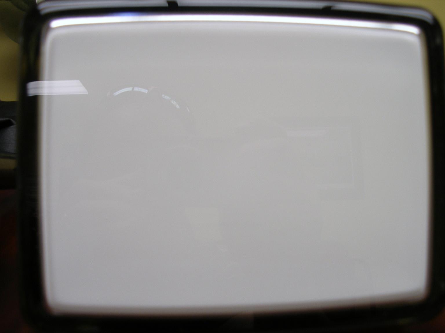

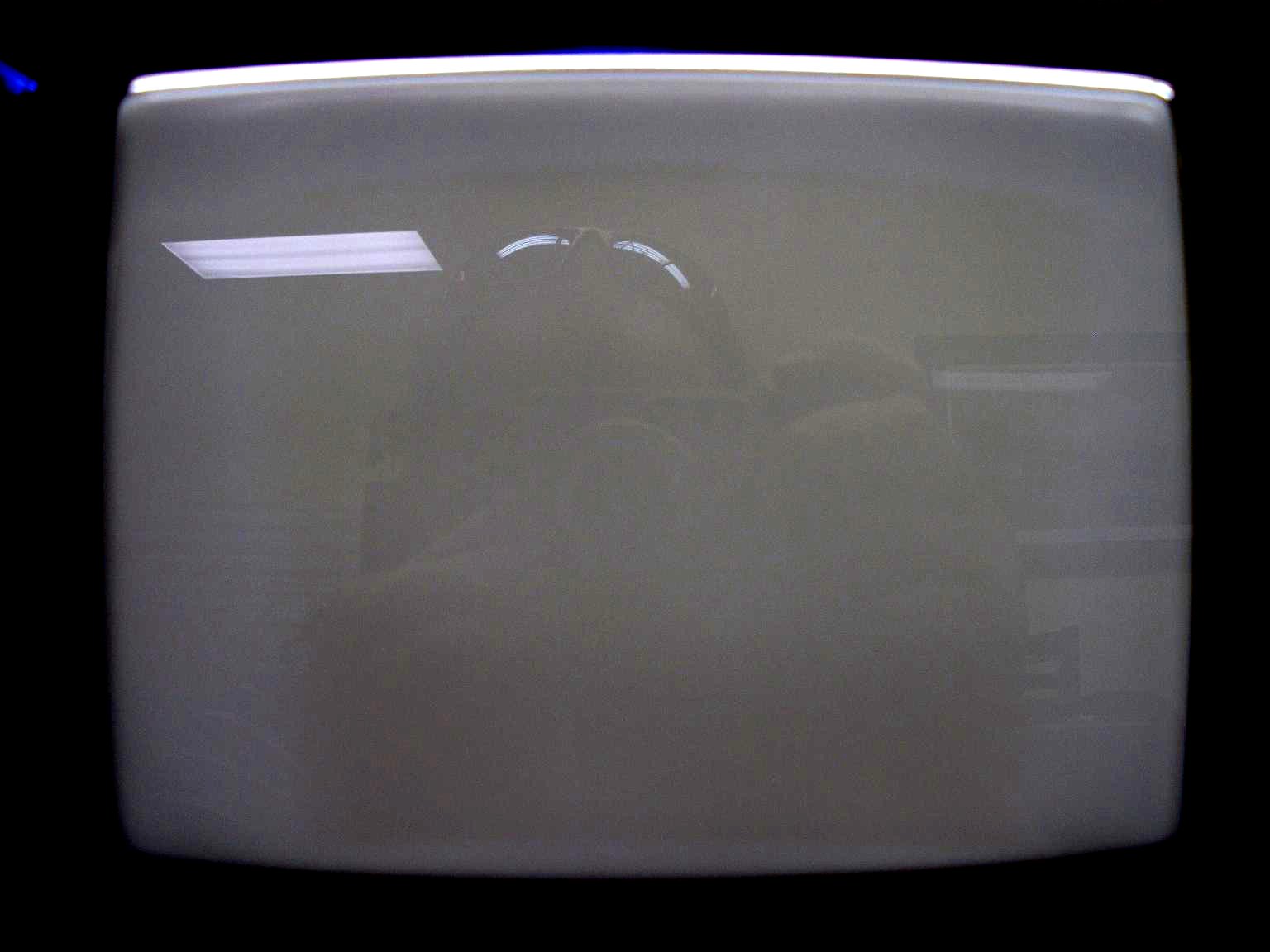

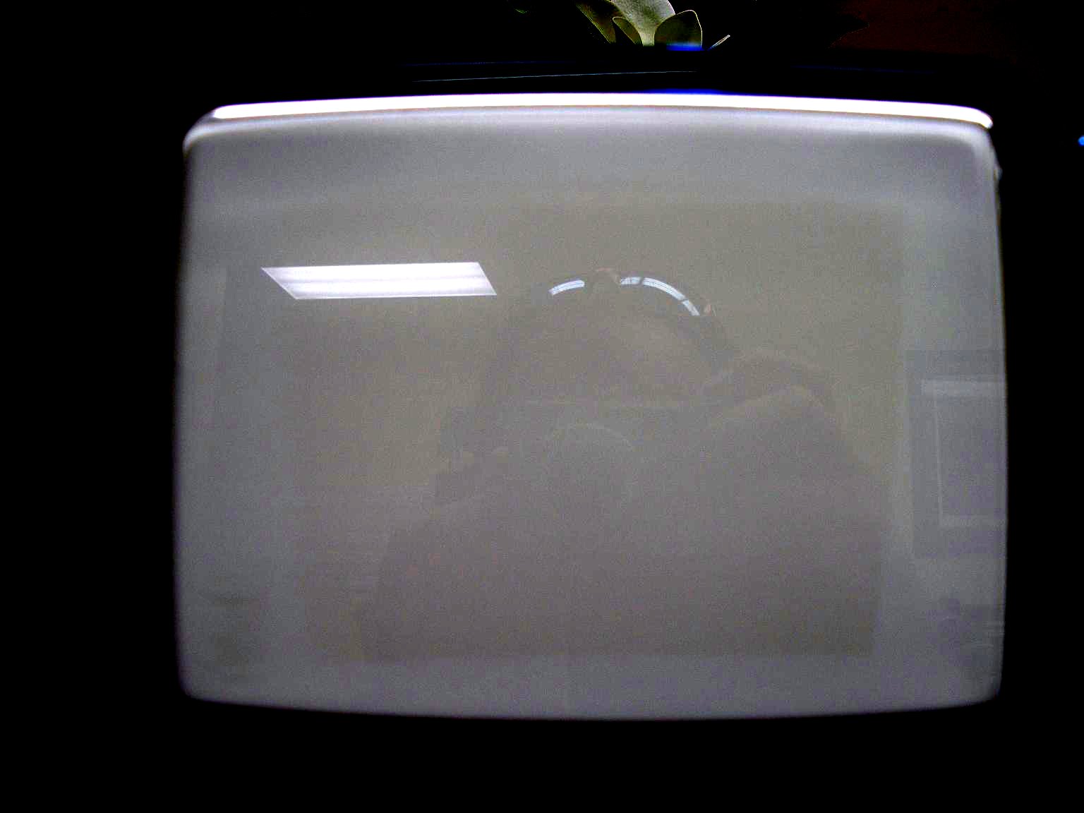

Well they certainly aren't bad, but if you run outside, the wear area, you'll see it. Still, for the price, not bad. Some photoshopping with the brightness/contrast makes the wear much more visible:
 Filesize:  69.28 KB
 Viewed:  4115 Time(s)
 Filesize:  63.99 KB
 Viewed:  4134 Time(s)
 Filesize:  65 KB
 Viewed:  4117 Time(s)

I can photoshop anything to make a patern show up that is not the point with the naked eye in sunlight you canhardly see it at all and i doubt you would even see the difference on a full white screen. they would rate about an 8 or better on curts scale. I have tubes worse thatn these by far in my 9500lc now about a 6.5 on curts scale and i was just starting to see a difference in the sky or in fullo white when run off of the normal usage area. lets be serious running a proper setup with appropriate raster size and color settings I will have at least 3-4 k hours of use before i might think of new tubes. To put this into perspective i could watch 4hrs a day every day for the next just about 3 years and then might need new tubes. I know i don't watch nearly that much not even clese might use it once or twice a week at that this will last me years. I will buy a new set to have on hand. but for $900 bucks for a set for that time frame you cannot beat the price. the everage digital bulb only lasts 2k or so and those can be $400+ and not have the quality. (unless you have a really high end one even then the bulb is more expensive fo 2k hours) Lets all be realistic for someone who watches a moderate amount with toast tubes this would be a great buy.

Whoa man, slow down. I'm not attacking you, or your purchase, or saying you made a bad decision. I agree 100% that these are a good upgrade for somebody who has toasty tubes, and just can't afford snowy white new ones.
But saying that you cannot see a wear pattern on these tubes is misleading, even without tweaking the B/C in photoshop, I can see the wear on every tube. As for whether you'll see it on screen - well, I've had tubes like this, and it bothers me, but I'm picky. If you run completely inside the wear area you'll be fine, but I wouldn't run it outside.
