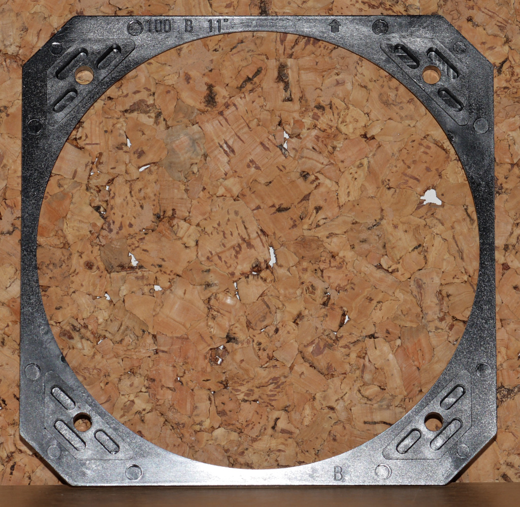

did you check that the lens spacer are set correctly (should be 11° setting for ceiling or floor front)? Also that the spacers are correct for your screen size (in most cases that would be the 100" spacers).

here's a picture of one of the spacers. This one fits blue or red 100", 11°. For red you have to flip it.

Ah ok, I didn't even know it had spacers, they are different than the spacers on my Nec 9pg xtra. The spacer is not at all what I should have, it is for a 200" screen, and I have more like a 60" screen.

According to the manual the 100" spacers wouldn't be ideal either (they are for 75"-130" screens).
60" spacers may be very hard to come by though, so maybe Doug knows how close 100" spacers would get you (they are more readily available).
See attached document for exact spacers needed.
100"/11° needs 2x B + 1x 1
60"/11° needs 2x A + 1x D
your 200" spacers should be 2x C + 1x F (11°) or 3x I (0°)
