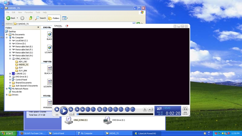

Posted: Fri Jan 11, 2008 7:47 pm    Post subject: HOLY CRAP IT WORKS
AnalogRocks: IT WORKS IT WORKS IT WORKS..kind of.
I wanted to give it another shot, so I reinstalled my OS and installed all of the video drivers, the 3319a version of PowerDVD (thanks for the link) and also installed the UDF 2.5. After that I hooked my 360 hddvd drive up and I was prompted to find a driver. I let Windows look and was told that the driver I had was the best and the hddvd drive was shown as"Unknown USB device". This was a 2 this morning so I shut it off and went to bed. Today at lunch I turned the pc back on and Windows said that I needed to download some updates. Kind of odd because I ran the updated until it told me that I no more updates. So I installed the updates then rebooted. After it came back on my 360 drive was found and I could read the file structure. So I installed AnyDVD HD and the drive was found and the disc was scanned. I then assigned PowerDVD to the .evo files and it started to play back on the 360 drive. Success!!!Before PowerDVD would not work so that is great. Then I decided to try the LG drive and to my utter amazement...it worked!!!!The play back is horrible and it skipps around very bad, but it works. No adapter, no SATA PCI card, nothing. The hardware has not changed one bit, only the software. I can't believe that it actually works. I did try to get a print screen of it but for some reason the actual movie image would not take. Is that something that was disabled I wonder? Any tips on getting the playback to work right?[/img]

Posted: Fri Jan 11, 2008 7:53 pm    Post subject:
Here is the pic
 Filesize:  169.87 KB

joshg21
Joined: 10 Jan 2008
Posts: 25
You can even see that Drive J I think it is, can see the King Kong HD DVD. That is my LG drive.
Dang...seems like a lot of trouble. My drive just worked. Good you got it working though.
