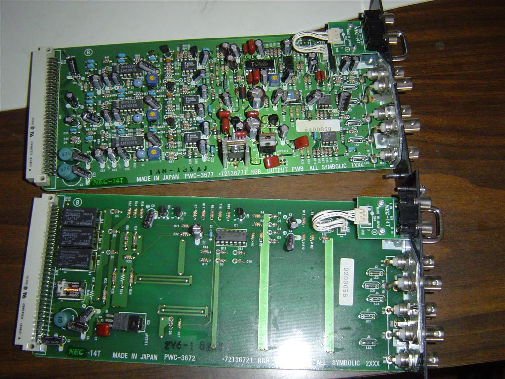

PWC-3672 72136721 RGB Input PWB
A white sticker on the board reads 5300302

Two of the three Output Cards I have are functioning fine. And the third shows no visible signs of bad caps, I haven't tried it, but it was fine last time I used it.
As shown in the pic, the Input card is not passive. Edit: I think the video path is just relays. The active parts are in the audio path and power regulation.
These cards were purchased NOS direct from NEC Australia when they cleared out their pallet of ISS-6020 swichers. They would probably be among the last made.
I haven't heard of any trouble with the batch of switchers/cards - we bought the lot in a group buy.

Oh, yes... that's why I don't worry about the input cards. Does ANYONE actually use the audio???
Bet ya there are at least a few leaking caps on the output card. Look closely at the solder pads around the caps.

Not visibly - I checked again. This card has never really been used - would that matter?
