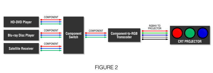

Posted: Thu Jan 03, 2008 5:34 am    Post subject:
Guys,
I hope nobody minds, but I decided to run with this. I need some help from Curt on a projector and I can't afford to spend much money, so I decided to run with the graphics. I decided to try to take them up a notch from the established style (no disrespect for your work whatsoever, Kal - you do an AWESOME job with the web site.)
I'm about half done with them - should be finished in an hour or so... What do you guys think of this sample?
Sample diagram. You likey?

Posted: Thu Jan 03, 2008 6:06 am    Post subject:
People actually call and write you about this stuff? Geez...and they just expect free answers? I don't know how you make a living?
ecrabb... those do look nice, the color adds a nice touch.

Posted: Thu Jan 03, 2008 2:06 pm    Post subject:
Nicely done! One critique though in example 1.
THe typical a/v receiver does not have video and Svideo to component conversion, so you'd also have to have video and Svideo lines running from the scaler to the receiver. I'd change the cable box to read 'non HD cable box', and have it and the DVD player run Svideo lines to the a/v receiver. THen run a video and Svideo line from the a/v receiver to the scaler.
Also, Figure 3: I'd add 'HDMI card installed in projector'.\
Example 1,2,3,4: Have the DVD player read 'non hi def DVD player' since the older scalers can only process a 480i component signal.
Example 6: The RGBHV a/b switch isn't labelled.

Posted: Thu Jan 03, 2008 3:45 pm    Post subject:
Very nice SC! I was hoping you'd take this on as I've always liked your graphics work. I'm the first to admit I am *NOT* a graphics designer. I just know what I like when I see it... Smile
Let me know when the document's done and I'll move it to the site as HTML ...

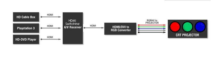

Posted: Thu Jan 03, 2008 7:35 pm    Post subject:
With so many new AV Receivers supporting HDMI switching, you might want to add an example like this.
