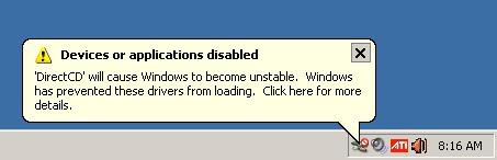

Post UDF driver install-initiated reboot presented the following Windows warning:
 Filesize:  12.1 KB

Ok, I uninstalled the UDF driver that someone posted in this thread, rebooted, searched the Internet, found another UDF 2.5 and installed it and could now navigate the filesystem of the HD DVD and Blu-ray disks. I then tried to Autoplay directly from My Computer, but that did not get a response (Movie Titles were seen).

Sorry to bump this old topic, but I am having the same problem. I've tried the UDF 2.5 driver someone posted on this thread but it didn't work. Windows disabled it saying it will 'cause Windows to become unstable'. But you said you found a different version that worked -
Please could you find it again. I've searched but couldn't find a working one. I just need to pass this step and I believe the drive will finally work!
