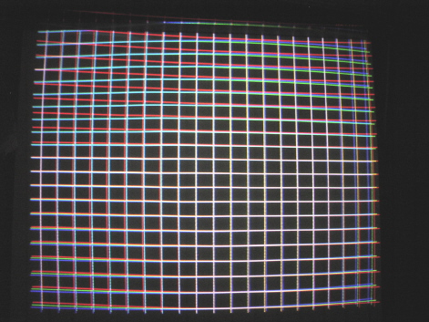

Here is the picture of what it looks like when it is screwed up. All the controlls work when it is like this except the upper red controls. I have no size,height ,linearity,bow,keystone of the upper red in the horizontal plane Vertical key and bow still work.

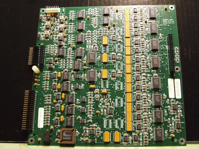

Attached is pic of function summer bd. The right side board in the registration assy. If your projector is an "X" version there should be a daughter bd attached for the green functions. You can try changing it with a spare and see if anything is different as far as the top pincusion is concerned. You can install without the green daughter bd attached but you will get I2C errors. Turn these off, with projector off, with switch 5 on the CPU card. Check the part number of the IC in the socket for a match between the different bds. Try first without changing it if they are different.
Scott

I tried swapping that board the last time it done this. It did not help. The only one of them that I have now is in the spare 4600 which is behind the last row and behind the Christmas tree. so swapping that will have to wait till after Christmas.
