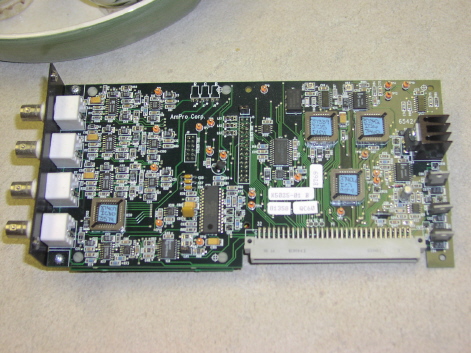

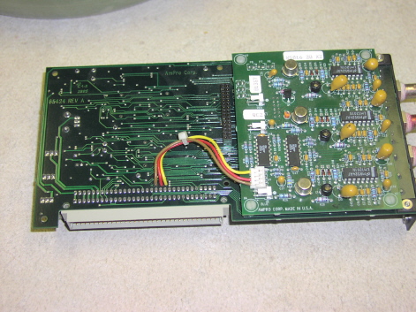

OK I have swapped in other RGB boards and it will cycle through. They will not work but the CPU is trying. This makes me believe that the RGB board is keeping it from starting. When i do get a picture from it,it is not as bright as it was a few days ago. This leads me to believe something is failing on this board.
I think I need a new RGB board. The problem is, I think this board was ONLY used in the 2600 with the daughter board on the back.
The part numbers are 81358 for the main board and 81357 for the daughter board. The main un-stuffed board is 65424 REV A(same as the 3600 and 4600),the daughter board does not have an un-stuffed number on it.
Here are pics.
 Filesize:  111.35 KB
 Viewed:  7912 Time(s)
 Filesize:  113.23 KB
I do love my AmPro's
Posted: Wed Dec 12, 2007 12:32 am    Post subject:
So are you saying you were able to get it to initialize fully with a different RGB board. That daughter board as you refer to is the Gamma correction board which was optional on some boards. Naturally you cant remove it from that RGB board because the basic board doesn't have the connectors for the video out, however you can use a regular RGB board without the Gamma correction board out of a 3300, 3600, 4300 or 4600. They will work just the same.

Posted: Thu Dec 13, 2007 1:52 am    Post subject:
The RGB bd will have to be a 36, 4600 type with the daughter bd and correct programmable chips to work right. Because the RGB bd is hanging up the CPU it sounds like there is a problem with one of the programmable chips that ties right to the processor. You might be able to pull, one at a time, the programmable chips from the original RGB card and see if that lets it boot up. Use the right chip puller or the sockets break real easy. This time of year antistatic procedures are important.
