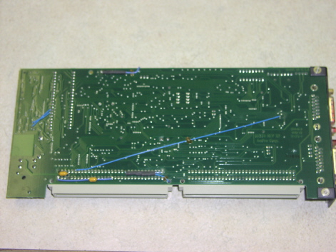

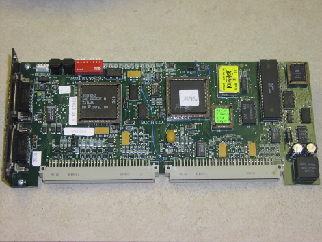

Ampro part number for the board is. 881404 This a new style CPU like the 3600 and 4600. The board itself is a 65334 REV X2
 Filesize:  82.46 KB
 Viewed:  9385 Time(s)
 Filesize:  107.3 KB
