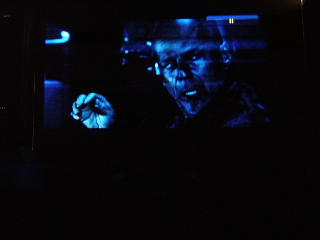

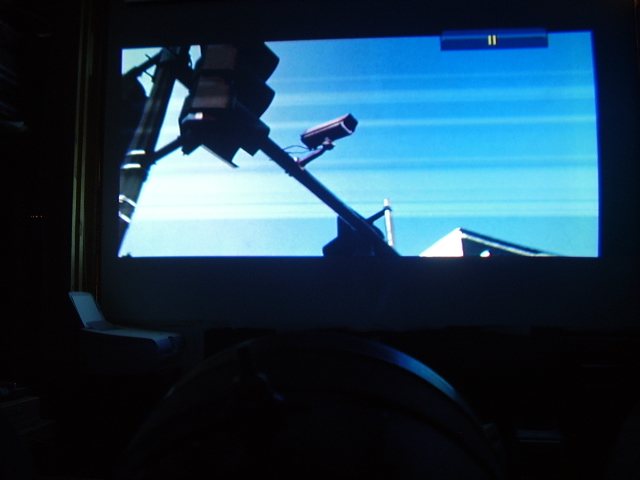

After watching a few movies on it with the kids I have come to the conclusion that it is not streaking but stripes that run right to left and of a slightly darker shad than what should be there. More like Noise that moves with the image and can be affected by the brightness or darkness of the image. And are affected by any object that enters stage right. or when the image pans up or down. So any ideas? I will try to capture an image of it to post.

Here are a few screen shots keep in mind that the camera really screwed up the color and exposure but the stripes in the image are what I wanted you to see not the bad photography and total lack of color calibration.
 Filesize:  144.33 KB
 Viewed:  7683 Time(s)
 Filesize:  141.31 KB

I have seen this caused by line mismatch/termination issues. I had a coby progressive dvd player that looked good on any other RGBHV display but on NONE of the NEC's. The projectors just refused to get along with it. Never figured it out since I moved on to 1080i long ago.
May try to insert inline terminators and see what it does. Odd that it's on a fury, though. Try a 5 volt powersupply with it?

I think your looking at the wrong board (Osc) ?. The test- norm switch is tiny and will be under the wire connector but look on the decal for test-norm AKB SW at the video out board. Doug
Streaking:
Is this on all three colors the same?

I will look for the switch in a min. YES it is on all three colors.
