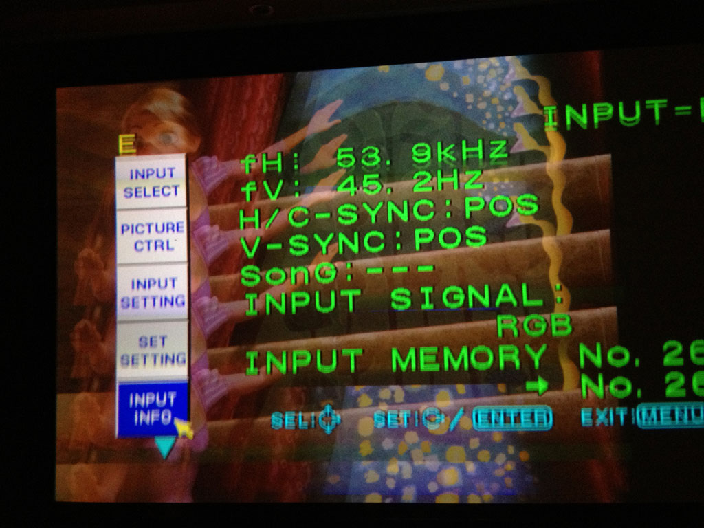

Posted: Tue Mar 20, 2012 3:08 pm    Post subject:
Today IFB-v3 card was installed to Sony G70. The 2D image is just fine, but the 3D image is continuously shifting vertically.
I have no ideas what's wrong. I guess this can be a sync problem and I tried with the supplied remote pressing "D" & "Display" keys, but it doesn't help. The manual says "(step 6) ... the projector should be synced", but what this means and why this process is needed? How can I sync the PJ?
Of course, 1080p24 display option of the player is set "off", and I used high-speed HDMI cable (display output directly connected to the PJ). Also The PJ was set as the input: RGB and input clamp: H/C.
Tested source players: Sony PS3 & Oppo BDP-95 /Disc: Tangled Blu-Ray 3D
Any comments will be appreciated.

Posted: Wed Mar 21, 2012 8:10 am    Post subject:
No, you need a scaler and use 720p @ 100 or 120hz for 3D. You can't use 1080p for 3D cause moome max refresh is 75 Hz and however crt does not have enough bandwidth.

Posted: Wed Mar 21, 2012 3:58 pm    Post subject:
Oops! I was so excited to hear that the old CRT PJ can display 3D images. But this can not be done with IFB-v3 card alone. I missed a crucial information that the CRT PJ requires a video processor such as Lumagen Radiance 3D series for capable of 3D display. Another frustration... but there is still a chance!
