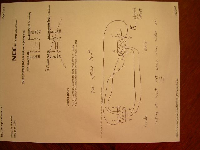

Posted: Thu Nov 22, 2007 9:10 pm    Post subject:
I've been thinking about your communication problem and just thought I'd post this pic so you could verify your pin placement. I know I was confused when I first did mine and it did not work properly. I had to redo it.I pulled my wire and verified this is the proper location and mine works fully, however mine is not on the incompatible list. Hope it helps.

Posted: Fri Nov 23, 2007 1:54 am    Post subject:
Thanks for the picture and your time to post it. I just rechecked my connections and mine is just like your pic. I was bidding on a remote until Curt outbid me. There is a member that a I am going to get one off of. once again thanks.
