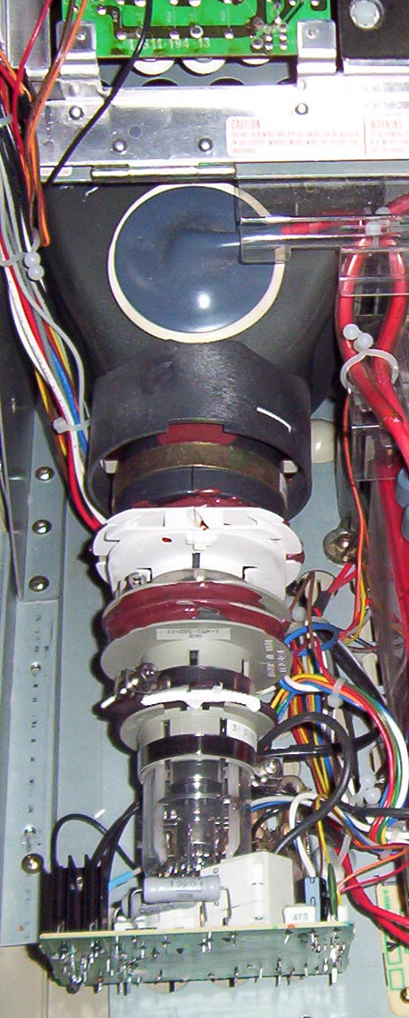

it's not as clear as it would be if it was a TV.... sorry.
Which one is the one I'm going to turn? There's a few rings and stuff sealed with the glue, as you can see. Care to circle the correct one? Smile

The one you need is all of the way to the front (right next to the bell) The big white part and the coil and magnet ahead of it will all turn as one unit. You need to loosen the radiator style clamp on the big white part, and then there is two-sided tape underneath, where you can't seem it. At the end of the tube, near the neck board that plugs in to the back side, the tabs with the white stuss are for astigmatism adjustment. This controls the shape of the dots produced by the tube, which should be round, and you shouldn't have to mess with that. The coil in between is the convergance yoke, and turning this shouldn't have much affect on the image, certainly not worth messing with it. When yo go to adjust the deflection yoke (near the bell), you want something non-conductive that you can use to turn this by the white plastic part. Just make sure that once you habe this loosened, get the PJ nice and warm, so that it will be easier to move (not so jerky) Once you get to doing it, it's pretty easy. The hardest part is geting ready for the adjustment, especially with this being your first time. You may feel like getting creative in finding a way to move the yoke during adjustment, just make sure to do all of your playing before plugging it back in.

I watched family guy for a good while, to get the tubes nice and warm, and loosened B and R yoke clamps. I rotated blue to match the green horizontally. (I would turn the PJ off and then rotate the yoke, and turn it back on again, took me about 4 power cycles) That plastic collar at the top will rotate the yoke, so I had a heavy finger on the red, rotating it niggle by niggle when I brushed my pinky against one of those damn posts near the focus pack, and god damn was that a surprise. The bitch bit me! Sad Sad Sad Sad Sad I now have a tiny blister on my right pinky. I'm quite grateful it didn't do more.. but I got blue and red registered to green horizontally.
