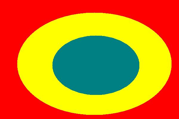

What would cause sloppy convergence around the edges in an RPTV? I did the centre and then the multipoint convergence adjustment on my parents' Toshiba... and whilst the centre is dead on, the corners are slightly blurred. Even though the crosses are spot-on, I still notice colour separation, similar to the attached graphic. Red = slight misconvergence/defocus, yellow = barely noticeable, green = ok.
Could the edge-defocusing be the first sign of aging glycol? The picture has become red-biased, but NOthing like my grandma's was. The odd thing is.. I'll do the multipoint, and the crosses are RIGHT on top of each other, with no colour bleeding on the edges.
In the multipoint menu it has the numbers, 1-9, around the edges, you know? Well, the number is overlaid on a white box. Even after adjusting that point dead-on, when you exit back to the 1-9 screen, the white is misconverged. I'll have to take a pic and show you.
not accurate, but a depiction
