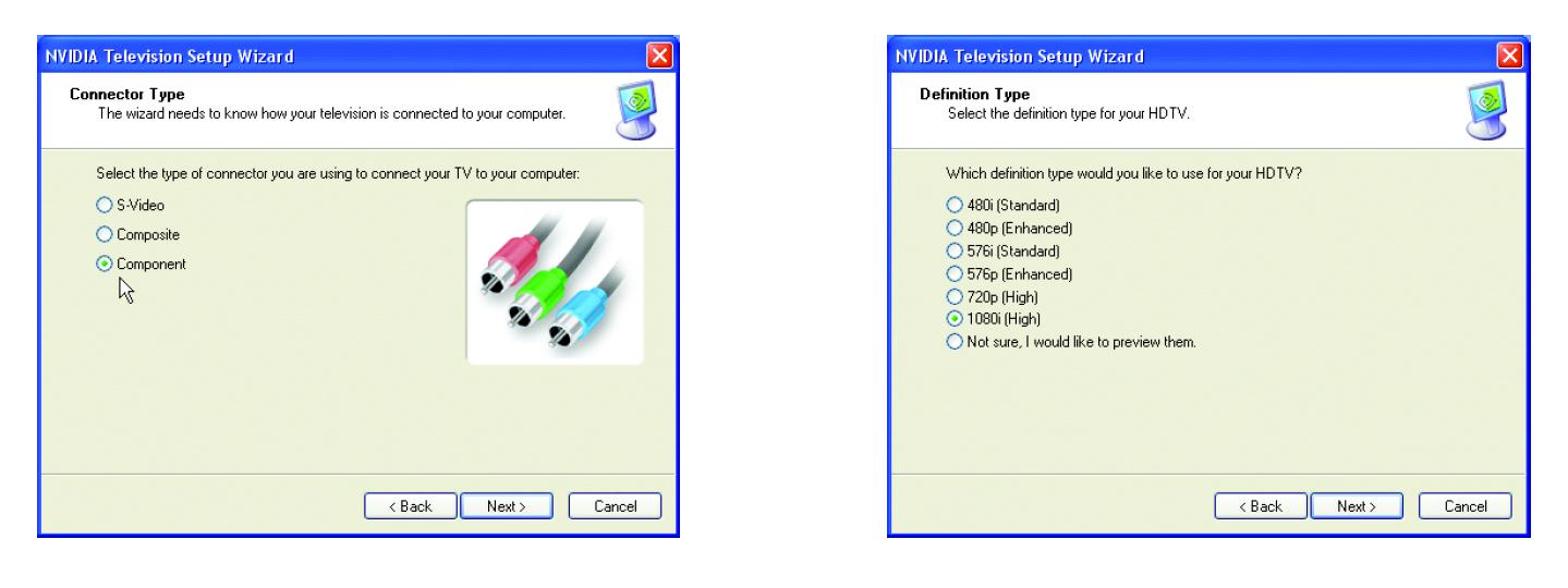

i read oliverqs post on avs.. its merely a seeking of opinions.. whats wrong with that? i don't think the people that answer will be chums... that link oliverq provided arent friends of his... did you even read the post he linked... i just did a google on this and there are 100s of entries about people with hdcp enabled cards that cant do 1080P via analog...
terry you mentioned that your friends can do 1080p with those cards but can you confirm that they do it with VGA or component? my 8800gt doesnt work either and if theres a way to do it then please post here about how it was done? heres a screenshot
Stop playing with the TV wizard thingy and just set 1920x1080 as the desktop res, preferrably at 48/72hz (or 96i, that's quite nice, if you can get custom res's to work).

i think i have a theory why my vga doesn't work and it turns out that its not the card..
component doesnt work at all but vga also doesnt work but i think thats because the display im using doesnt accept 1080p from vga....... im not using the wizard either ... that was just to illustrate the option was lacking
my black pearl does 1080p happily through dvi but not vga... i just checked... i think it may be the displays not accepting 1080p.. oliverq what display are you using your htpc with right now? i dont recognise the model in your profile
