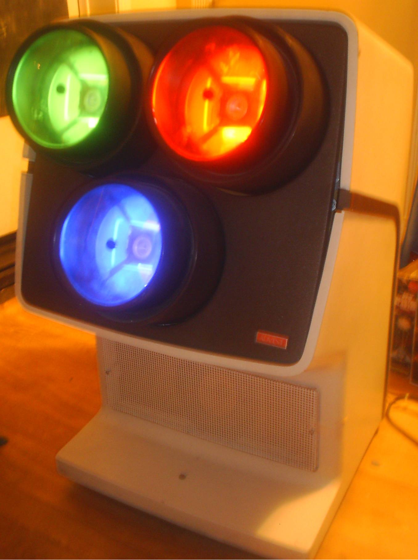

Posted: Sat May 03, 2008 11:55 pm    Post subject: Found a Advent 1000A!
Got ahold of a working advent 1000A with original screen!
Thumbs Up
The unit works great but needs a little more convergence. The projector has an instant on feature and I use a seperate power switch directly cutting all A.C. to avoid premature CRT wear and failure.
I have sucessfully duplicated the screen surface using a flat, ultra white paint with right amount of reflective properties for gain since original silver surface isn't washable or servicable, the advantage of white screen is that it is viewable at nearly any angle similiar to a regular TV screen. Unit has had all accumalated dust removed inside with a vacuum. I'm impressed how well PJ was made, two cooling fans help keep unit cool. Several hundered viewing hours have already been put on it--- no problem. I have made a space saving design by storing screen suspended by chandelier chains near top of ceiling so it's out of sight when not used.
There are no parts available for PJ, I have gone through the effort to get a parts Vid 1000 that was broken down for PCB , CRTs. I plan on using this for as long as possible as no others or few survive. many of these have been scapped in the last few years.
I know this is really outdated, BUT the resolution is full NTSC and very watchable since CRT based. It took years for digital plastic boxes to catch up in picture quality. I own a proxima 9310 for family viewing, it's great until you have to shell out $250 bucks just for a light bulb, some bulbs are double that almost. I'm kinda amazed no one saves these for an extra tv, family room, as spare set. Seven foot size screen makes unit feel like still a home theatre unit. Clever acoustic properties of screen bounces sound back to you.I'm posting this as most advent history web sites don't even have a pic of the videobeam. Anyone can use or post these pics as they wish anywhere for advent company or other history info.

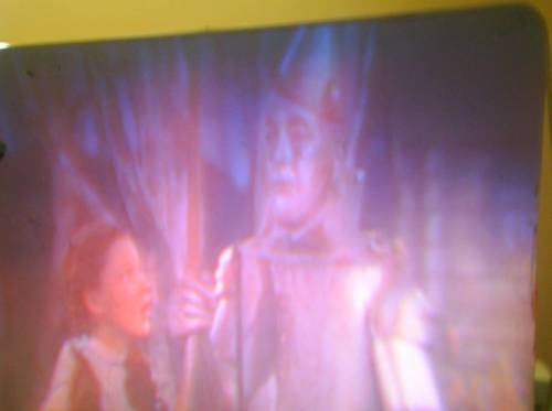

Posted: Tue Nov 18, 2008 8:45 am    Post subject: Still a work in progress
Hello everyone,
I'm also advent videobeam here in this forum as passwords aren't easily retreived by email.
MY R2-D2 unit is still in shop for repairs. The wiz of OZ pics are shown display poor convergence and focus as circuits are out of whack.
I have found a super high gain screen material to maximize picture output. I will post some awesome photos showing what a properly dialed in unit can do.
I have extensive tech info from company brochures. Here's some FACTS, 1000 has comb filter to elininate noise from picture signal. TRUE full NTSC color demodulation for accurate color. Resolution up to 1000 lines instead of 520, higher than NTSC TV. NO shadow mask, full contrast output.

Why's there a black rectangle in the middle of the lens? I've seen this on other older CRTs, but I have no clue to what it is.

Posted: Tue Nov 18, 2008 1:52 pm    Post subject:
I think the black rectangle you are refereing to is the phosphor. The image you see when you look into the lens is a reflection on spherical mirror. The crt & lens is a single intergraded unit.

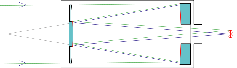

Posted: Tue Nov 18, 2008 3:33 pm    Post subject:
That's a Schmidt corrector plate Smile
It's used in Schmidt optics or Schmidt-Cassegrain telescopes
http://en.wikipedia.org/wiki/Schmidt_corrector_plate
http://en.wikipedia.org/wiki/Schmidt-Cassegrain_telescope
The CRT tube would be the red "x" in the attached diagram
