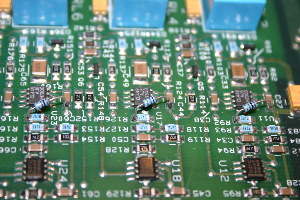

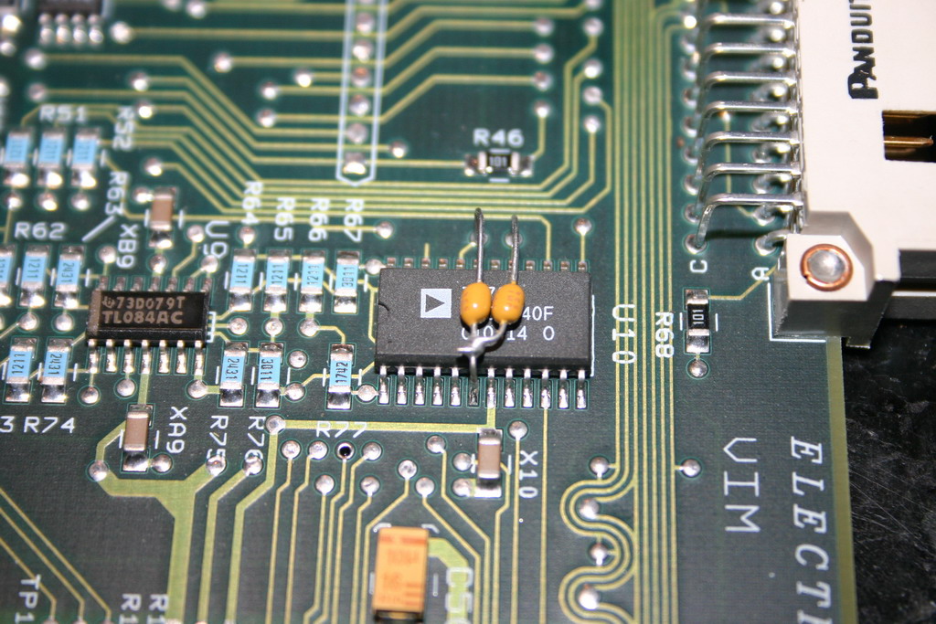

Posted: Fri Sep 28, 2007 8:55 am    Post subject:
Anyone know if thees are after market mods/field mods or OEM and that's just the way they are?
Sorry I forgot to mark them - the three resistors and the two brown caps with the twist in the second photo
 Filesize:  236.78 KB
 Viewed:  2847 Time(s)
 Filesize:  241.37 KB
Posted: Sat Sep 29, 2007 2:48 pm    Post subject:
That's how all the VIM boards were built at that time. That's normal for the type.
