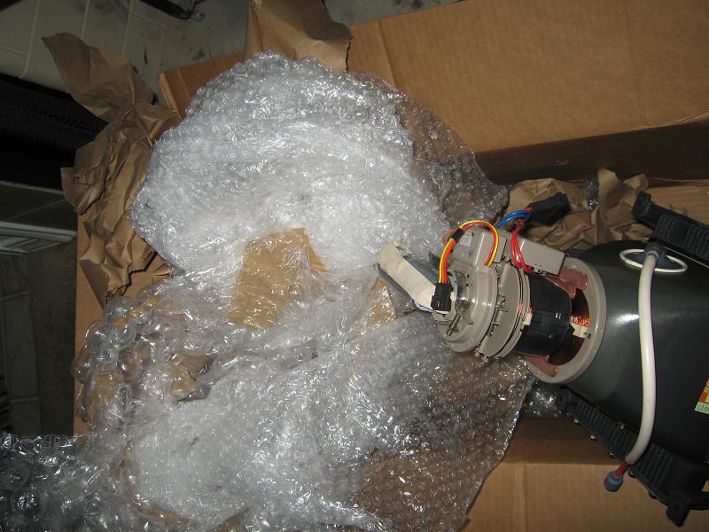

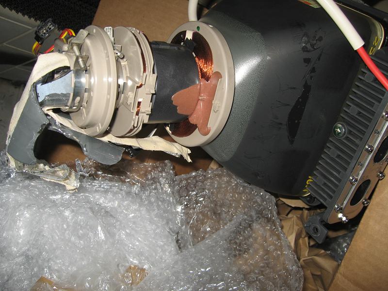

Okay, I just peeled off the zillion layers of bubble wrap from the tube neck and confirmed that the tube neck did not crack.
The tube neck disspeared. No really, it's not there anymore. Laughing GONE!
There are a zillion little glass shards all over the place though. I wonder where they came from?

Can you snap a picture, I really would like to know what it looks like.
TIA,
Erik

Posted: Sat Sep 22, 2007 3:29 pm    Post subject:
Tube "neck" by request.
 Filesize:  91.84 KB
 Viewed:  7429 Time(s)
 Filesize:  89.55 KB

I've seen and done this. You need to snap the neck suddenly with a shear impact. That pix is of a snapped tube neck.
YOU can try it.
