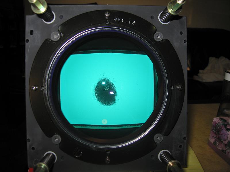

Speaking of tubes, I just had my first one ever break. I've mailed out a couple dozen over the last two years to places as far off as Hong Kong, but this time FedEx killed one going to California of all places. Sad
I had the seller mail the tube back to me so I could cross reference the serial number against what I mailed him to make sure he wasn't a scammer (I wasnt' familiar with his name) and just got it back today. It was the one I sent him, so I issued the full paypal refund a few minutes ago. Well, including one-way shipping only.
Nice job, huh----->

How was this caused by shipping? Looks like spot burn to me. I dont know much about that chassis though and what connects can be left off to cause this. I have had necks break but not contaminate face phosphor. Bummer either way. Doug

Posted: Fri Sep 21, 2007 12:31 am    Post subject:
I'm with Doug. Man, that looks like a crater burned into the faceplate because of no deflection.

Maybe he installed it in his unit after he got it and fried it because his projector has no deflection then said he got it that way to get a refund. ?????????? Sad

I think it could have been shipping damage; looks a lot like the tubes in the dropped 9500

Although the tube CZ sent out does have a small ring in the center; is this what you guys are guessing off of, you all know more than I do about these sorts of things
Posted: Fri Sep 21, 2007 1:26 am    Post subject:
Man, I still don't see how dropping could cause that even your pic Zebu Fellenz. Your's looks like spot burn also. How do you know for sure a drop caused it? Did you drop it and see it happen? I'm surprised.

Posted: Fri Sep 21, 2007 1:36 am    Post subject:
Hmm, I've never seen spot burn that big before. If thats what it is, then I guess I'm screwed and the buyer is happy. Oh well. Or is that Oh hell. doh!

Curt says he has had tubes damaged like that in shipping so the guy may be telling the truth

Posted: Fri Sep 21, 2007 1:53 am    Post subject:
Guess that sudden loss of vacume must do something to the phosper face. Does look like the same as that dropped 9500.

I can easily see how this happens.. We all know there is a serious vacuum inside any CRT tube. The tube neck breaks, and air rushes in through the remaining neck, which acts almost like a shotgun barrel for any glass debris/etc. The debris are peppered against the phosphor face, causing the damage you see.
Also, if you look closely at the pics, you can see right through the glass on the tube face.. If the phosphor were there and burned, you wouldn't be able to see through it. I would think there would be a more defined pattern, instead of a random peppering that is seen in the pics.
