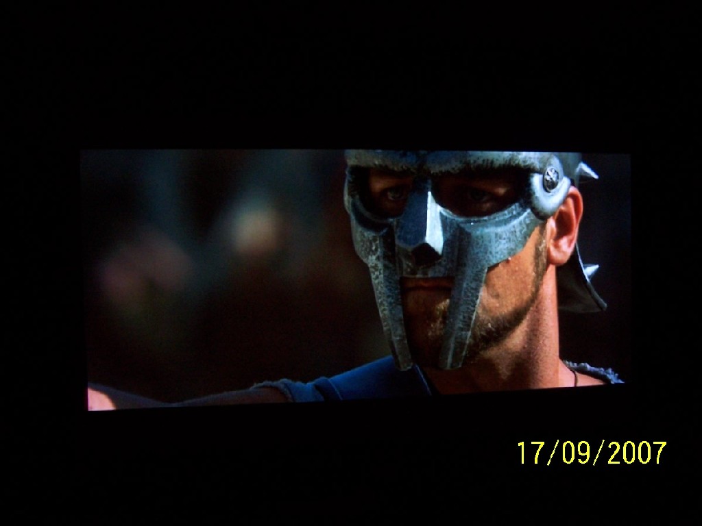

So are we going to do the 12xx "show down" or not? I'll start- My 1251q with about 1100 hours on it running 1080i from a Toshiba HD-A2, projected on to a 102" BOC 16:9 screen. Picture taken from a Panasonic FZ5 with stock "program"settings, camera resting on my knee.
Casino HD-DVD
Not too bad for a $50 projector and a couple hours of set up. Very Happy

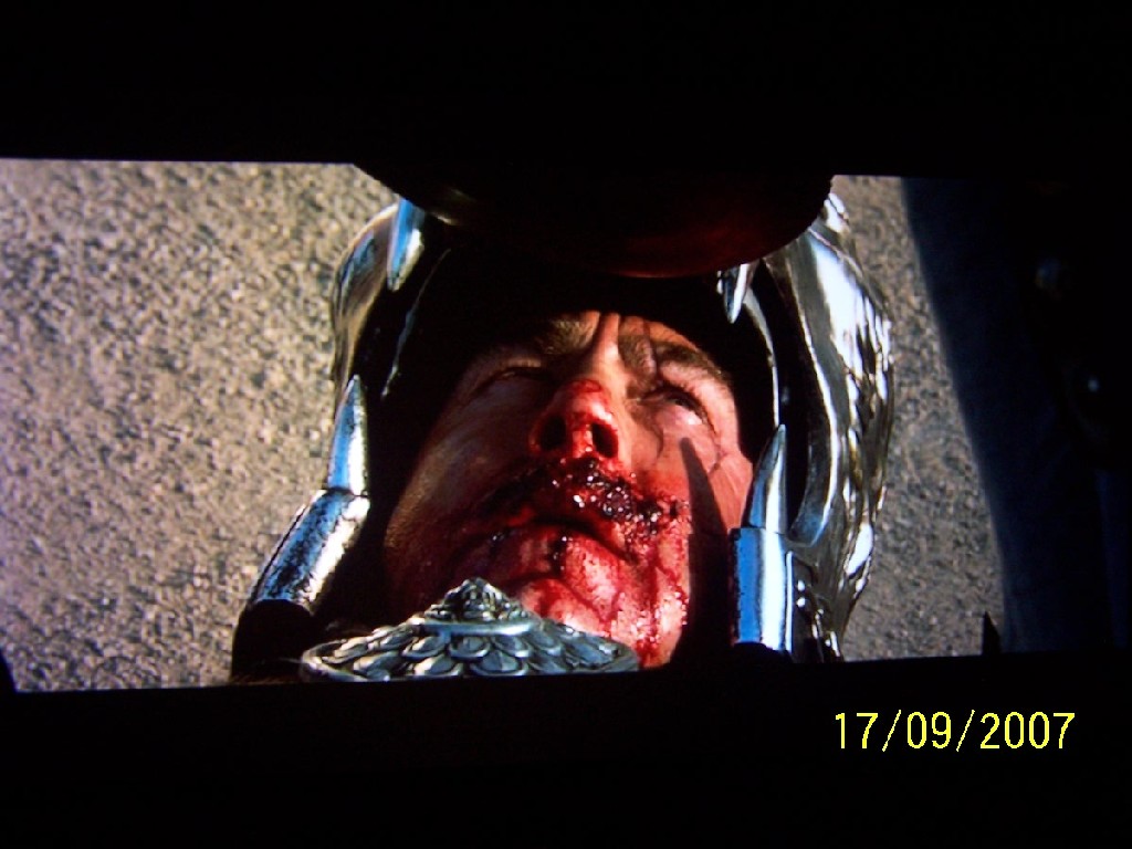

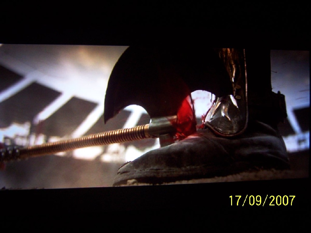

imprez25
Joined: 01 May 2007
Posts: 70
Posted: Tue Sep 18, 2007 12:51 am    Post subject:
Here are some more:
Serenity HD-DVD @1080i
Fith-Element SD-DVD superbit edition @ 480p
300 HD-DVD @1080i

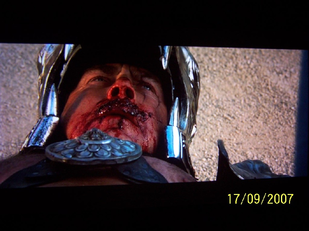

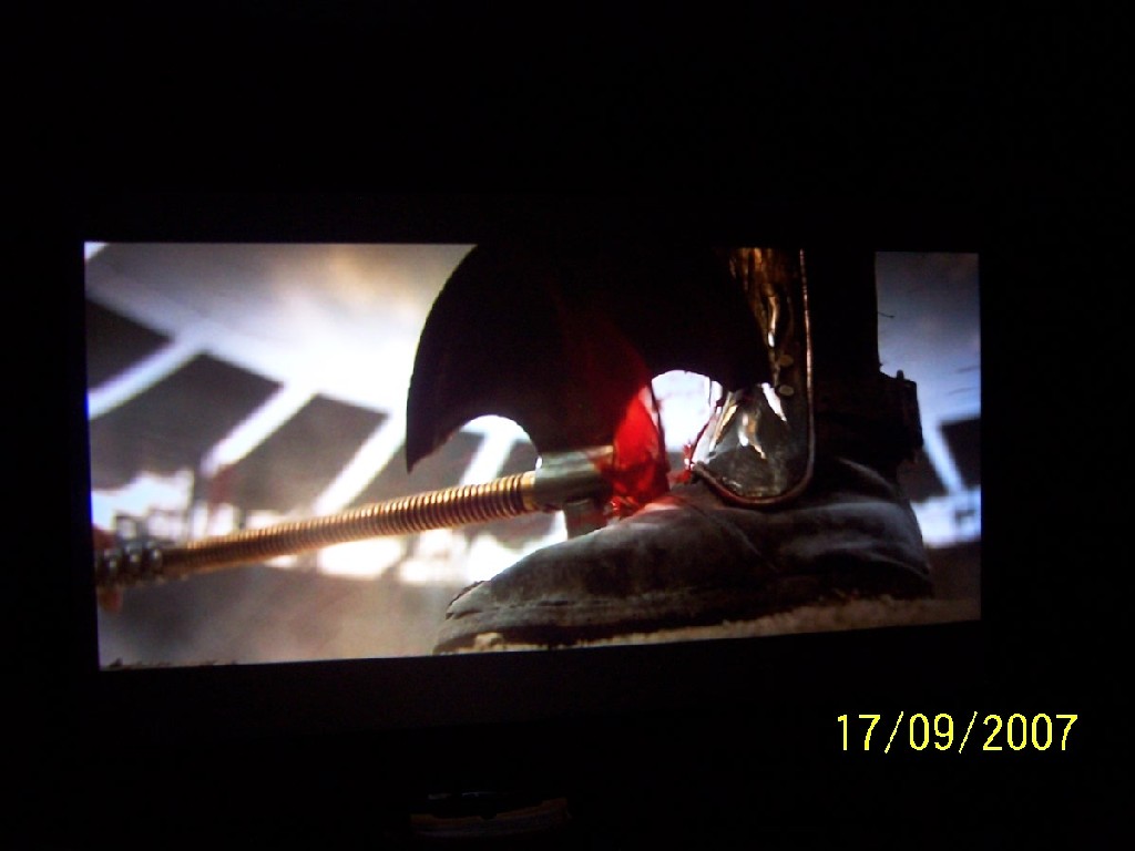

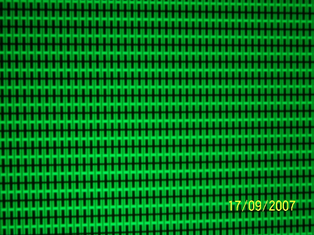

Ok, here I go: These are taken about 7 feet back with a Kodak Easy Share camera. Please don't laugh... BUt, where the HELL are my dots! The h pattern shot is when I had a 480p source, and the 1272 was on registration 1.
I forgot which pics are from what source; I was using a xa2 (hdmi to dvi cable into moome dvi card) for some, and then switched to a pany rp52 with sdi output into a HD leeza and rgbhv into pj.

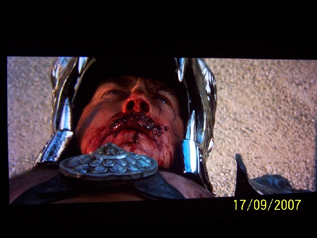

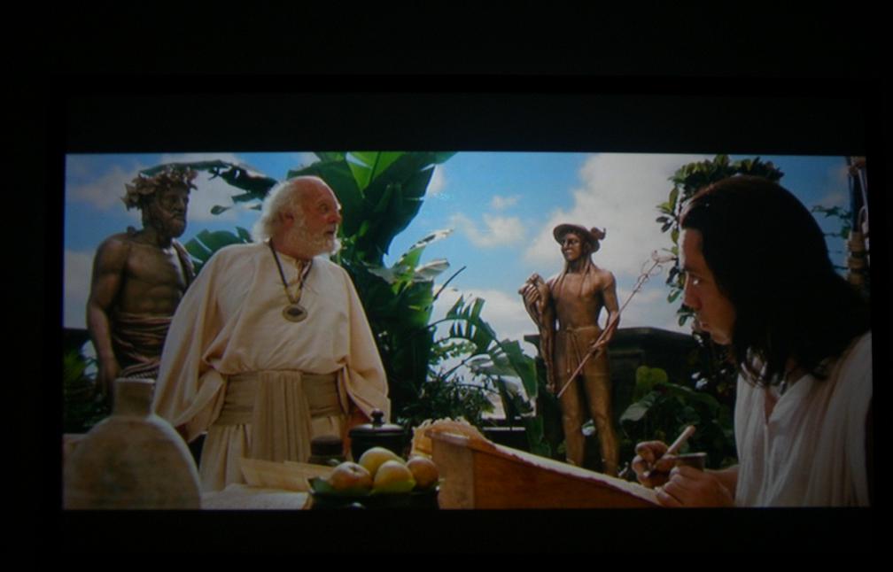

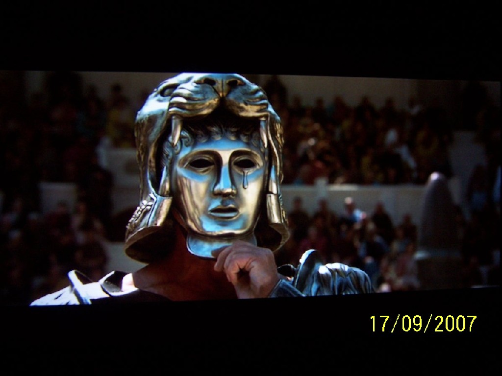

And, some more:

Also, I tried to do the optical focus using the 480p input will the pj was in the #1 registration. Was this a dumb thing to do?
I figured if I could get the optical in the best shape (trying to see the damn dots!!), it would be the same for all other registrations.
Is that wrong??
wallace

Wallace- you're right. Focus will remain constant on each memory block. I've done my focusing under 4:3 480p. It's the only way I have been able to clearly see the dots. At Higher resolutions and 16:9 they are almost impossible to see. I too figure once I get it set at 480p it should be fine for the higher resolutions. Though some tweaking might be required. This is just my novice opinion though.

The optical focus of course will be the same no matter what resolution the projector is at.. Select a low res., set contrast and brightness to 50, do an electronic focus while looking into the lenses at the tube faces(sunglasses help alot here lol), and get your optical focus as best it can be. Then set the electronic focus again(looking back into the lenses) while the contrast setting is where you have it set for viewing for even better results.

Change you name to SonyMaster!!! I tried suggestion and "I saw DOTS!!!" And no, I was not doing anything (smoking or drinking) illegal Shocked
But, I could only get dots on the green tube; and just a little tiny bit on the blue, and I could not get the red to show dots. BTW, I think I am blind now even though I used sun glasses... lol
I think the tubes have had it. I say this because I had a 1270 sitting on the floor that someone gave me about 2 months ago. When I first got it, I pulled the lense off the blue tube and could see a lot of wear; not toast yet. I put the lense back on and left it. Until last night.
I put the 1270 on the table, hooked up the dvd player, had to change the connectors to turn the picture upside down, and within 30 minutes, I had a very sharp H-pattern on all 3 tubes. Convergence was crap, but sharpness was really good.
The 1270 has pt-43 lense, so maybe that help when looking at the screen. But it was very easy to adjust the electronic focus and see dots looking thru the lenses. I could not get that on the 1272.
