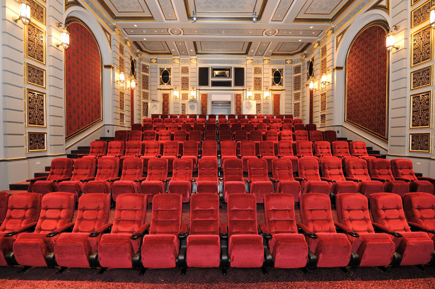

Posted: Sat Jun 26, 2010 3:12 pm    Post subject:
One more time... Smile Smile Smile
 Filesize:  345.99 KB
 Viewed:  10566 Time(s)
I think that is simply beautiful and looking far better than most commercial theater houses I have seen in my life. Especially with regard to the quality of gold touches and detail.
