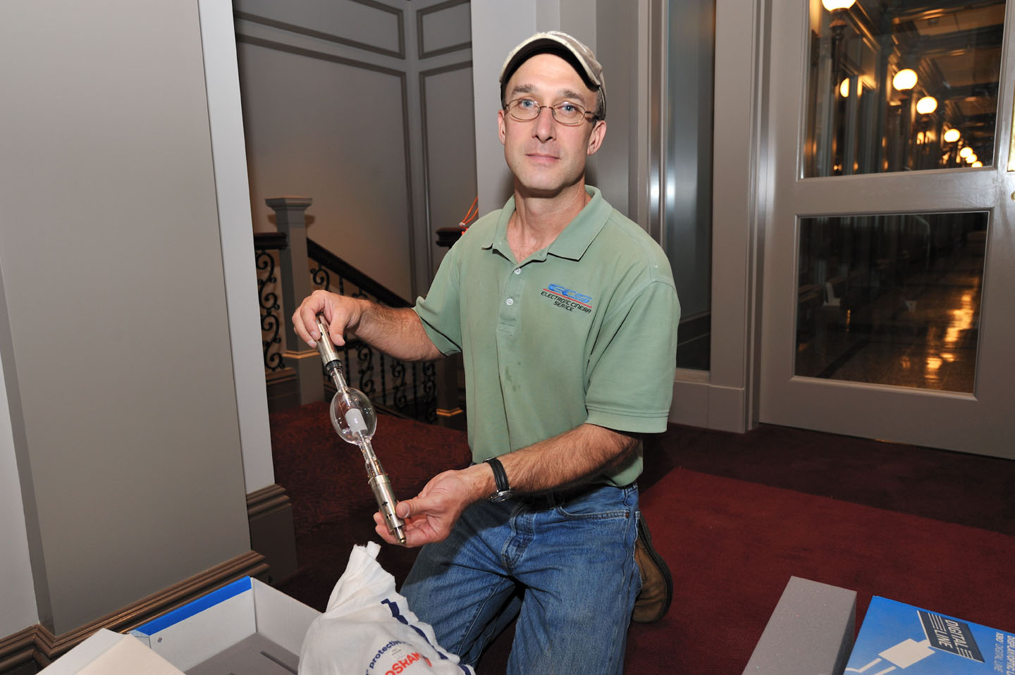

Leo Bassett unboxing the arc lamp in the theater lobby.

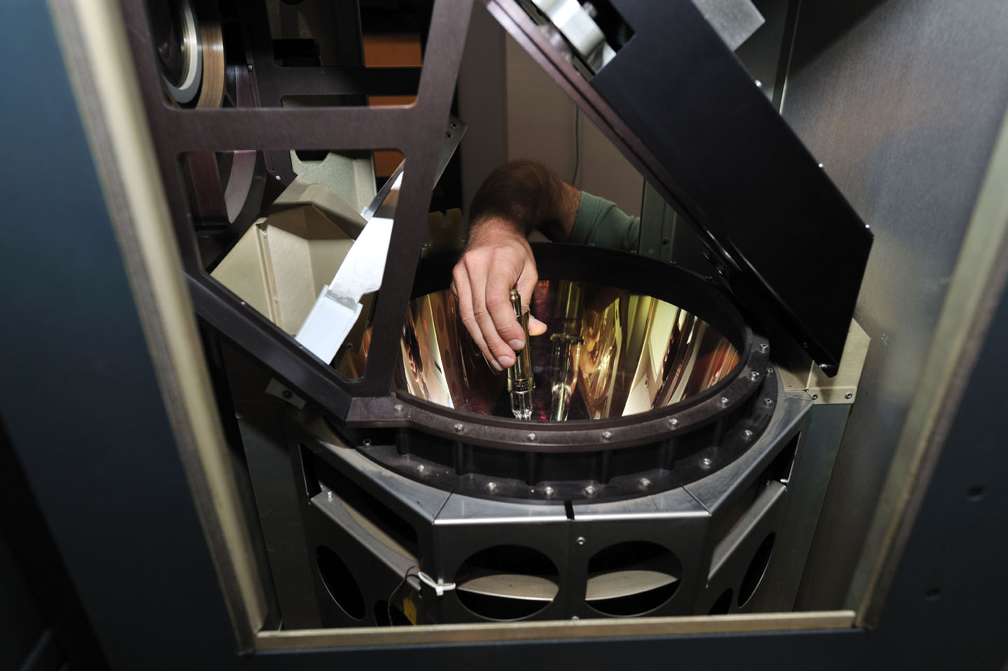

The 6,000 watt arc lamp being installed in the reflector assembly. Note: The projector originally took a 7,000 watt lamp, but has been retrofitted to take a newer 6,000 watt lamp that actually outputs 20 - 25% more light than the original 7,000 watt model

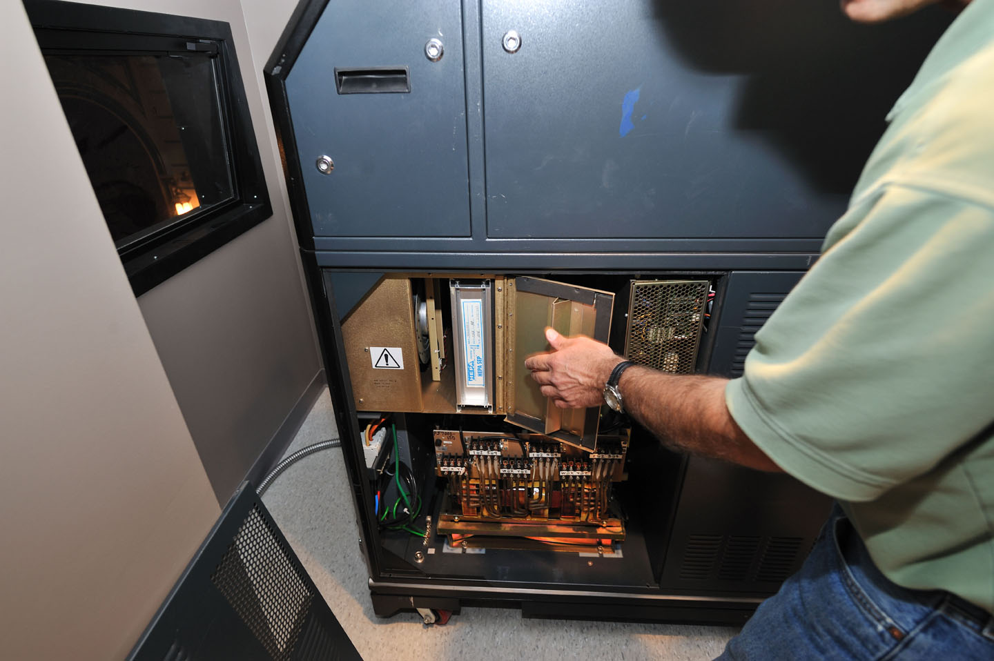

HEPA filter compartment above the arc-lamp power supply.

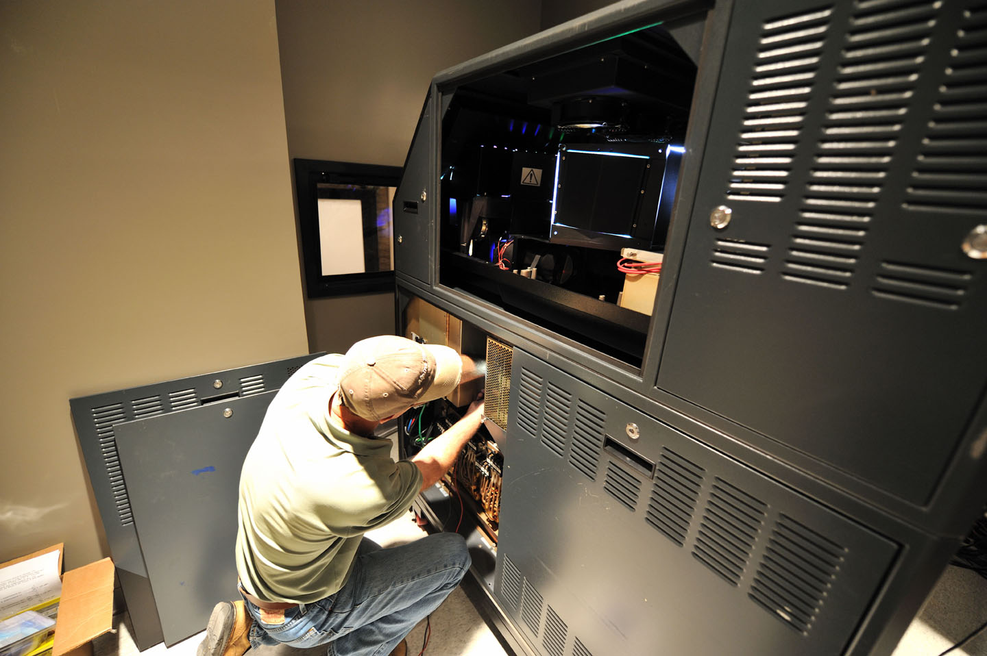

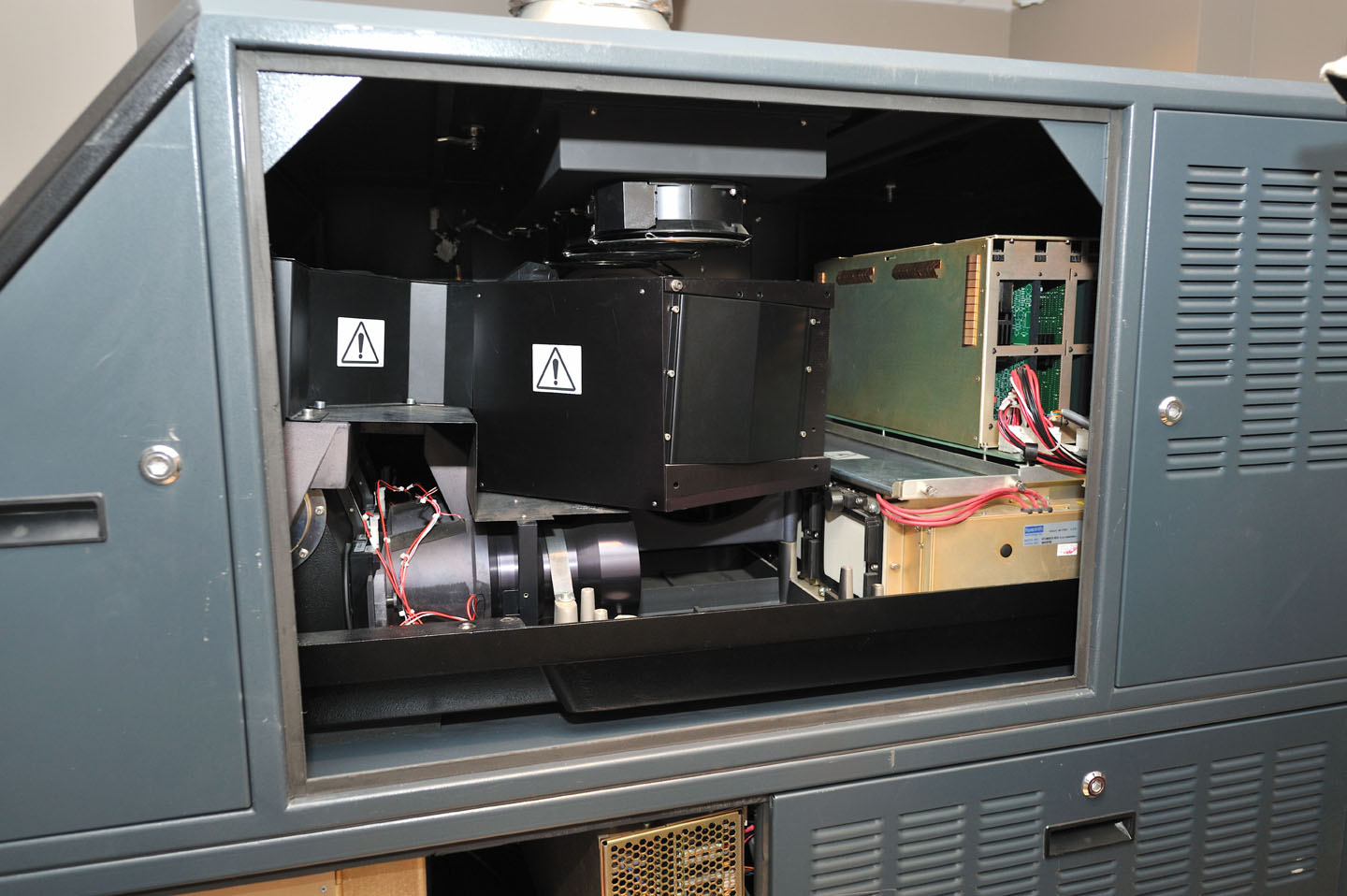

The optical area of the projector. Note the row of infra-red CRT's under the circuit board cage that excite the ILA panels.

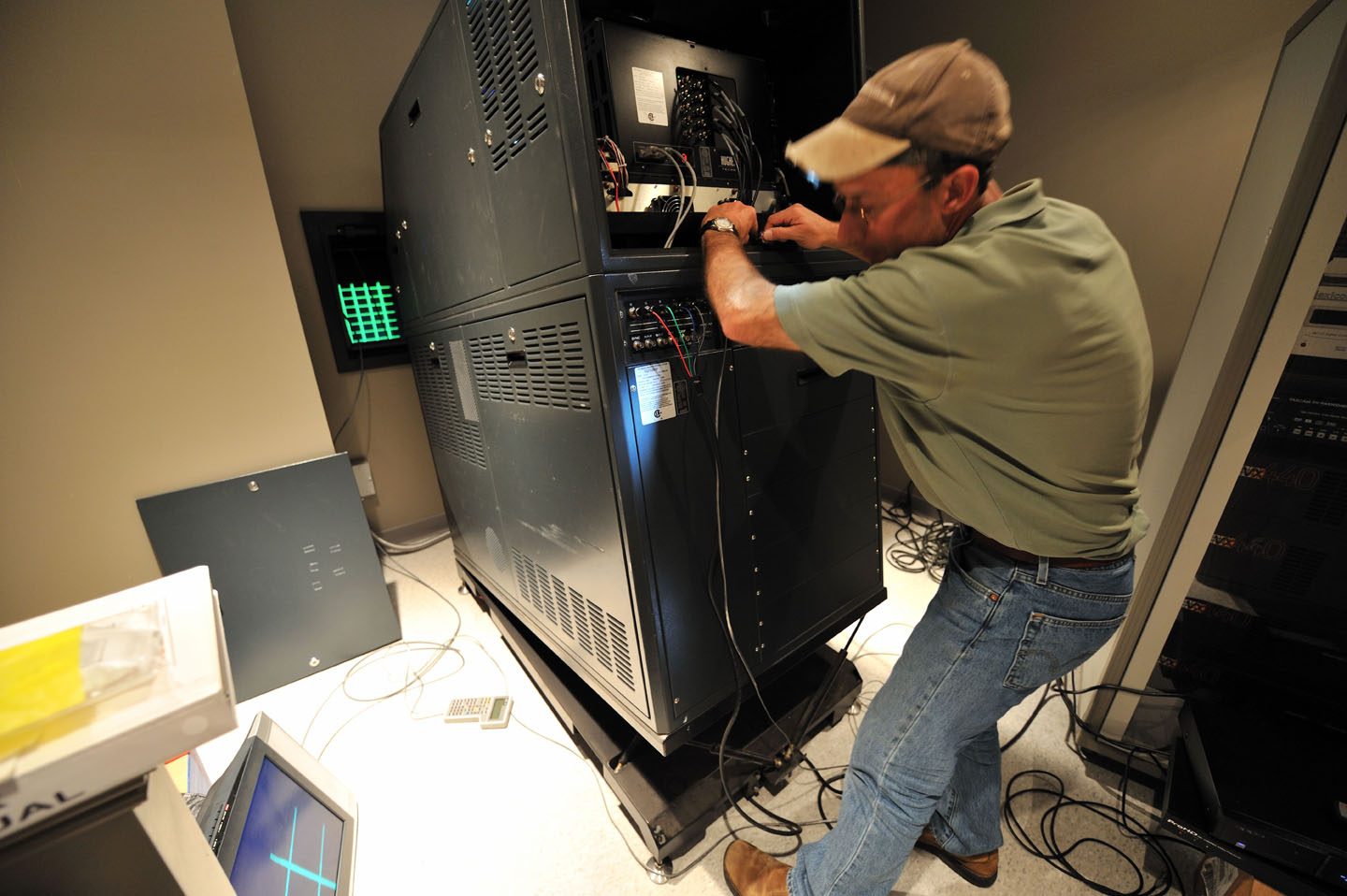

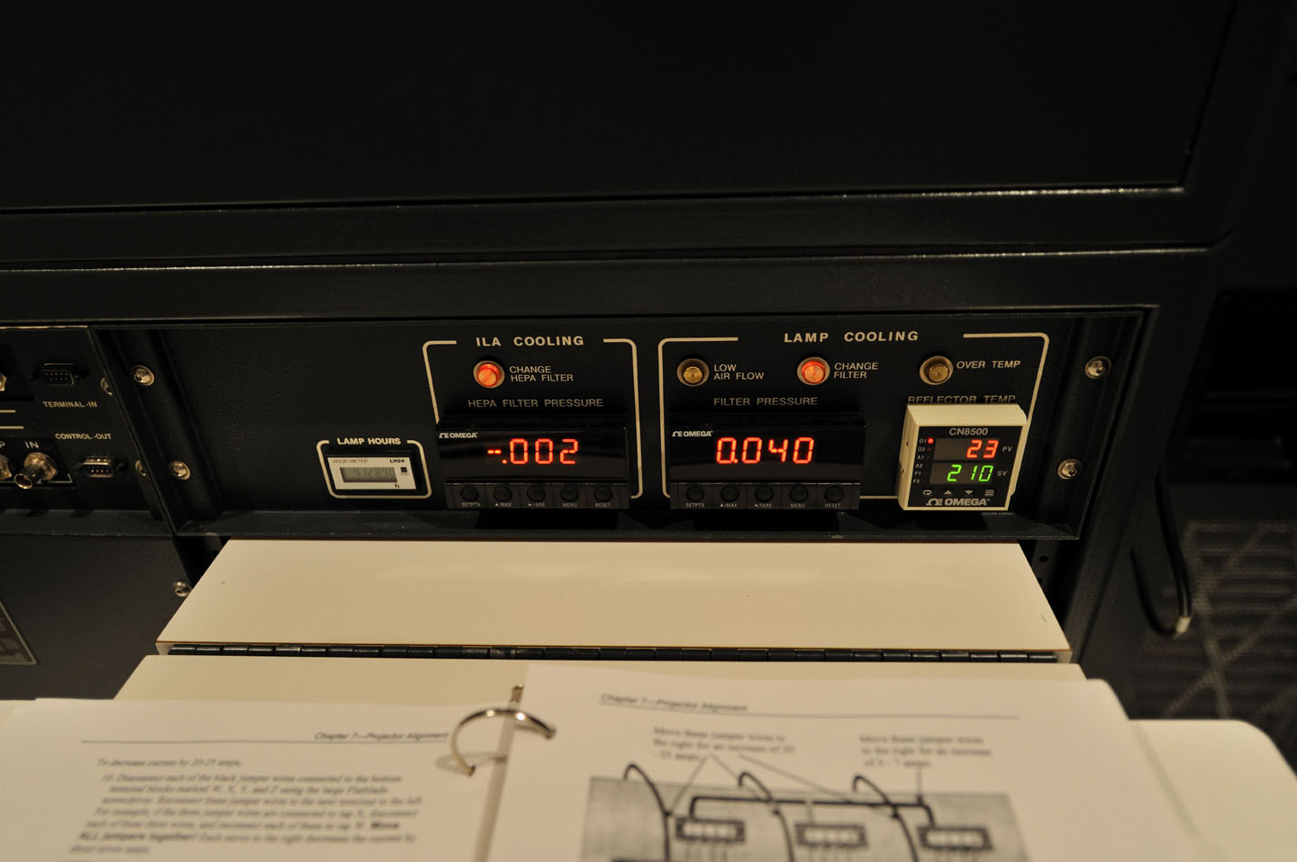

The rear of the projector showing the operational status of the cooling system.

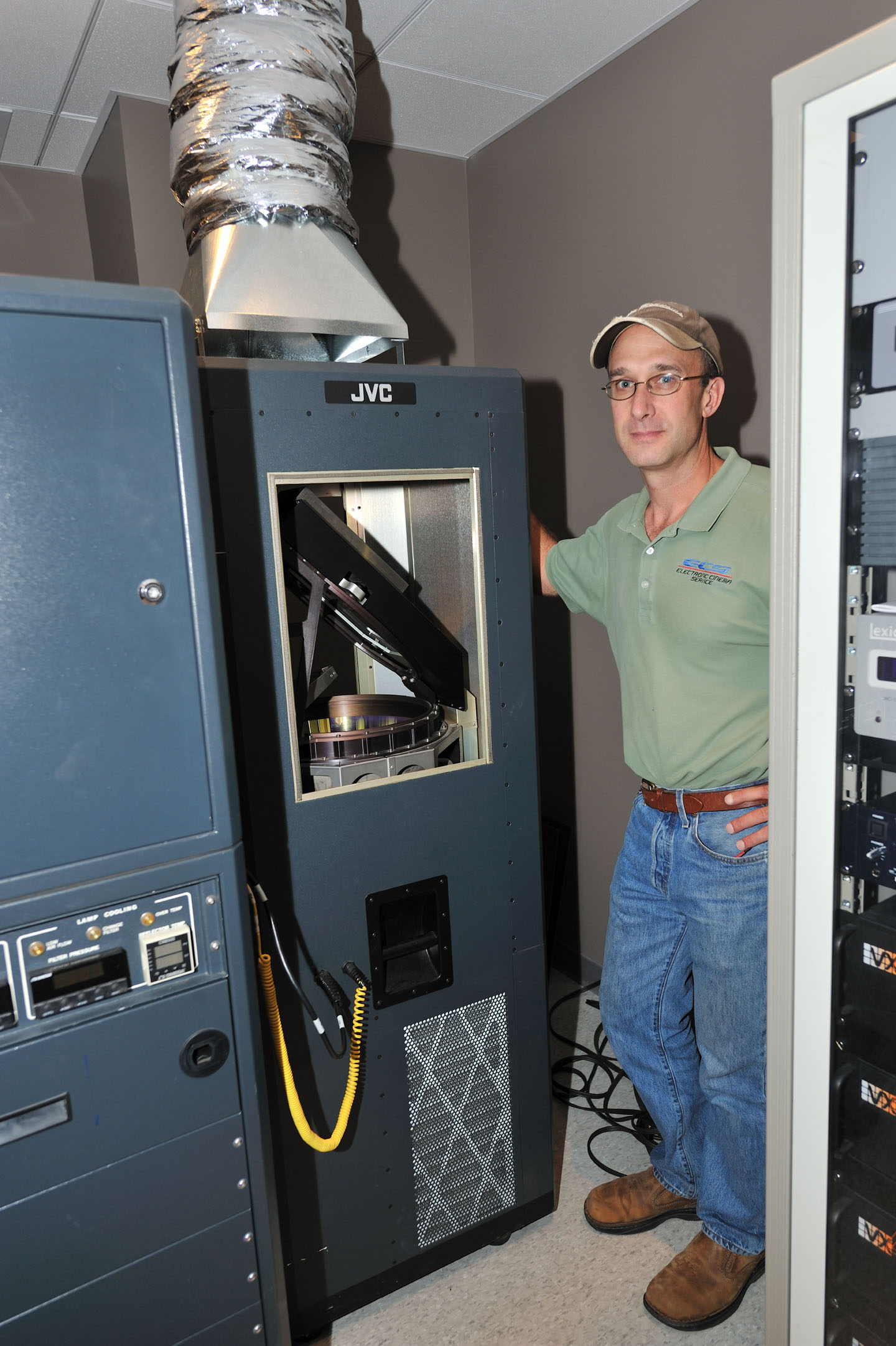

Leo Bassett ready to begin the JVC projector start-up.

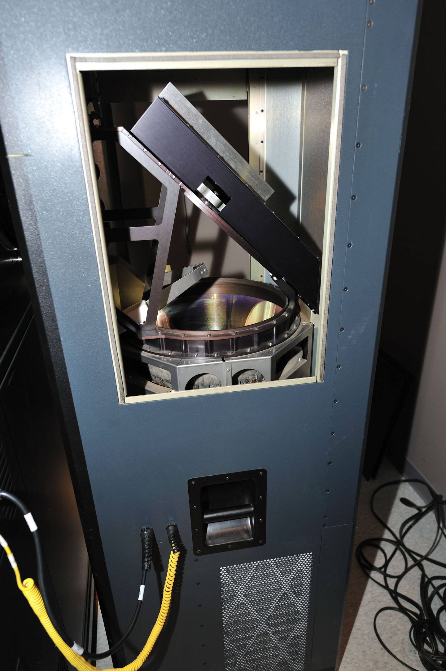

The lamp house with the access covers off awaiting the lamp installation.
