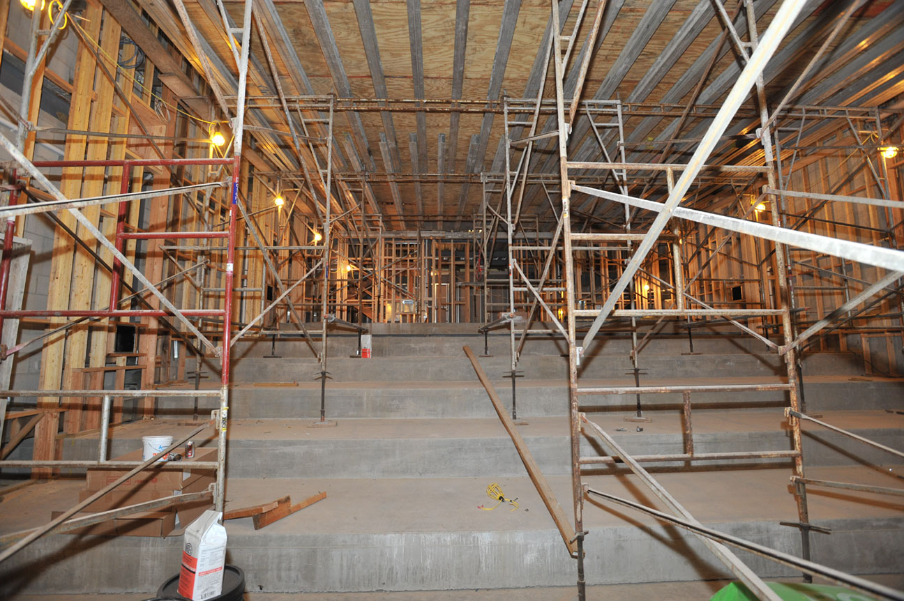

A quick update as to where the project currently stands:
During the last six months priority was given to the 'normal' living areas since things were so far behind schedule. Other than the HVAC guys doing the duct rough-in, not much activity took place in the theater. All of the speakers, amps, and Dolby equipment arrived several months ago, but it had to be placed in a storage trailer on the site. Crying or Very sad That equipment is now in the basement awaiting the construction of the speaker platform.
The construction crew is now able to dedicate more resources to the theater, and I'm happy to report that construction (on the theater) resumed this week with the electricians beginning to run the power circuits, as well as completing the wire runs to the location of the three front arrays, the two sub arrays, and the ten surrounds. As soon as the electricians finish their work, the final insulation installation takes place, followed by sheet rock.
[/img]
[img][/img]
At the front-right array position looking toward the back of the theater.

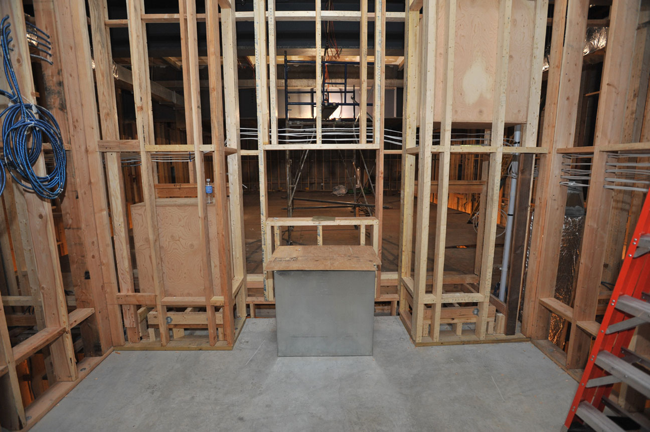

Inside the booth facing the screen area. The projection port is in the middle, with a box for the left-rear surround to the left of the port. The right-rear surround box has been temporarily moved (up) to provide access to the staging. The power panels wi

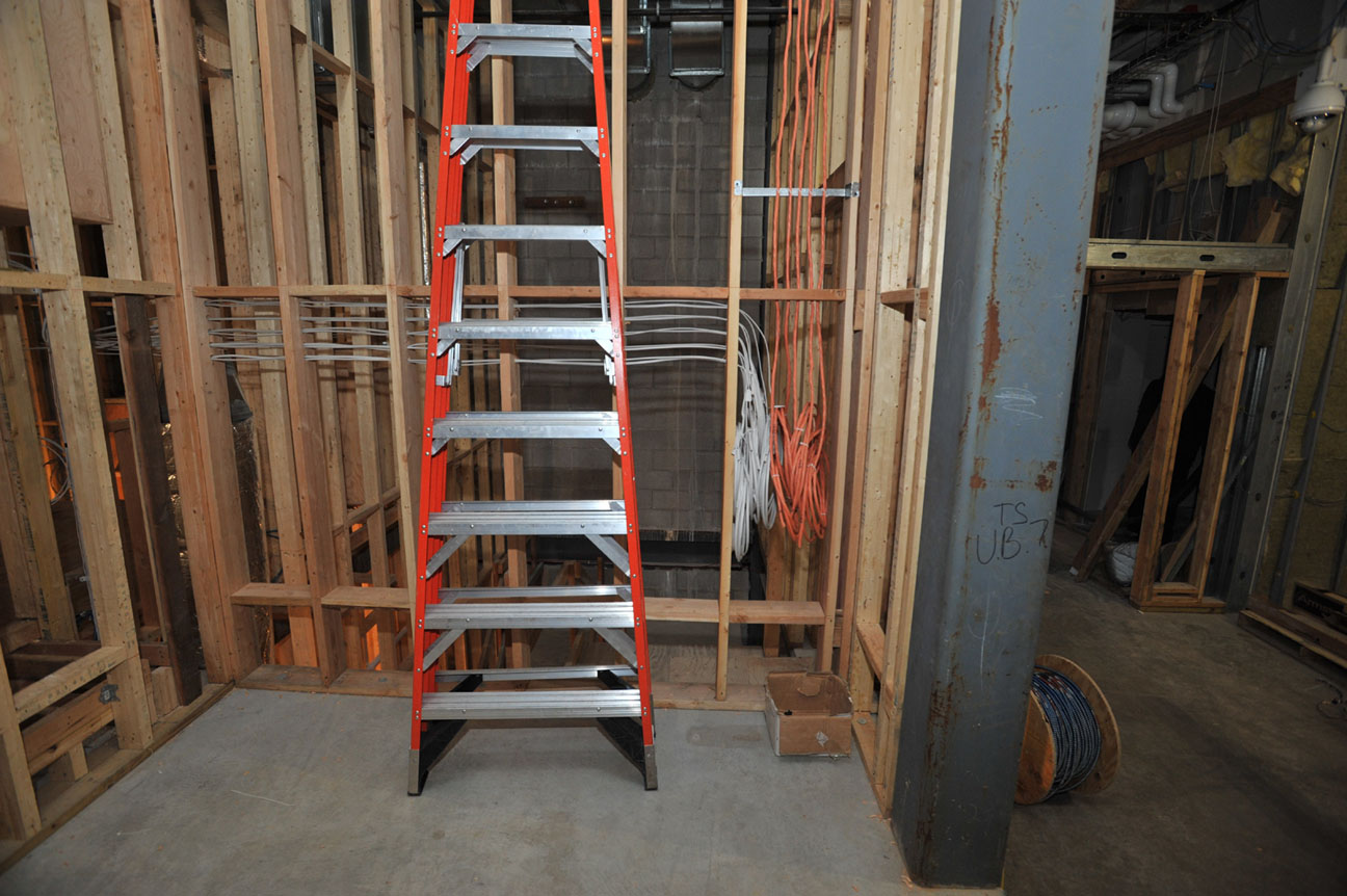

Right side of projection booth where the audio rack will be located. The five orange cables are 10-4 solid conductors that are paralleled to form a "pair" of high capacity wires to feed the front arrays. The white cables are regular 14-2 Romex i
