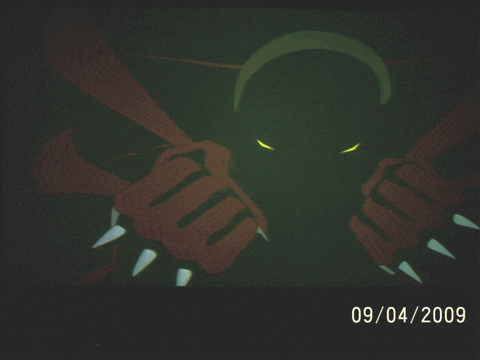

Posted: Fri Nov 20, 2009 3:23 am    Post subject:
Herringbone pic.[img][/img] I had to photo shop it to show up here, it's very obvious in person on screen.
