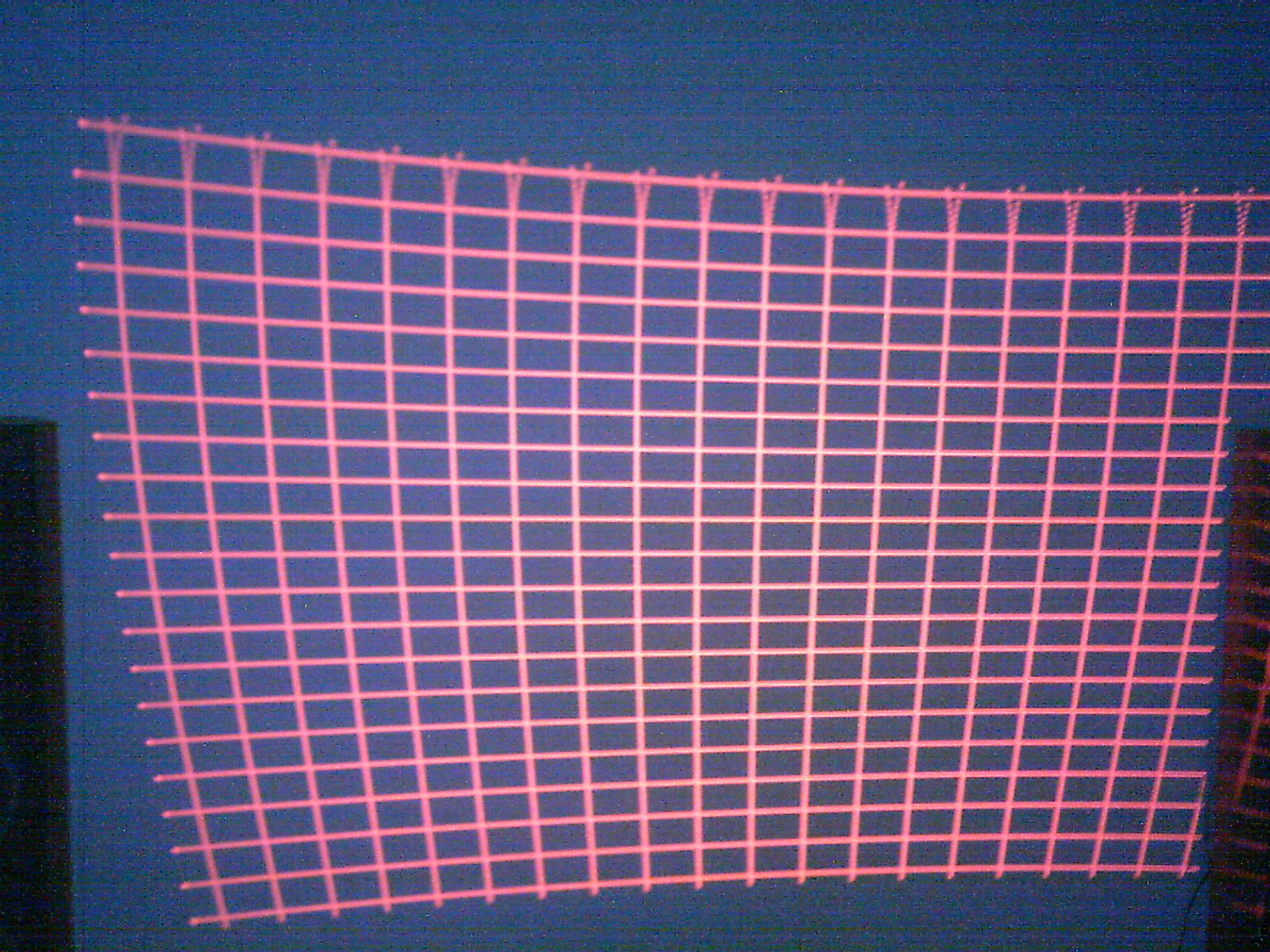

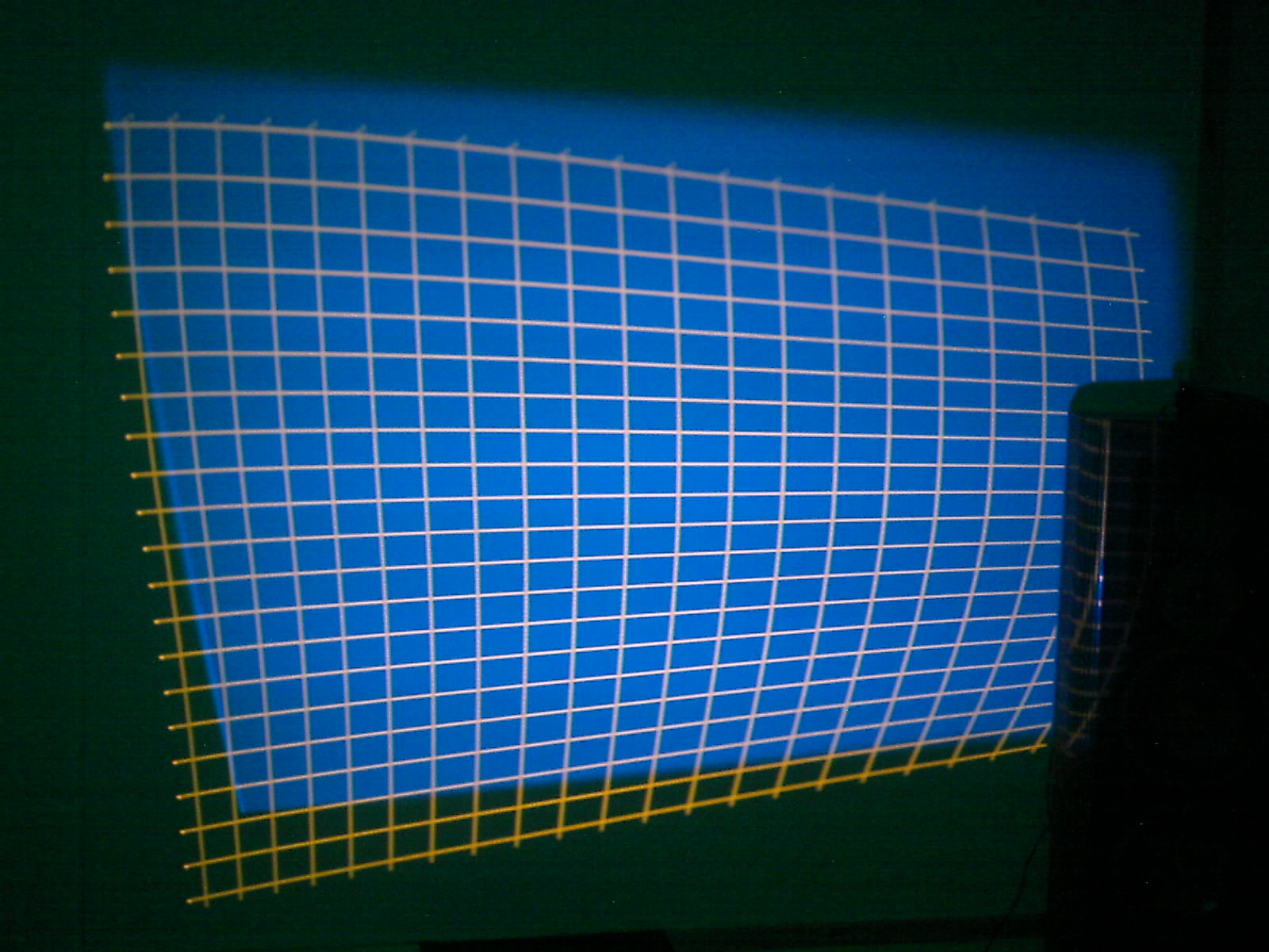

after just the blue and red, the red has grid lines the blue is just a rectangle no lines both are distorted, the red gets better with reg on the blue gets worse, the blue is in the greens place at the moment to test it.

code 30 says - 25 volts hi then no horizontal clamp.
The remote also says 300 for size on the picture if I go to green master size the vertical is fine though.

Posted: Wed Aug 22, 2007 6:05 pm    Post subject: red with code 55 registration on

Hi Incova. I have just read through your posts and first I have to ask you a question. Are you serious about wanting to fix this yourself. If the answer is yes then the first thing you have to get is a good DMM. Not expensive, just good. You cannot repair electronics without one unless its hit and miss, which is what you have been trying. After you have a DMM you must check all your voltages coming out of the LVSP. This is the first place to eliminate a problem, and the first place that causes multiple or strange problems. Your problem sounds like its in the registration board, which would cause shutdown, poor registration and unable to adjust registration, however the problem may not be the registration board but the voltage feeding it. This is why you need to verify all voltages coming out of the LVPS. Good Luck.

-25V hi and +25V hi are common errors and are not to be worried about. What they generally mean is that the registration is turned off or doing very little correction. The registration amps use the +/-25V rails for power. No horizontal clamp error is likely to mean a problem with horizontal sync.
