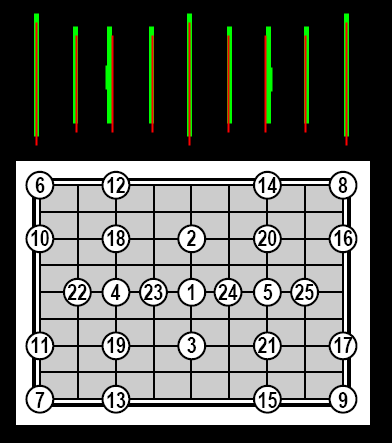

I recently hung the G70 and I'm trying to give it a proper setup. I've just spent nearly an hour trying (unsuccessfully) to converge red onto green. With the normal geometry / convergence controls (size, lin, skew, bow, key, pin) I can get a near-perfect convergence on the entire screen -- except the vertical lines left & right of center. As I tried to show in the attached picture, the green horizontal spacing is nonlinear. If you line up the R & G at center, left, and right, the green vertical lines between left&center and between right&center are too close to the edges.
So I tried to fix it with zone. I went through red & green zone 5-6 times each, trying to line things up. (I know I shouldn't use green zone at all, but I'm trying to get the two to come together, and red can't do it on its own.) But when I'd line up one area, I'd pull neighboring areas out of whack. I'm having to use WAY WAY too much zone to try to correct these problems -- MAX and MIN in a few places!! -- and it's still not working.
I noticed that without any zone at all, the green vertical lines seem to be bowed away from center a bit in the area of zones 4 and 5 (see clumsy representation below). Furthermore the green zone control for zones 4 & 5 works OK in the vertical direction, but **NOT** in the horizontal. It seems to be maxed out ("minned out" on the left), and I can't adjust it. I suspect this is what's causing my nonlinearity.
I SHOULD be able to adjust the horiz zone for green zones 4 & 5, right?

Looks interesting, could pincusion be causing this somehow?
Posted: Sat Aug 18, 2007 10:27 pm    Post subject:
I don't see how. I adjusted out any pincushion error on the edges, but then I've got the bow at zones 4 and 5. Due, I think, to the fact that the green zone at 4 and 5 is maxed out and I can't adjust it.

Zones 4 and 5 should help to balance that out. Also the use of zones 22, 23, 24 and 25 can help as they are to help with linearity.
Terry
Posted: Sun Aug 19, 2007 7:23 pm    Post subject:
Terry, that's the problem. I CAN'T balance it out with zones 4 and 5, because the green zones 4 & 5 are broken somehow. They're maxed out toward the sides of the screen, and I can't change them. The H values change when I adjust them, but the the zone doesn't move. I can move the green zones 4 & 5 vertically, and I can move the R & B zones 4 & 5 horizontally & vertically. I just can't move the green zones 4 & 5 horizontally.
If they were stuck at the centerpoint, I wouldn't be having this problem. But they're stuck at the most extreme point and I can't adjust B/R to match them without messing up the rest of the screen. And fixing the rest of the screen messes up zones 4 & 5.
I've worked with 22-25, and that helps. Maybe I'll be able to find the balance of zone & size adjustments that will deal with this. But I really wish the green zones 4 & 5 worked properly, in which case dialing in the convergence would be a snap. I would barely need any zone at all.
