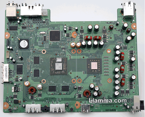

Here's an animation of the differences between the Elite and the "original" 360 if anyone is interested.
I was hoping there would be solder points to add additional memory packages like on the original Xbox but I don't see any. I added an additional 64MB to my old 1.5ver and got rid of the POS Thompson DVD for a 52X modded ver...in addition to adding an Executer X3 mod chip. That ole thing is still rockin' n' rollin' strong.

Posted: Wed Jul 25, 2007 10:21 pm    Post subject:
no hacks yet....
other than firmware hacks for the DVD drives to allow you to play backups.
I got into the old xbox hacking because my son used to step on the DVDs and break them. Loading them on an internal Hard Disk turned out to be a lot cheaper. It is great as a media center as well.
even supports VGA somewhat.
