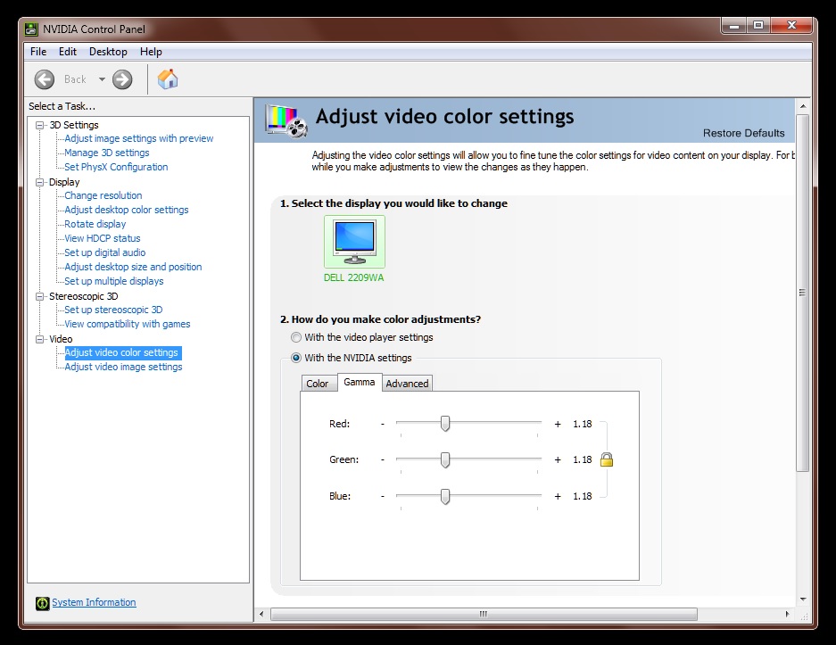

mp nice! but you need to check your video gamma

Not sure what you mean by that. Or are you saying I should calibrate the projector for better color accuracy?
