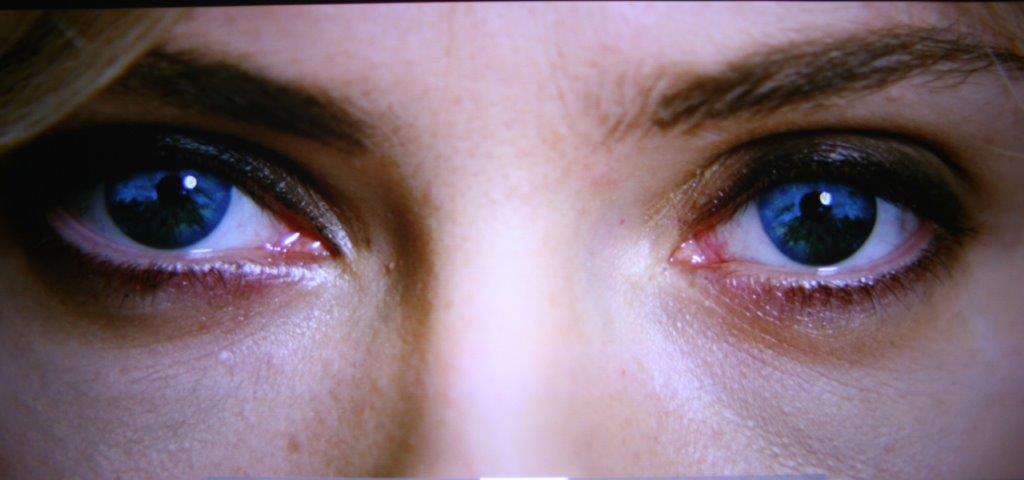

9518lc no enhancements apocolypto has been covered

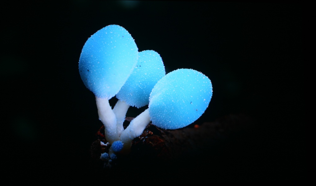

I think there is something wrong with my camera. All grays turn out with a blue tint.

Is this another example of sharpness, because there are some of the same problem ares that was pointed out previously, still present here.
Again, look at the darkness right above and around the eyes. That, as well as, the eye balls not being clear white, and the glossiness in the whites of the eyeballs, would indicate something is wrong. In close-up facial scenes the goal is to always capture the whites in the eyes if possible. Sometimes the eyes will show some slight red that would be there in the original, but they should never be very glossy. And sometimes there will be a slight amount of gloss, the whites in the eyes should still be more prevalent however.
Also and again, the shot is too dark, where as there is darkness on both side of the face, and that is usually the case when the darkness is also noticeable above and around the eyeballs, that really shouldn't be there especially on a calibrated setup.
Also, when there are bandwidth and source issues, the image will loose the natural hues like the finer pastels and the facial complexions. They always tilt towards pink or red for some reason, and are more common on Digital Technology. CRT having a more film like produced image, when done right allows for a ton of facial tones and a variance of finer shades in almost every color range. That is why Nature and Natural stuff looks so good on CRT, and is the main reason to go after the abundance of color range in High Bandwidth HD.
These of course are more critical viewing goals, that when posting shots some years back, you would get PM's from experts walking you through these visual experiences and what to look for.
My color probe is older and most likely would be out of range. But tonight I'll give it try to do a better color balance. And with me having my better Blu Ray back being directly connected to the projector. I'll pop in that Planet Earth2 in hopes to show those colors and ranges of colors that are on that disk, but these are colors beyond the Primaries, so don't be looking so much after reds popping off the screen. I don't use a RED C element, because I'm more into pastels and those finer colors that brings Pop and vibrancy to facial tones and natural elements.

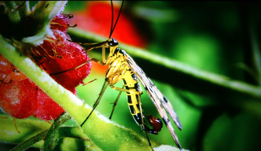

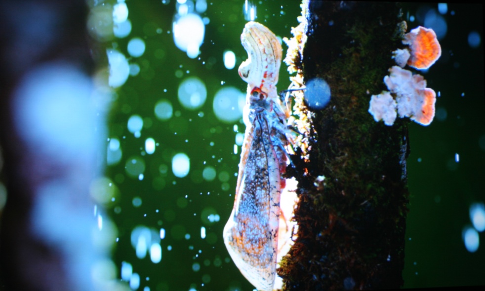

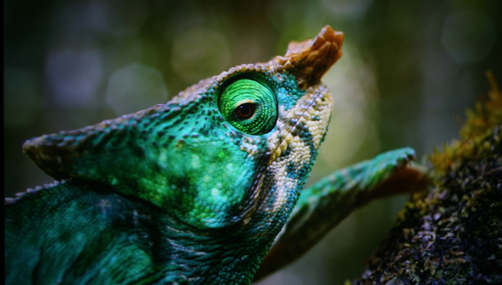

A few more. I will try a different Camera on the weekend.
