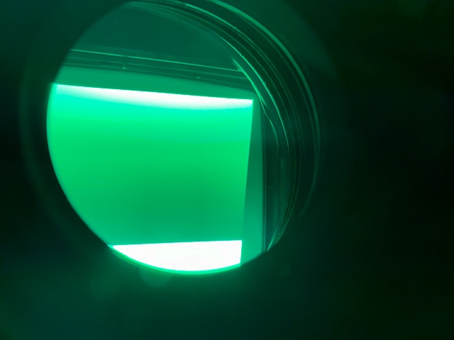

How’s this look for clearance to the tube edge? Too close? Too far?
 Filesize:  47.07 KB
 Viewed:  807 Time(s)
Jeremy
Sony G90 / Pioneer HLD-X9 / Radiance 2144 / Marantz SR5011
Posted: Tue Sep 24, 2024 3:55 pm    Post subject:
As long as you have some gap you're probably good. Not sure about the G90 and if it has any specific requirements.
station_equation
Joined: 04 Aug 2024
Posts: 32
Location: Peoria, IL
Posted: Tue Sep 24, 2024 5:15 pm    Post subject:
That's what made me nervous. Graham mentioned in his video that G90 uses the MEC tubes which had a different shape that required more clearance. With people talking about G90s breaking green tubes, I was curious if one of the causes was overdriving the raster.
I'm seriously tempted to just use the book throw distance and sleep a little better at night, given the scarcity of good tubes anymore. Was talking to Greg E., he literally trashed most of his remaining inventory and was only able to sell me a couple used Barco tubes.
Jeremy
Posted: Tue Sep 24, 2024 7:22 pm    Post subject:
I posted a reply on Facebook as well. I've had more than one tube implode in a G90 where the rasters were properly set up. Insanely frustrating a bunch of years ago when I put in a brand new tube, and within a month, it's toast.
Keep that raster off the edge as you have, run the contrast as low as possible, and that's about all you can do to try and prevent implosion.
