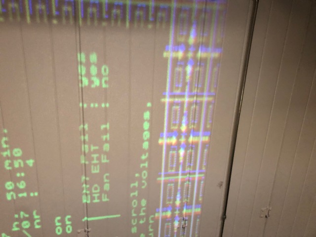

Hello ,
Sorry to bother you but here in France I no longer have any contacts for troubleshooting Barco Ciné9.
Impossible to focus on the three tubes and when it is hot (30 mins) the image changes size, grows and then shrinks.
I change all the EHT lines?
ETH module, Quad, Splitter?
At the designer's diagnosis. EHT Fail : yes HD EHT Fail: yes If you can confirm me?

Posted: Wed May 17, 2023 11:54 pm    Post subject:
The changing of the image size indicates poor HV regulation. That is usually the HV splitter, and if not, then the quadrupler. While the EHT board can also cause this, it's not very likely.

Posted: Thu May 18, 2023 7:37 am    Post subject:
Hello Pierre-Marie,
Yes, the HV parts from Cine 8 are interchangeable with those from Cine 9.
All splitters are the same, regardless of their part nr. R762XXX.
All later version of quadruplers will work, but sometimes they use a bit of different mounting. Be aware that if that Cine 8 was equipped with Sony 07MFP tubes, the quadrupler has an extra red HV focus cable. It will work without problems, but you have to isolate it well and make sure the end booth does not touch any metal.
As for the EHT board, must be R7627165. Later models Cine 8 with PFC built in, use the same EHT board.
As Curt already mentioned, the most suspected part is the splitter. Just change that first and don't forget the white feedback cable.
