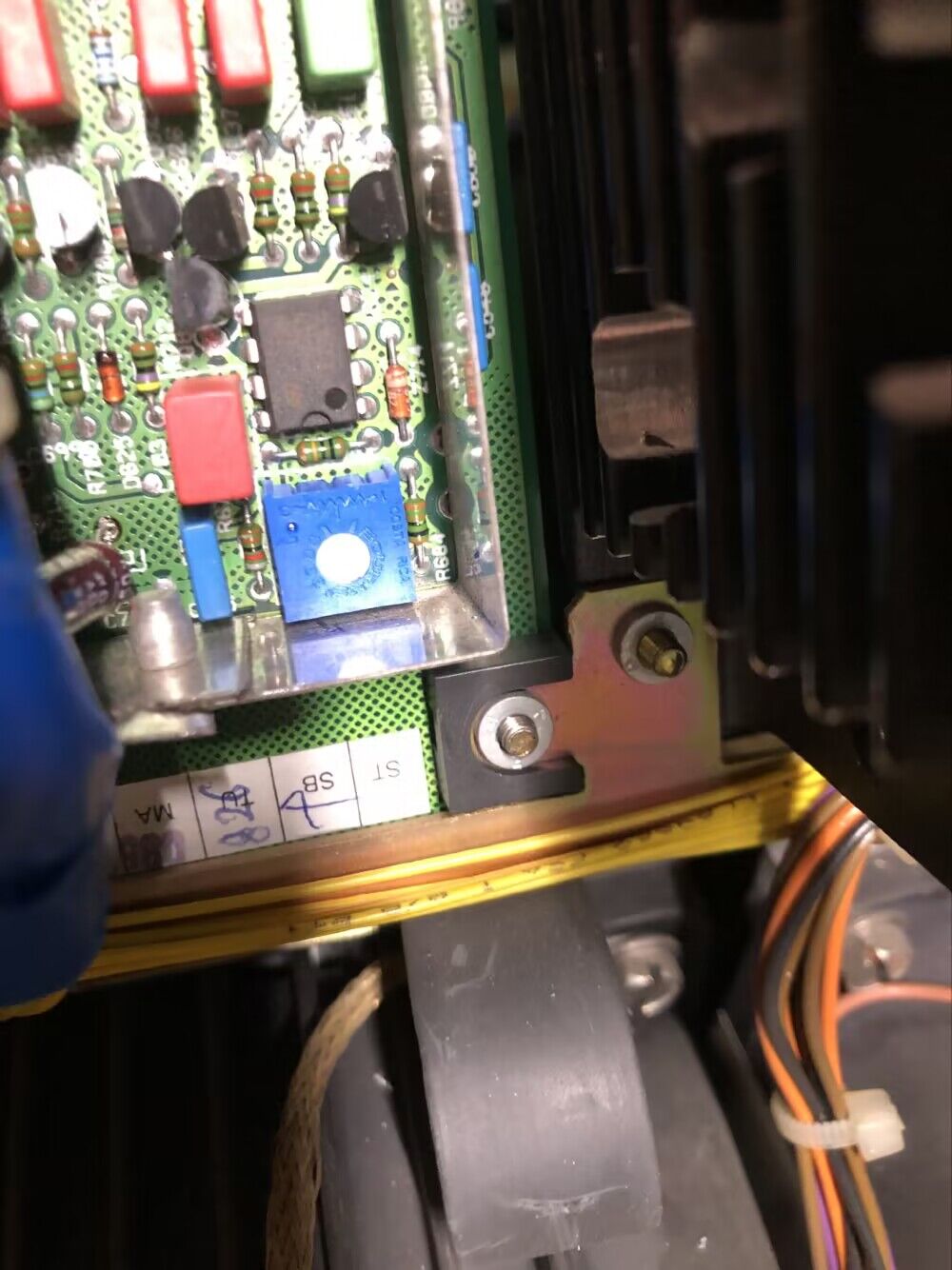

Posted: Sat Jun 17, 2023 12:42 am    Post subject: Barco C7 image jitter
P11
P676
 Filesize:  296.41 KB
 Viewed:  4459 Time(s)

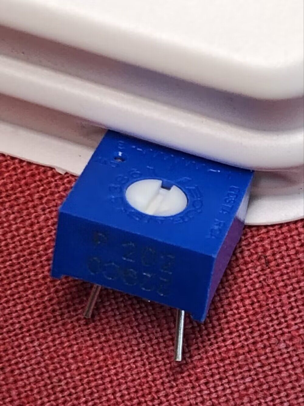

Posted: Sat Jun 17, 2023 12:44 am    Post subject: Barco C7 image jitter
P12
New P676 Potentiometer
 Filesize:  151.75 KB
 Viewed:  4458 Time(s)
bluemoonhu
Joined: 16 Feb 2021
Posts: 259
Posted: Sat Jun 17, 2023 3:45 am    Post subject: Barco C7 image jitter
After replacing the P676 Potentiometer, the image looks normal
 Filesize:  148.41 KB
 Viewed:  4449 Time(s)

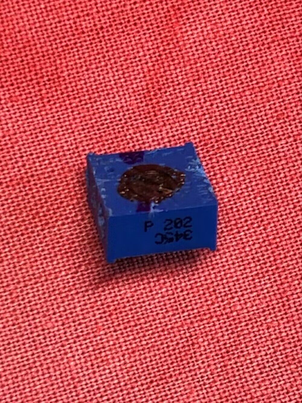

Posted: Sat Jun 17, 2023 9:15 am    Post subject:
Well done. Yeah, those trimpots loose impedance over time. Because of age, or that red sealing varnish they put on.

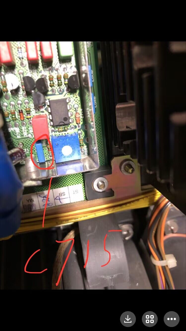

Posted: Sat Jun 17, 2023 2:50 pm    Post subject:
Ok. I see in the schematics that C715 can affect the V hold too (blue rectangular cap, closer to the trimpot). The value is 0,1uF 63V.
bluemoonhu
Joined: 16 Feb 2021
Posts: 259
Posted: Sat Jun 17, 2023 3:04 pm    Post subject:
Okay, there's a high possibility of this

Posted: Sun Jun 18, 2023 3:02 am    Post subject:
The C715 has been replaced, and the problem seems to have been resolved.
Thanks!
