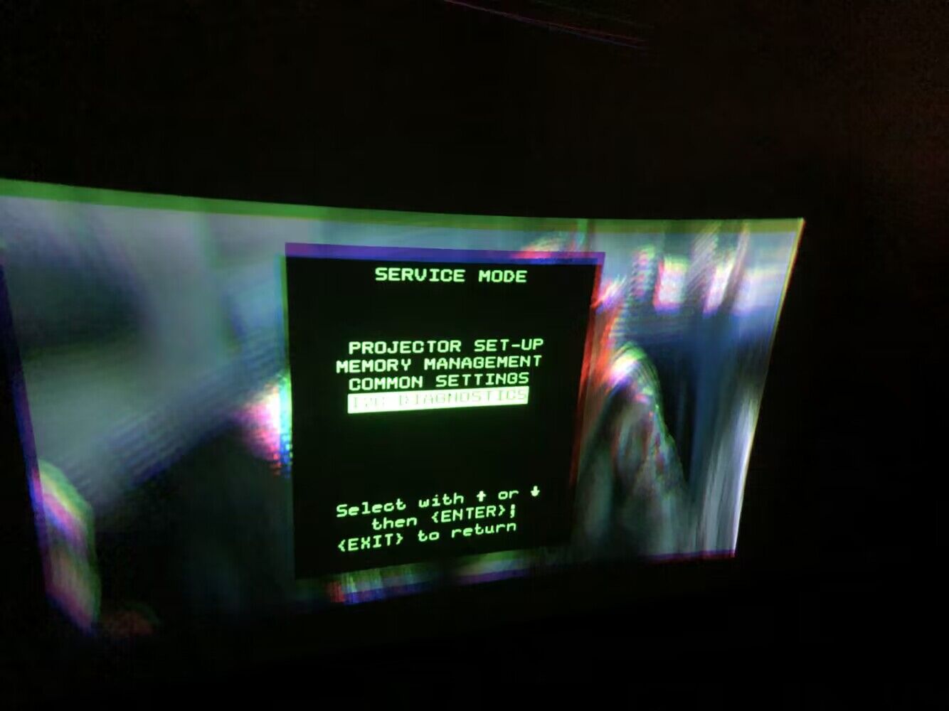

Barco C7 image jitter
bluemoonhu
Joined: 16 Feb 2021
Posts: 259

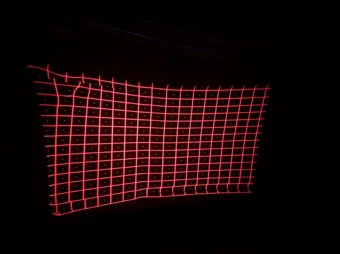

Posted: Wed Jun 14, 2023 2:55 am    Post subject: Barco C7 image jitter

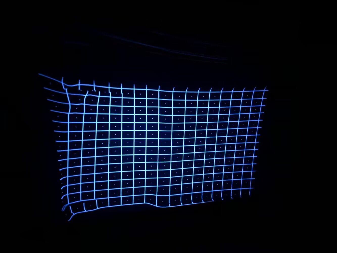

Posted: Wed Jun 14, 2023 2:57 am    Post subject: Barco C7 image jitter

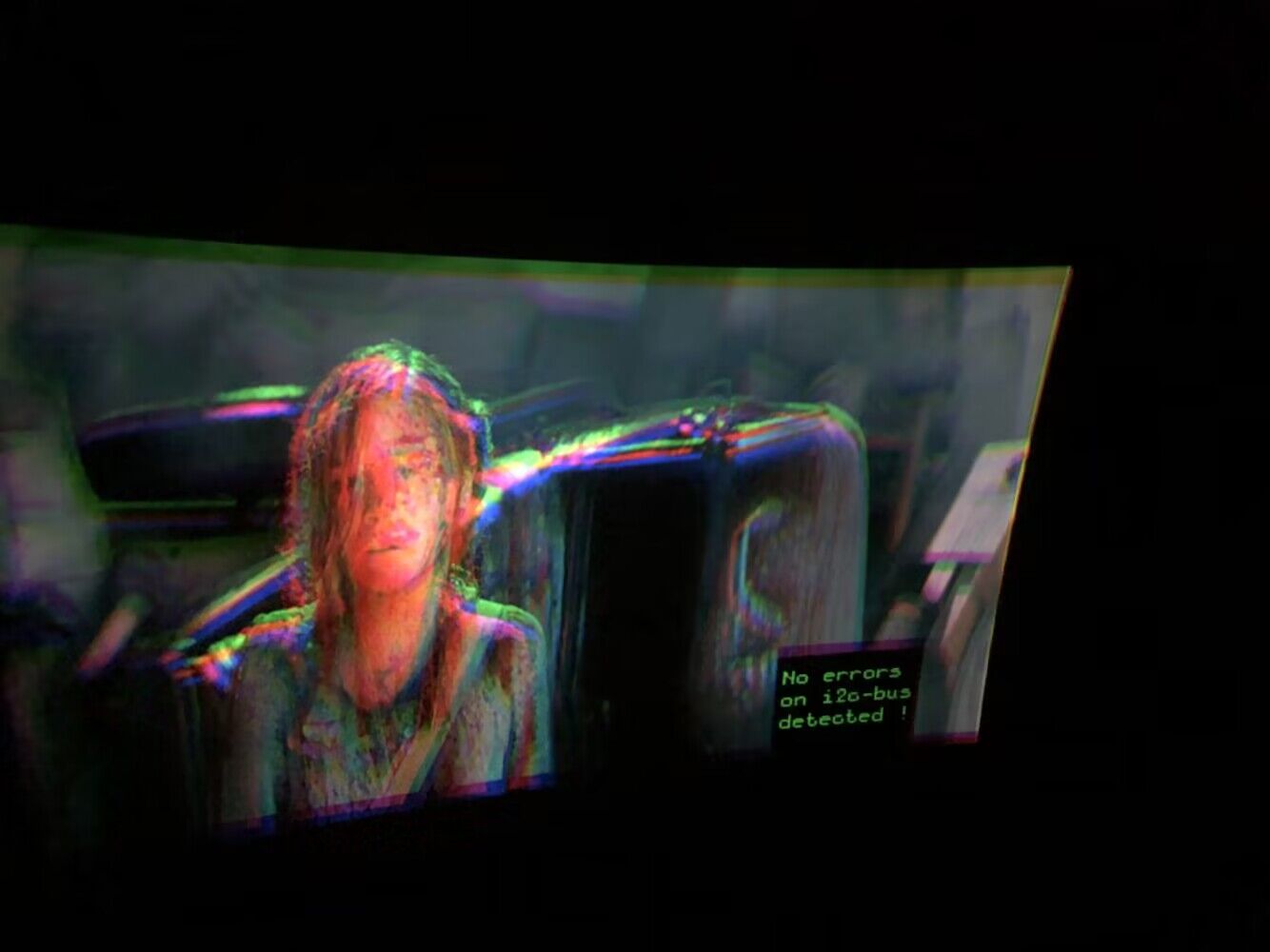

Posted: Wed Jun 14, 2023 2:58 am    Post subject: Barco C7 image jitter

Hulio
Joined: 15 Apr 2006
Posts: 494
Location: Belgium
Posted: Thu Jun 15, 2023 7:53 am    Post subject:
Any I2C error ? Look at I2C diagnostics in the service menu.

Which board in the cine7 is used to control the grille and geometric adjustments?

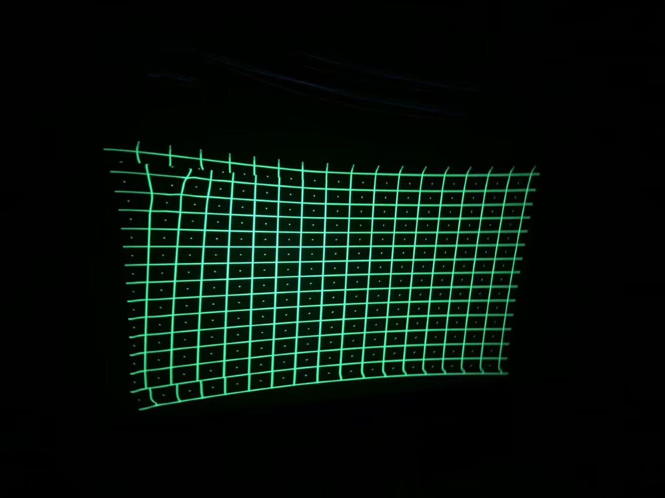

Posted: Thu Jun 15, 2023 1:19 pm    Post subject: Barco C7 image jitter

Posted: Thu Jun 15, 2023 1:24 pm    Post subject:
Now, the geometric grid cannot be adjusted
Hulio
Joined: 15 Apr 2006
Posts: 494
Location: Belgium
Posted: Thu Jun 15, 2023 9:27 pm    Post subject:
Ok, no I2C errors thus.
The convergence driver board R762454 generates the horizontal and vertical waveforms. Try to replace it and give it a try.

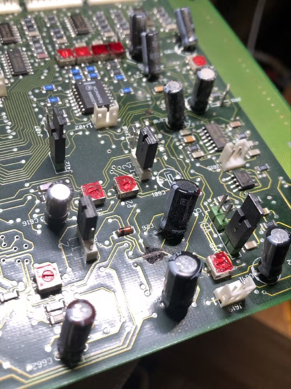

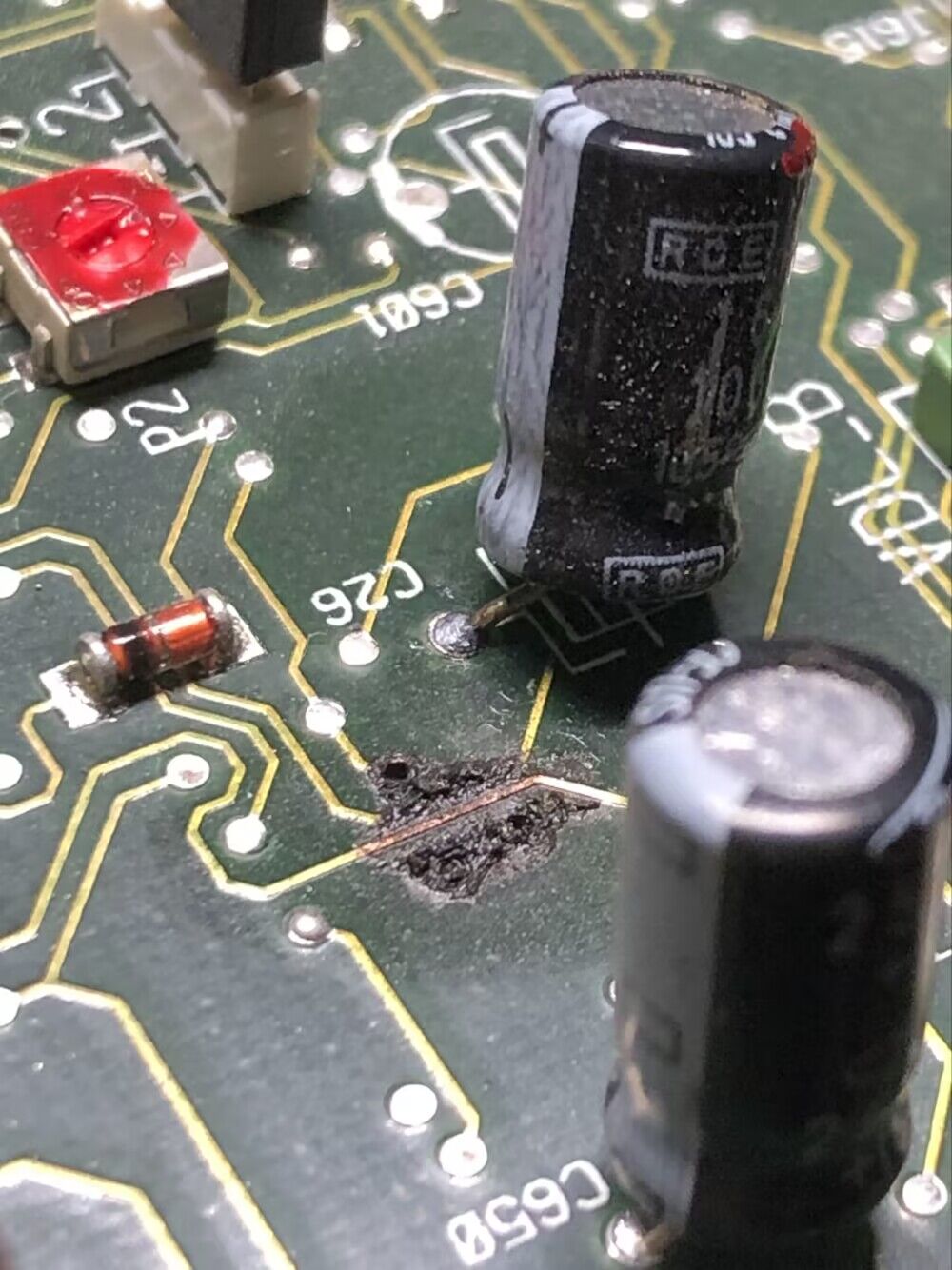

bluemoonhu
Joined: 16 Feb 2021
Posts: 259
Posted: Fri Jun 16, 2023 11:31 am    Post subject:
I observed the driver board and found a pile of black layers on it. I don't know what it is? Will it affect functionality?
bluemoonhu
Joined: 16 Feb 2021
Posts: 259
Posted: Fri Jun 16, 2023 11:32 am    Post subject: Barco C7 image jitter
pic7
 Filesize:  224.62 KB
 Viewed:  7256 Time(s)
bluemoonhu
Joined: 16 Feb 2021
Posts: 259
Posted: Fri Jun 16, 2023 11:42 am    Post subject: Barco C7 image jitter
pic8
 Filesize:  175.22 KB
 Viewed:  7248 Time(s)

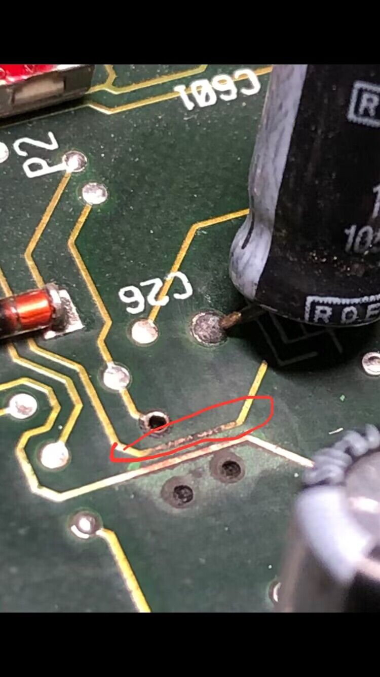

bluemoonhu
Joined: 16 Feb 2021
Posts: 259

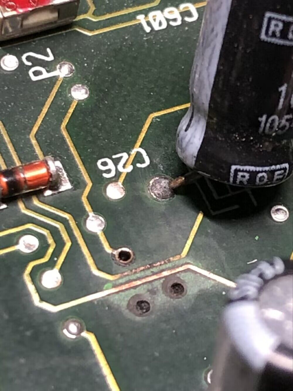

Posted: Fri Jun 16, 2023 12:10 pm    Post subject: Barco C7 image jitter
After cleaning, was the above line corroded and disconnected?
pic9
 Filesize:  150.65 KB
 Viewed:  7247 Time(s)
bluemoonhu
Joined: 16 Feb 2021
Posts: 259
Posted: Fri Jun 16, 2023 12:53 pm    Post subject: Barco C7 image jitter
Be sure this line is broken
pic10
 Filesize:  110.46 KB
 Viewed:  7244 Time(s)
Hulio
Joined: 15 Apr 2006
Posts: 494
Location: Belgium
Posted: Fri Jun 16, 2023 2:38 pm    Post subject:
Could be, just replace it to be sure.
bluemoonhu
Joined: 16 Feb 2021
Posts: 259
Posted: Fri Jun 16, 2023 3:35 pm    Post subject:
It is obvious that the driver board is faulty. I tried to connect the disconnected wire, but it took a long time and failed. I had to replace it with another driver board.

bluemoonhu
Joined: 16 Feb 2021
Posts: 259
Posted: Sat Jun 17, 2023 12:14 am    Post subject:
Hulio wrote:
Yes, that was the advice too. So what's the outcome after replacing de conv. driver board ? Are the grid lines still distorted ?
Yes, the grid lines are normal, and the geometric adjustments are normal
Thanks!
