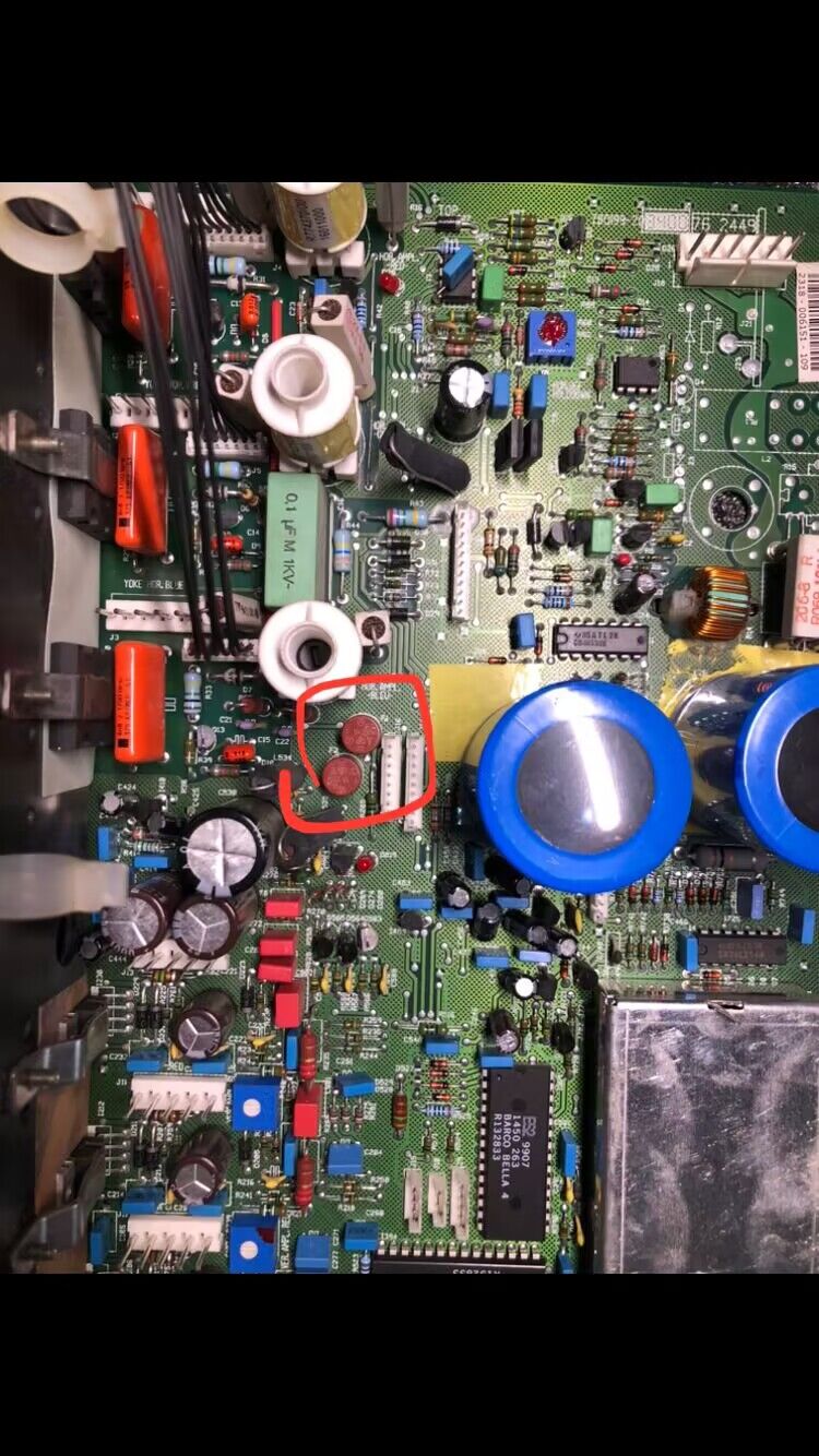

These two fuse resistors are burnt out

I replaced two fuses, but the problem was not resolved. I checked the deflection board but couldn't find the cause. It's really disheartened

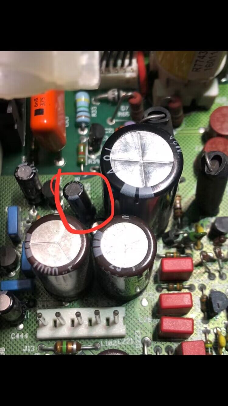

I seem to have noticed liquid on the circuit board below a capacitor on the deflection board. Is this capacitor already broken?
 Filesize:  165.23 KB
 Viewed:  5915 Time(s)
Posted: Thu May 25, 2023 1:00 pm    Post subject:
Measure it and see.

Posted: Thu May 25, 2023 1:17 pm    Post subject: Barco C7 image jitter
Measure it and see.
OK,I am ready to replace it。Thanks!

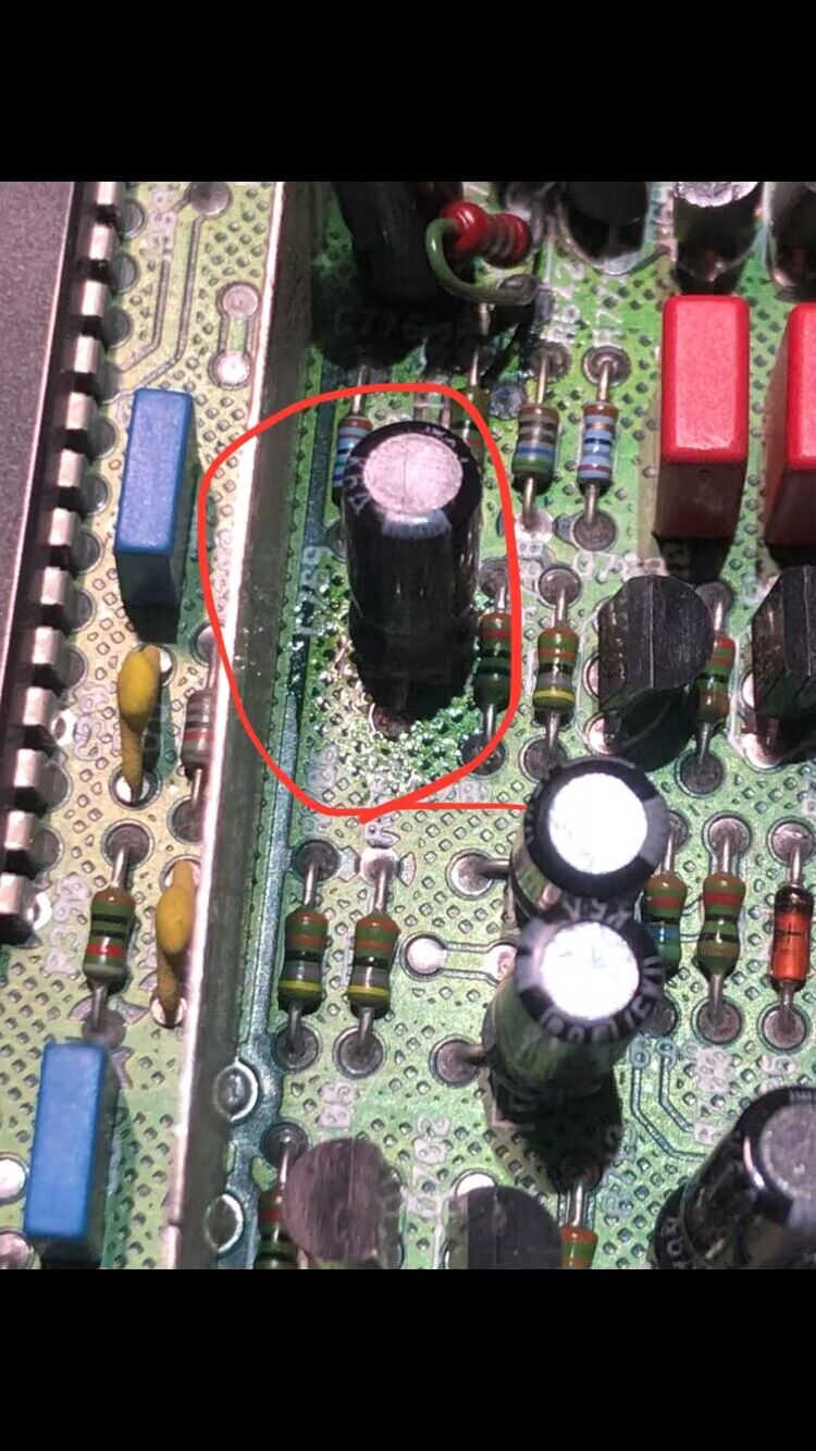

More than one capacitor is leaking liquid, and this capacitor is also leaking liquid

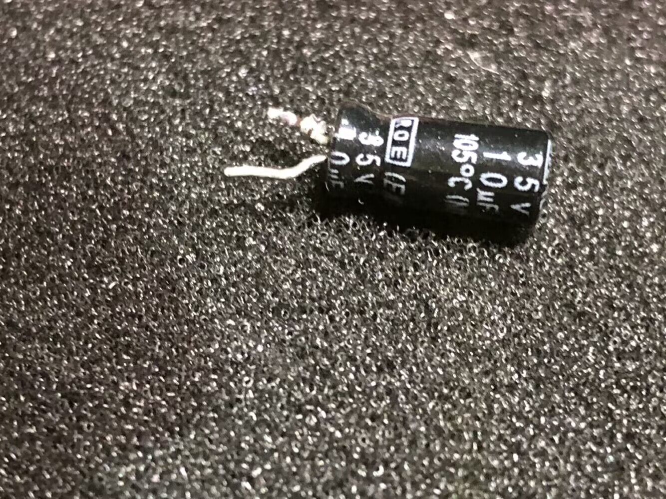

Both capacitors are of this model

After replacing these two capacitors, I started up the cine7,but the fault still persists.

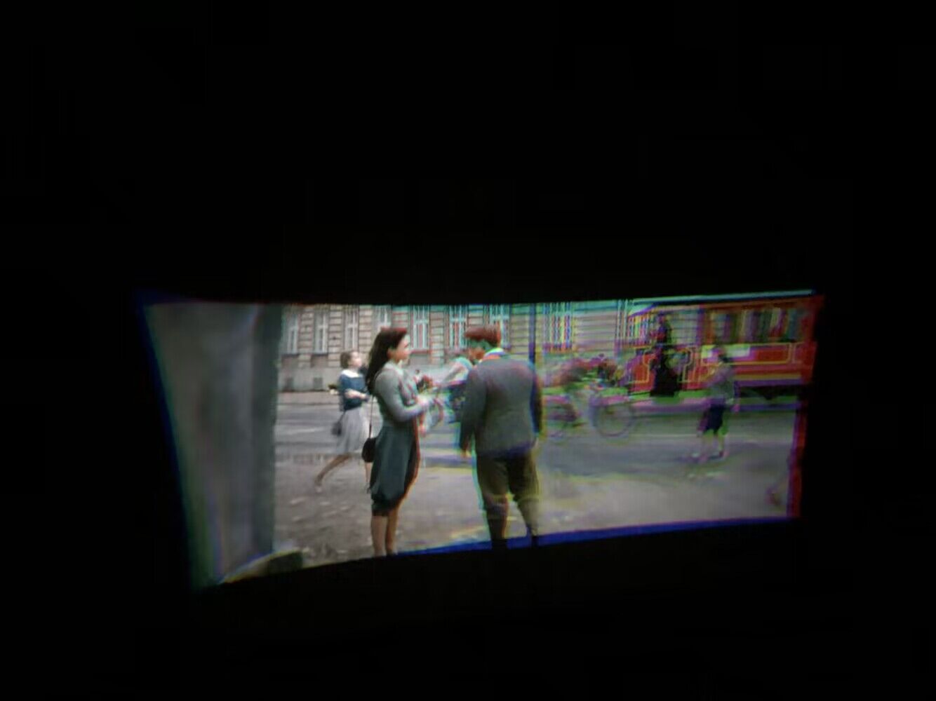

Yesterday, when I was watching this C7 normally, a new condition appeared again. Prior to this, the machine had been running normally for several days. However, after about ten minutes of watching yesterday, the images began to deform, converge in disorder, geometric deformed and cannot be adjusted. I turned off and then turned on again, and the condition remained the same. The deflection board problem has been eliminated. I doubt which Potentiometer needs to be adjusted or the GBR board problem? Please guide, thank you!
