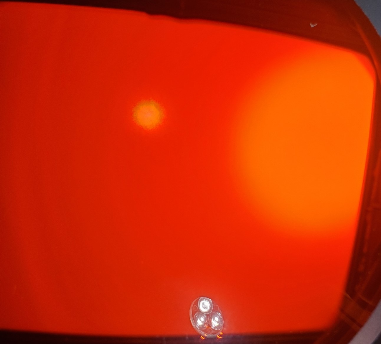

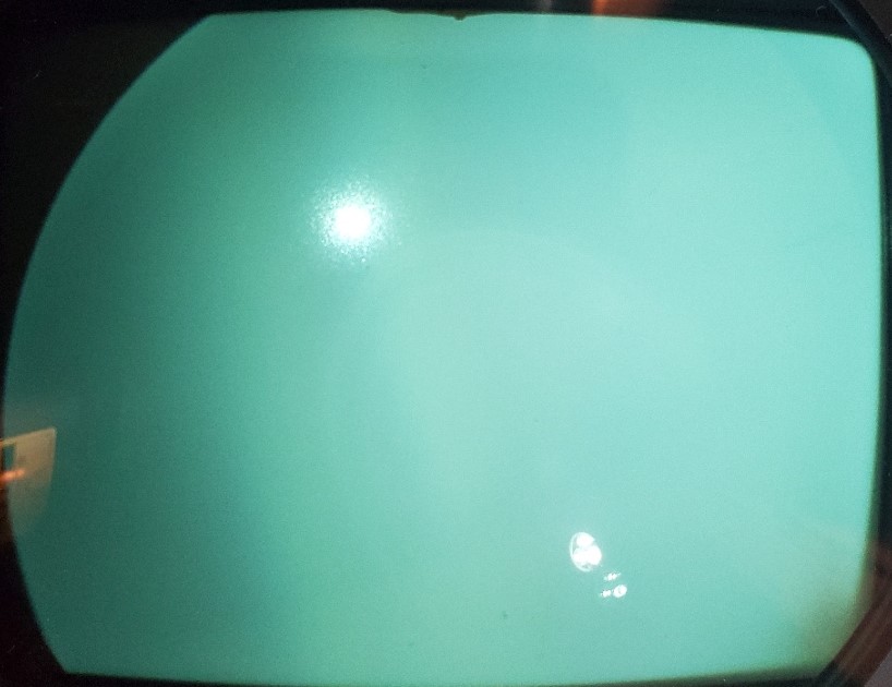

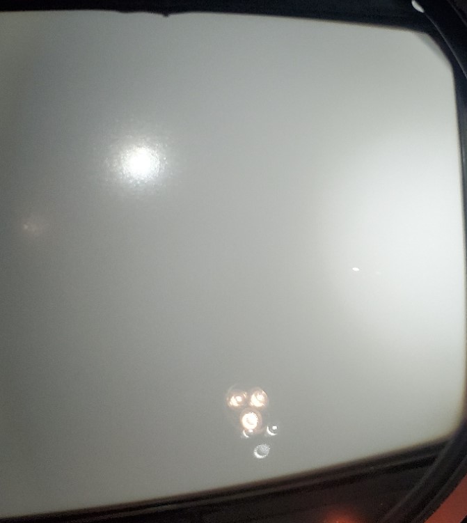

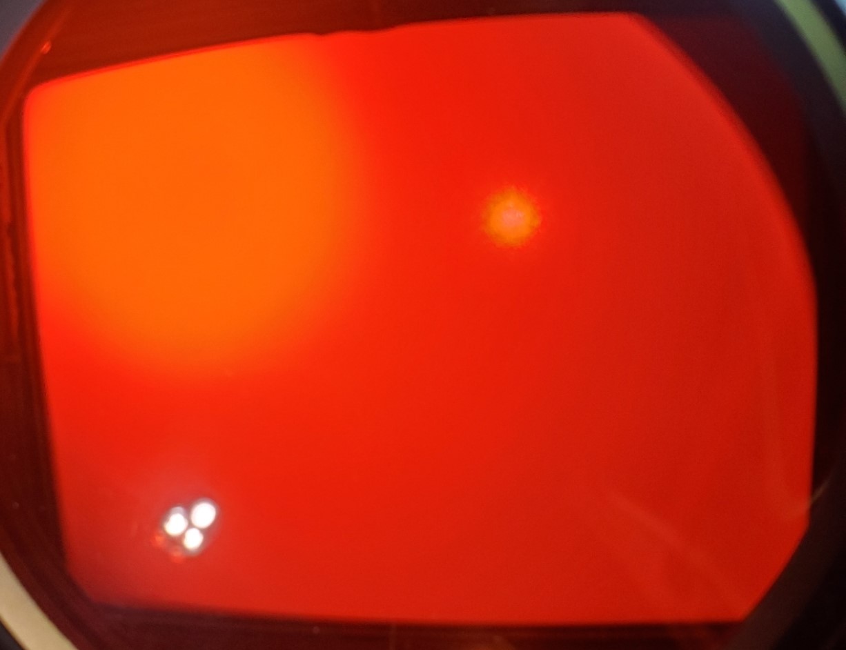

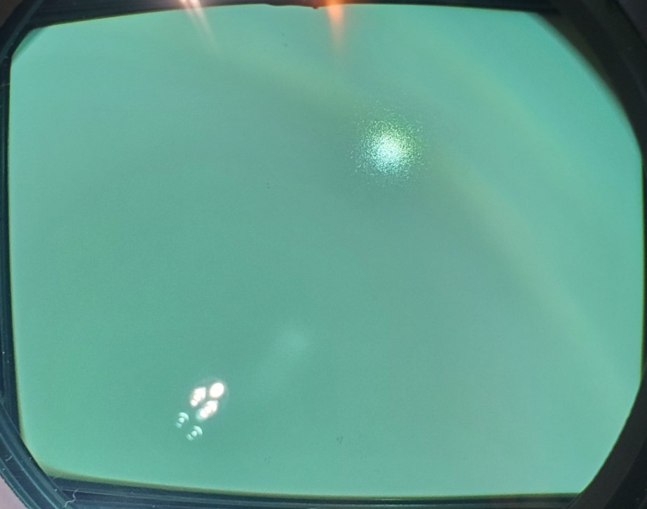

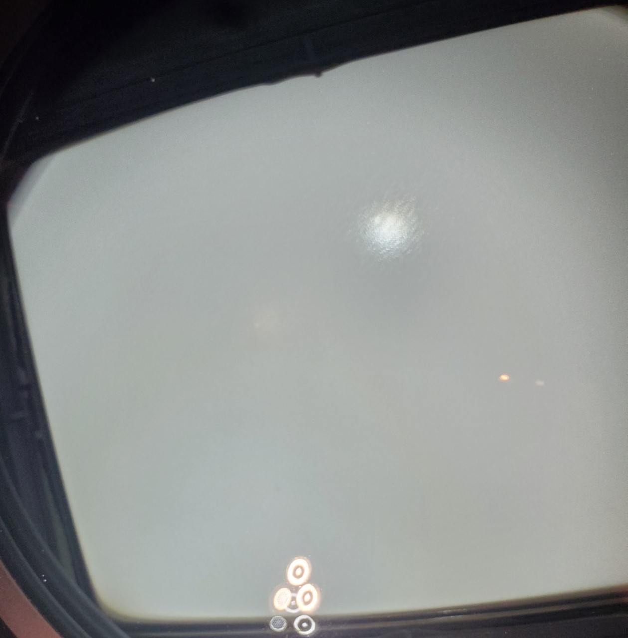

Pics of the tubes BTW.

You're already in trouble. The C elements are bubbled, indicating the lenses were pointed at the sun while moving it. You need to source those as well now.
Or, is that a phone flash reflection?

Posted: Sun May 14, 2023 2:37 pm    Post subject:
Very Happy
Just a flash(light) reflection! It was in it's original box when moved, lens caps on and all! Those are rough to photograph! Lol did the best I could to aim a flashlight at one side, snap a pic , then the other, snap a pic.
The tubes look absolutely pristine. No wear pattern at all.
Good to know I better keep them away from the sun though!

You got any tips on getting a complete Pic of these tubes with even lighting? Lol
Seemingly not wheel it into the sunshine...
Posted: Sun May 14, 2023 4:18 pm    Post subject:
Definitely not. Full sunlight, with the lenses on, can fry the C-Element in seconds.

Posted: Sun May 14, 2023 4:38 pm    Post subject:
Wild! Glad these haven't been in the sun! Also those pics were with the lenses OFF. 😁

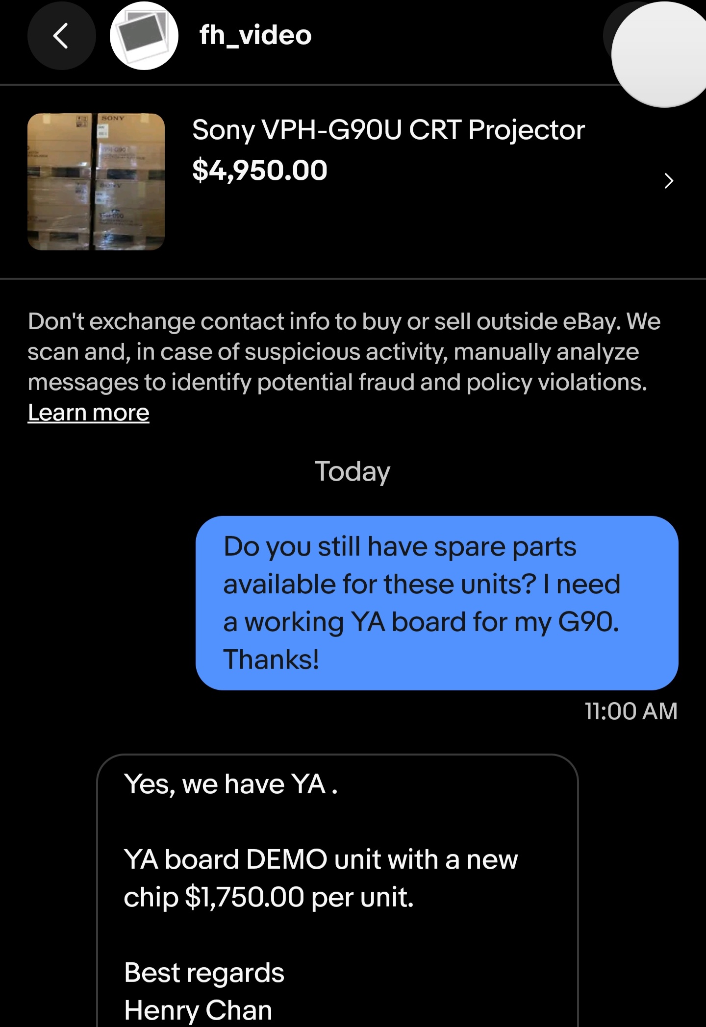

Posted: Sat May 20, 2023 4:47 pm    Post subject:
So apparently FH Video in SF has YA boards available...for $1750!!!
 Filename:  Screenshot_20230519-114405_eBay.jpg
 Filesize:  297.06 KB
 Downloaded:  132 Time(s)
Posted: Sat May 20, 2023 4:53 pm    Post subject:
Ha, they are still trying to get stupid prices for their g90 stuff. THey bought out the US inventory of stock probably.. 20 years ago, and advertised the projectors for $20K USD+ on eBay for years. Finally dropped the price again and again. I know they sold some projectors, and I'm assuming that their freight costs from Sony were probably more than what they paid for the inventory in the first place. Smile
