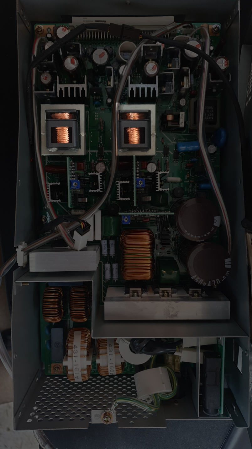

Noise of the powersupply has been further reduced. When contacting a few repair shops and all refused to help, I did some modding myself. I put silicon washers between the screwholes of the pcb to the case, and added a few rubber gromets between the choke coils. It helps, but still has an annoying buzz at times, so I’m continuing my search to repair it. I suspect the two small transformers, the coilwiring has loosened over time. If I can’t find any repairshop I might put some special glue on it to see if it helps.

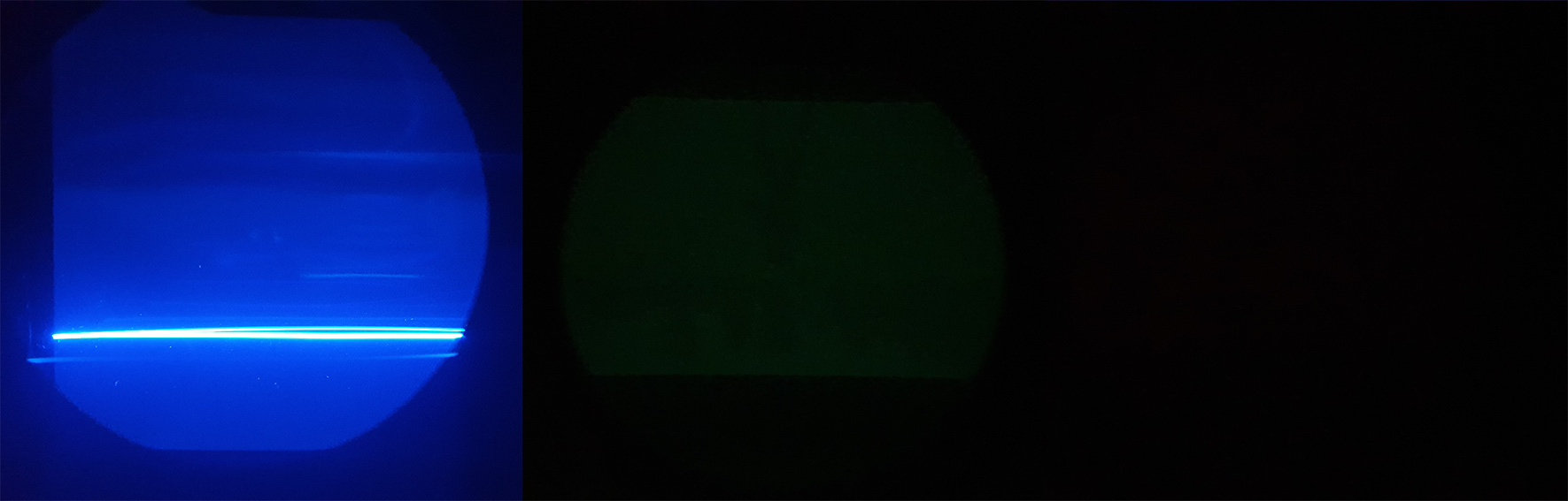

In my previous post I mentioned the blue line on the crt projector in ‘picture mute’ mode.
Here are the pictures of the 3 tubes in mute mode, anyone knows if this is normal? I don’t use the mute mode often, but my reasoning was it’s better to mute the image for 30 mins than power cycle the projector. Maybe I’ll use a screensaver on full black instead, at first glance it shows no difference from muting the picture on the projector itself, and it does make the blue tube fully black’. Is there technically a difference between muting and putting a full black image on? Any input would be appreciated.[/img]
It's common for the potting used in transformers or similar to dry out, causing the plates to make more noise as they vibrate and bump into each other. Replacement is one option, or if the plates are visible you can add epoxy or similar.

My idea was to pour some high viscous glue on these highlighted components, and let it dry for 24h.
Or would that be a mistake?
No idea. May make removing/servicing in the future harder, but unless you're planning on doing that servicing yourself I wouldn't be concerned as there's nobody left who can service this stuff. I don't think what you're showing is very high voltage but if it is then you have to consider the dielectric constant of the glue.

I'm weighing my options on the transformers. Thing is I'm not even sure those are causing the noise and I have no way of testing it.
I might try some tape first to see if I hear any difference at all.

You might find an old trick from CRT repair useful: A simple plastic hose, diameter of about a finger and two or three feet long. You hold one end to Your ear and with the other end You move around inside the device. By this You‘re able to identify sources of noise without risking electrical shock.

Posted: Wed Mar 29, 2023 4:59 am    Post subject:
Thanks for the tip, though it's impossible to get a tube like that or anything inside it while it's running.
And I don't have the electronic know how, how to turn the psu 'on' when it's outside the projector.
I'm afraid it'll be damaged if I flip the switch when it sits on my desk.
I'm ok with computer PSU's, I just don't know these kind.

Posted: Thu Apr 06, 2023 5:28 am    Post subject:
Out of frustration of the psu noise I just started jamming rubber gromets wherever I could, and behold...it's silent!

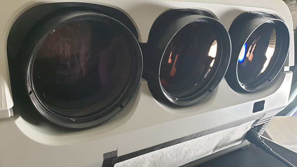

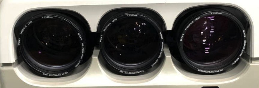

I have a question about the lenses. The one I'm using now has these pure black rings with no print, while the one for sale has these sony hacc rings. Are these different lenses? The one I have now is brand new and I thought they all shipped with the same lenses. Is the one on sale an upgraded version? If so, what would be better?
One difference, the one I have is from the USA, the one on sale is from Japan.
