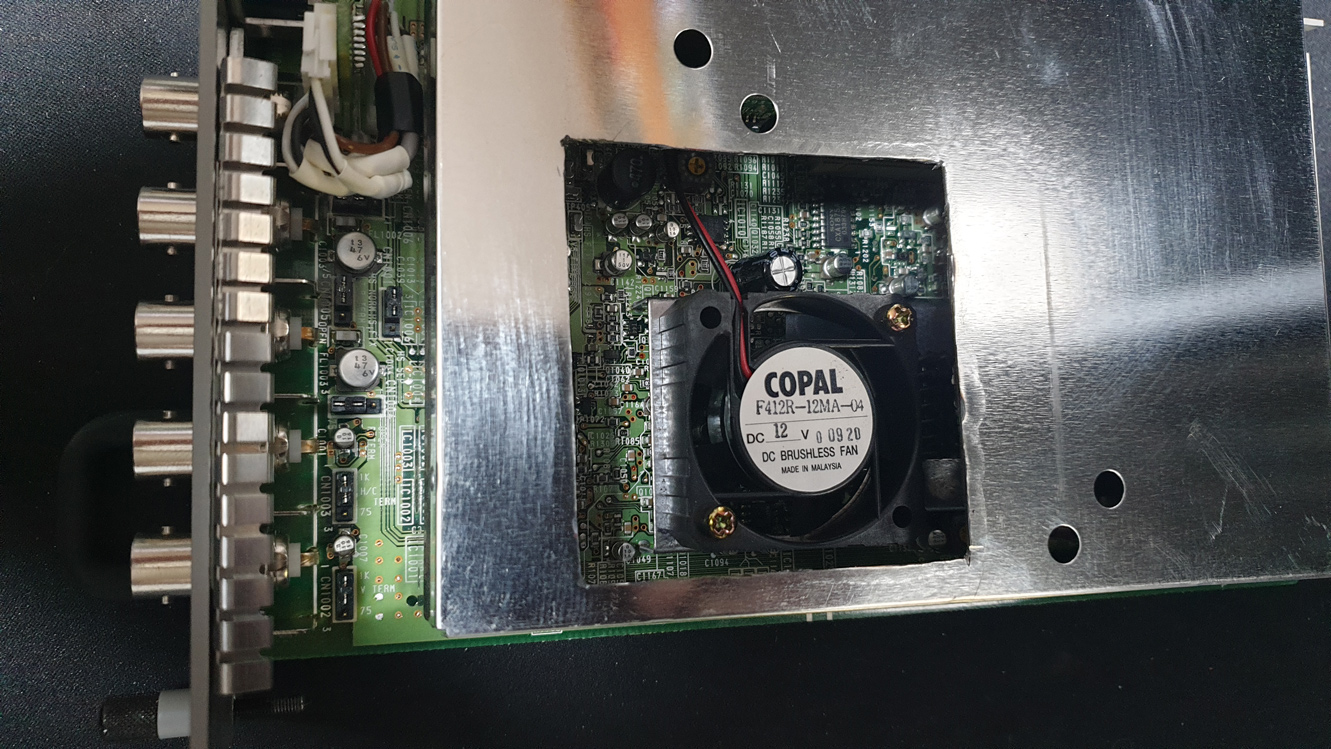

Replaced the final fan in the INPUT A board, what a difference!
Now I only hear the low hum of the duct.

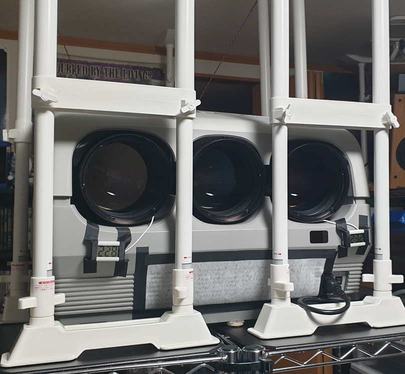

A few pictures, I didn’t want to take everything apart so it doesn’t show everything.
Welcome to earthquake country, Japan.
It sits on top of a 150cm metal rack and I secured everything with the ceiling.
Temperature sensors, temporary, taped to the left and right.
Taped a filter over the intake, to reduce dust.

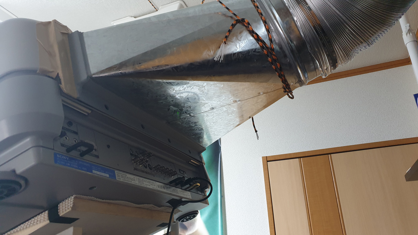

The duct. Custom made and sadly a lot heavier than expected.
Used doublesided velcro tape so it’s not a permanent connection.
I also had to secure it with a wire to the stability beams going to the ceiling, which means I can’t take off the cover for now. I need to replace the wire with some sort of quick release.
The duct itself goes to a small walk-in closet where my ps5 and NAS also sit.
The hole I cut for the 60mm fan. I secured it with tieraps and 4 small pieces of mousemat on the sides so it has a cushion and won’t vibrate. I did exactly the same for the psu fan, replaced with a 80mm noctua fan.
For now I’m done with the modding and very happy with the outcome.
I’ll just have to wait for the 1.5 gain screen and then I can fully enjoy this baby.
