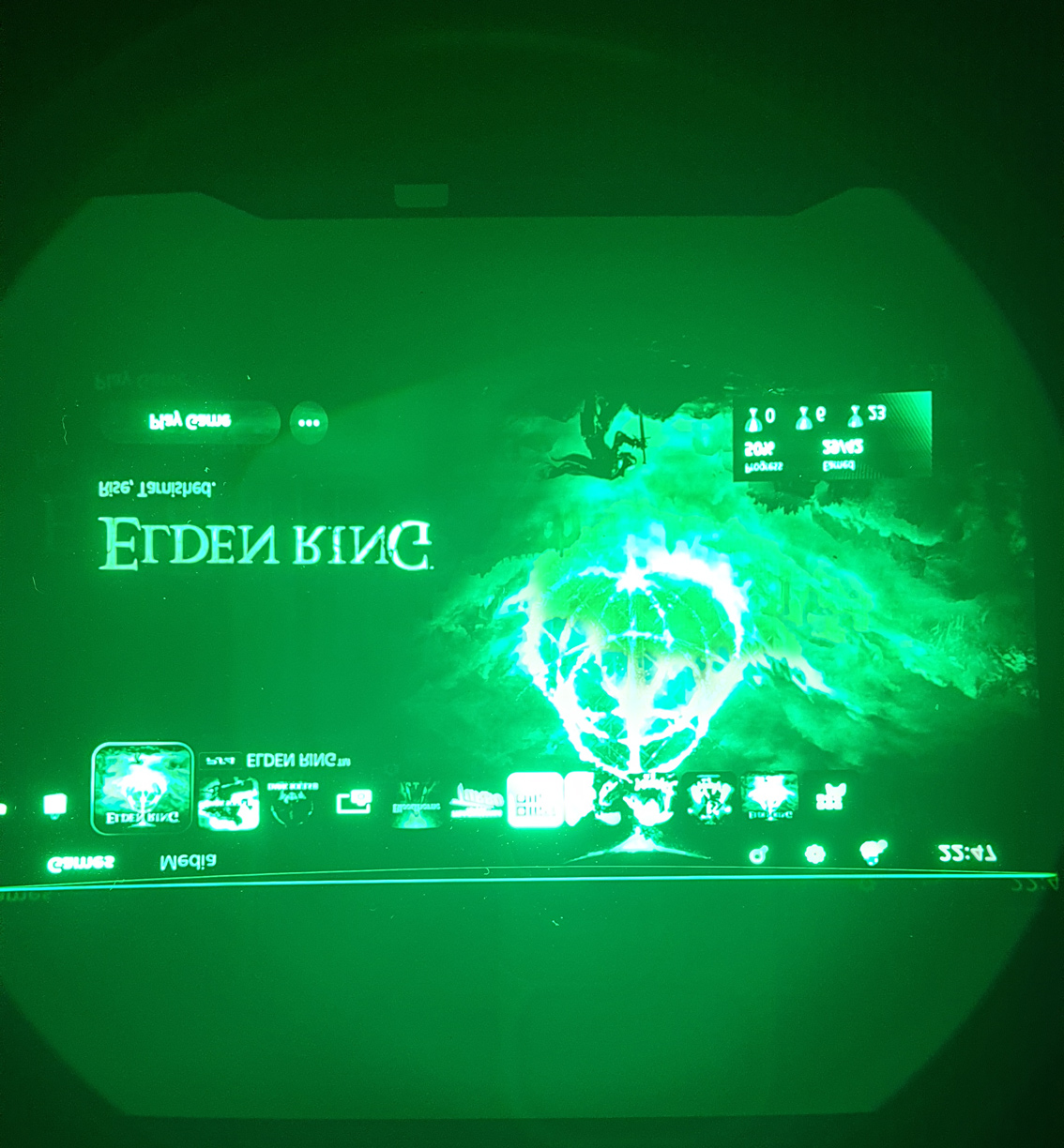

On the top of the screen (and bottom inside the tube) there is a bright line. See attached picture.
When I checked the guide on this forum of used tubes, I always saw some kind of rectangle with no line. Is something wrong? I’m not sure, I need to check, but when I used a svhs input before, I didn’t have this line.
Resolution used is 1280x720 @ 60hz.
(The picture shows a faint reflection at the bottom, this is not on the tube, I think it's the lens reflection.)
That's the AKB line. It's normal on many projectors including Sony. Search the forum for "AKB line" for more. The manual may explain it as well.
