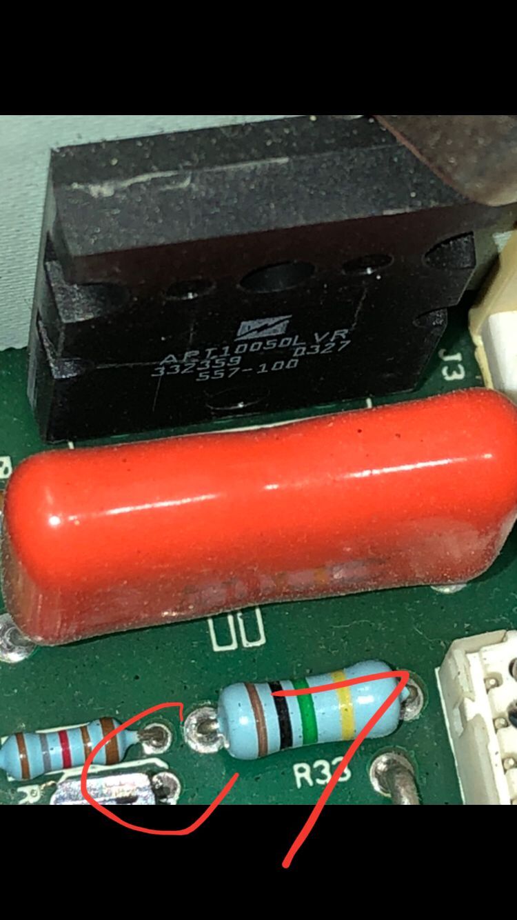

That's the horizontal linearity control board, and there is no component C7 on it. I think you are confusing it with the electrolytic capacitor C1.
Q1 is the one in your picture, that's a MOSFET transistor and to check it out you have to take it out of the circuit.
From left to right in your picture, the transistor legs are: Gate, Drain, Source. The best way to check it, is to put your multimeter in diode modus.
Black probe to Source and red probe to Drain should give a reading between 0,4V and 0,9V. If 0, open or no reading, the transistor is bad.
Now if you reverse the probes (black probe to Drain and red probe to Source) and the reading is 0, open, or no reading, the transistor is also bad.

Posted: Fri Jun 24, 2022 2:32 am    Post subject: Barco 708MM “HOLD DOWN EHT” fault
The measured value of one triode on the deflection board is different with the other two.[/i]

Posted: Fri Jun 24, 2022 2:37 am    Post subject: Barco 708MM “HOLD DOWN EHT” fault
It's going to be removed and tested

Posted: Fri Jun 24, 2022 4:46 am    Post subject:
That's not thyristor C7 but high voltage MOSFET (transistor) Q10.
You can check it the same way as above if you wish, but i doubt it is broken. It is normal to give other reading than Q8 and Q9, as long time the components are not measured out of the circuit.

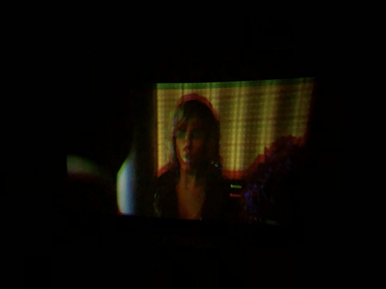

Posted: Fri Jul 29, 2022 1:42 pm    Post subject:
I come back and continue to talk about this C7. after changing some boards, C7 was finally lit, However, it brings a new problem. Using this connection method: pioneer 09fd-hdmi-moone-5bnc-5bnc-c7, the signal source is set to 3, and the displayed image is very dark. It is found that the contrast adjustment of the image is invalid, but the brightness adjustment is normal. I can't find the reason. thank you!

Posted: Fri Jul 29, 2022 1:51 pm    Post subject: Barco 708MM “HOLD DOWN EHT” fault
The brightness of the image is low. Because the contrast adjustment fails, the contrast of the image cannot be increased to improve the brightness, so it cannot be viewed normally

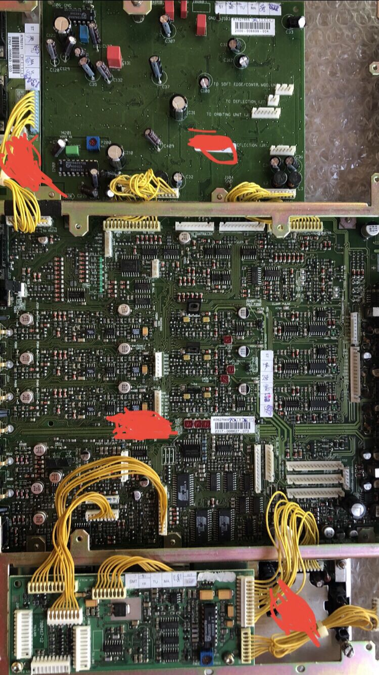

Posted: Sat Jul 30, 2022 2:41 pm    Post subject:
I replaced the GBR board of this C7, and the contrast adjustment function returned to normal

Posted: Sat Jul 30, 2022 2:44 pm    Post subject: Barco 708MM “HOLD DOWN EHT” fault
You can see the words "contrast adjustment" on the GBR board

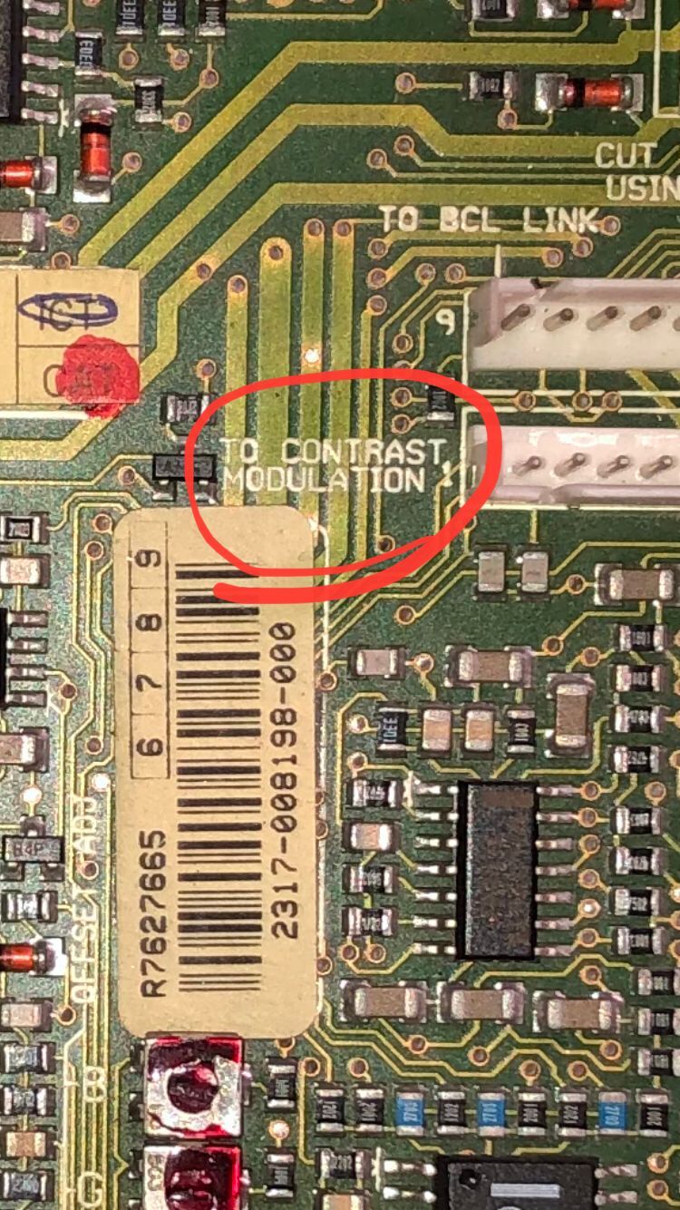

Posted: Sat Jul 30, 2022 9:58 pm    Post subject:
No contrast adjustments on the RGB input board. The text "To contrast mudulation" next to connector J757 means you can connect the optional contrast modulation board R7624845 in there. Something you don't need.

Posted: Sat Jul 30, 2022 11:20 pm    Post subject: Barco 708MM “HOLD DOWN EHT” fault
You're right!

Posted: Sun Jul 31, 2022 12:29 am    Post subject: Barco 708MM “HOLD DOWN EHT” fault
Can you find the contrast adjustment module or circuit unit in the GBR board?Can it be repaired?
