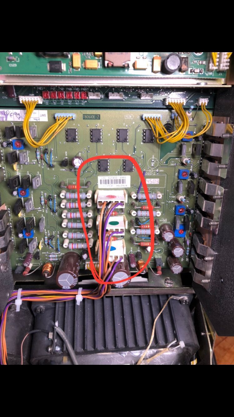

Posted: Sat Jun 18, 2022 8:23 am    Post subject: Barco 708MM “HOLD DOWN EHT” fault
Is the colored logo on the three plugs facing up or down?

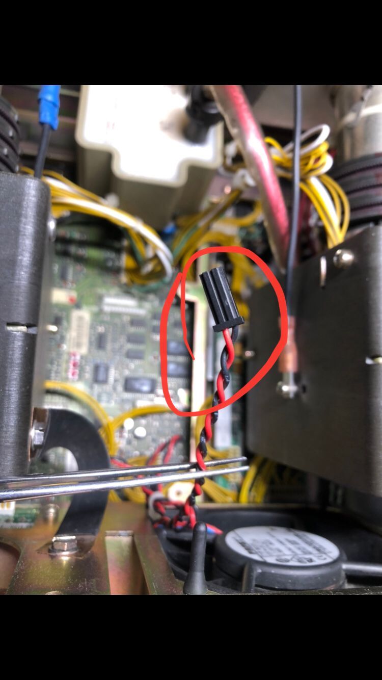

Posted: Sat Jun 18, 2022 8:53 am    Post subject: Barco 708MM “HOLD DOWN EHT” fault

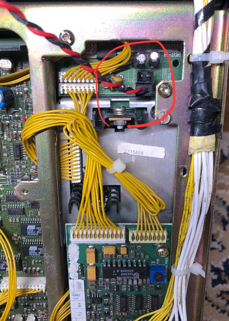

I found a wire out of position. Where should it be installed?

Posted: Sat Jun 18, 2022 1:24 pm    Post subject: Re: Barco 708MM “HOLD DOWN EHT” fault
For someone to help they will probably need to know where the other end of the wire goes. Is it connected the fan in the picture? You could look up the schematic in the service manual and figure it out too.
Posted: Sat Jun 18, 2022 2:39 pm    Post subject:
That's not a Barco original wire. Someone modded that set. IS it a Runco? They did stuff like that all the time.

Posted: Sat Jun 18, 2022 5:41 pm    Post subject:
Where does the other end of the wire go?

Posted: Sat Jun 18, 2022 11:45 pm    Post subject: Barco 708MM “HOLD DOWN EHT” fault

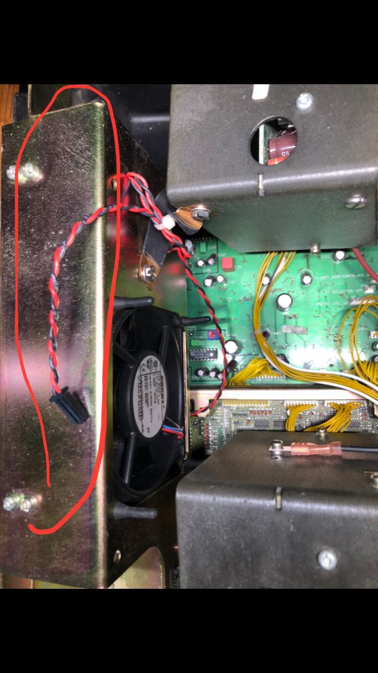

One end of this wire should be led out from the metal component of the fan

Posted: Sun Jun 19, 2022 1:11 am    Post subject:
It’s a fan wire? So what does the service manual say? We have them all on our site. It should show where it connects.

Posted: Sun Jun 19, 2022 11:08 am    Post subject:
Hu,
Right between those two rear fans, there is a small PCB board (with a white J5 connector on it). On the backside of that PCB board, you'll find the connectors for the fans. You can't really reach them, you'll have to remove the metal plate first.
Check your mail for pictures, it seems I reached my max. upload limit here.

Posted: Sun Jun 19, 2022 1:20 pm    Post subject:
Hulio wrote:
Hu,
Yes, I have to remove the fan metal plate。
Thank you!

Posted: Mon Jun 20, 2022 8:52 am    Post subject: Barco 708MM “HOLD DOWN EHT” fault
After remove the fan metal plate, the red-black wire shows up。。。

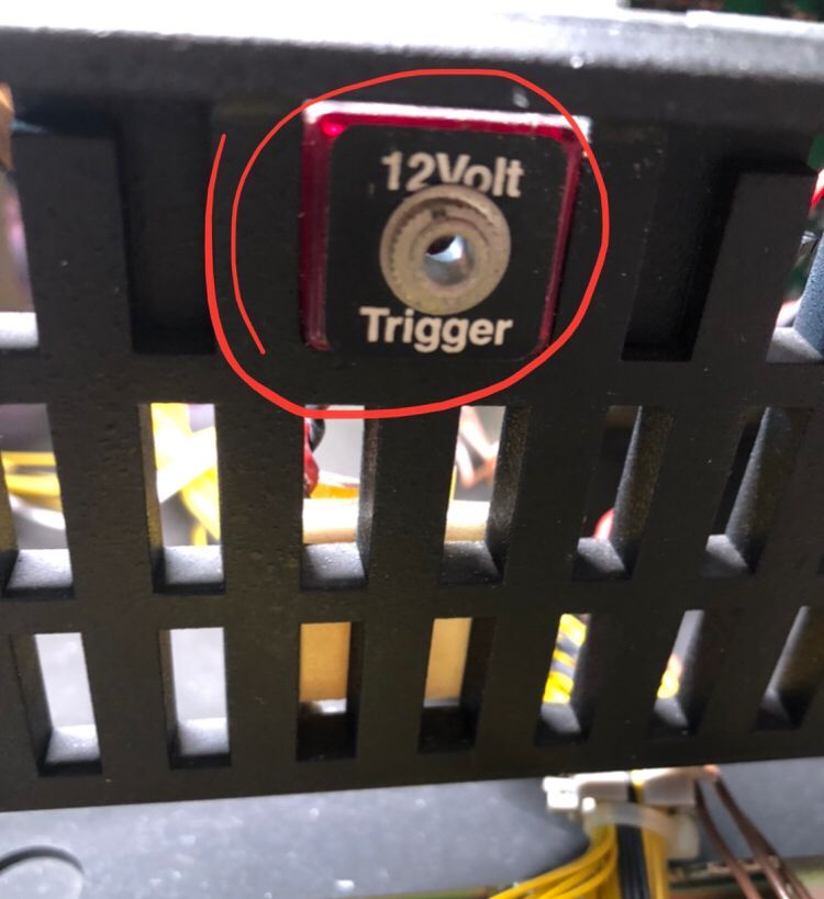

Posted: Mon Jun 20, 2022 9:01 am    Post subject: Barco 708MM “HOLD DOWN EHT” fault
The red-black wire seems to be a wire testing 12V

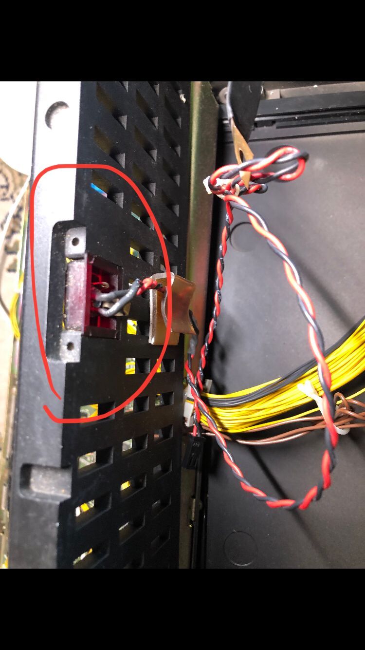

Posted: Mon Jun 20, 2022 9:19 am    Post subject: Barco 708MM “HOLD DOWN EHT” fault
The socket of this wire can exactly match with the two sockets on the baseplate board....I don't know if I can connect them like this or no connect?

Hulio
Joined: 15 Apr 2006
Posts: 494
Location: Belgium
Posted: Mon Jun 20, 2022 11:54 am    Post subject:
Yes, it is ok to plug the fan connector in there.
The 12V trigger is meant to control an electrical projection screen. Barco on, the screen automatically rolls down in his memory position.
Only later designed Barco's had that.
bluemoonhu
Joined: 16 Feb 2021
Posts: 259
Posted: Mon Jun 20, 2022 12:06 pm    Post subject:
Praise Barco!Great Barco...
Thank you!

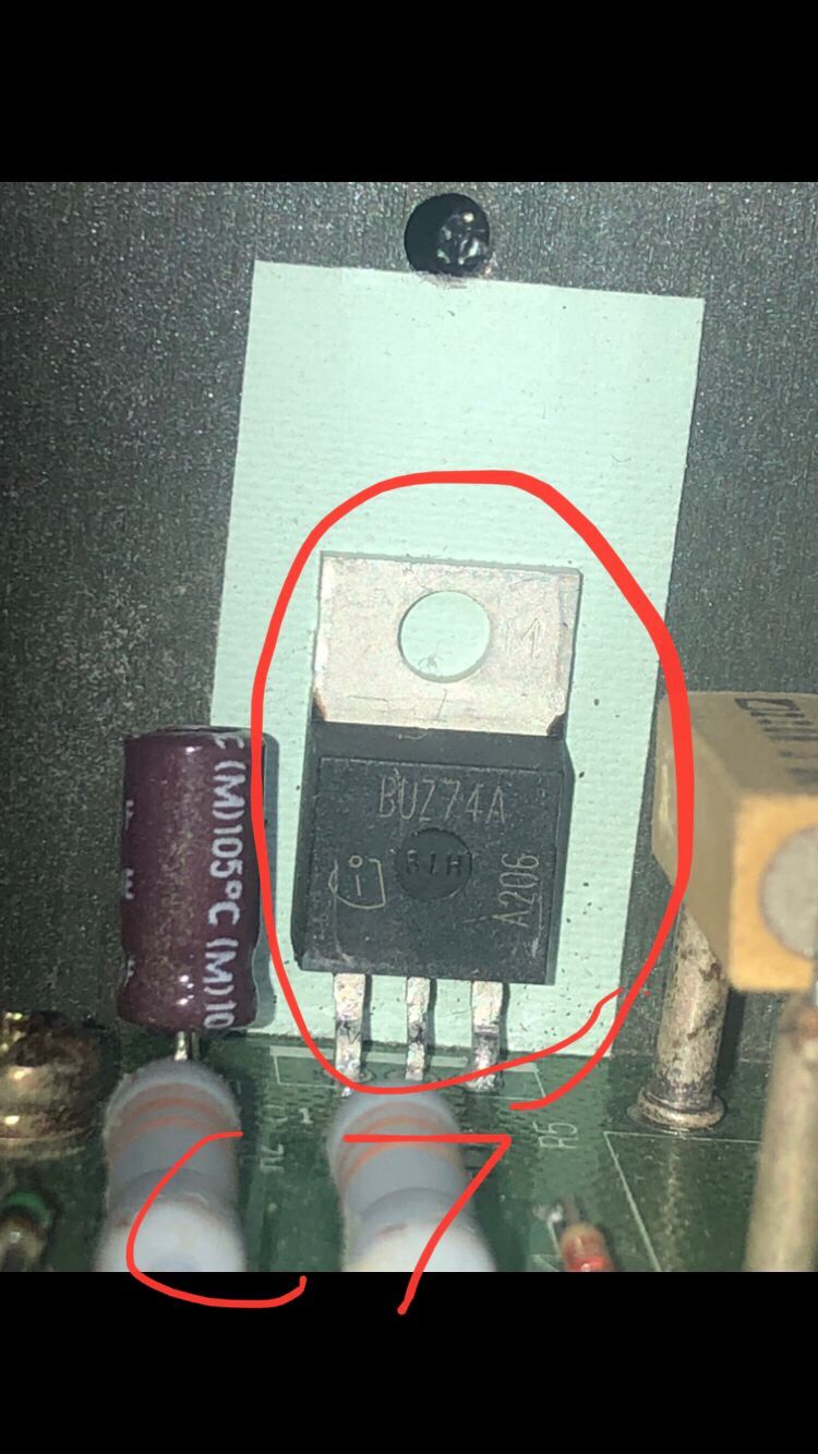

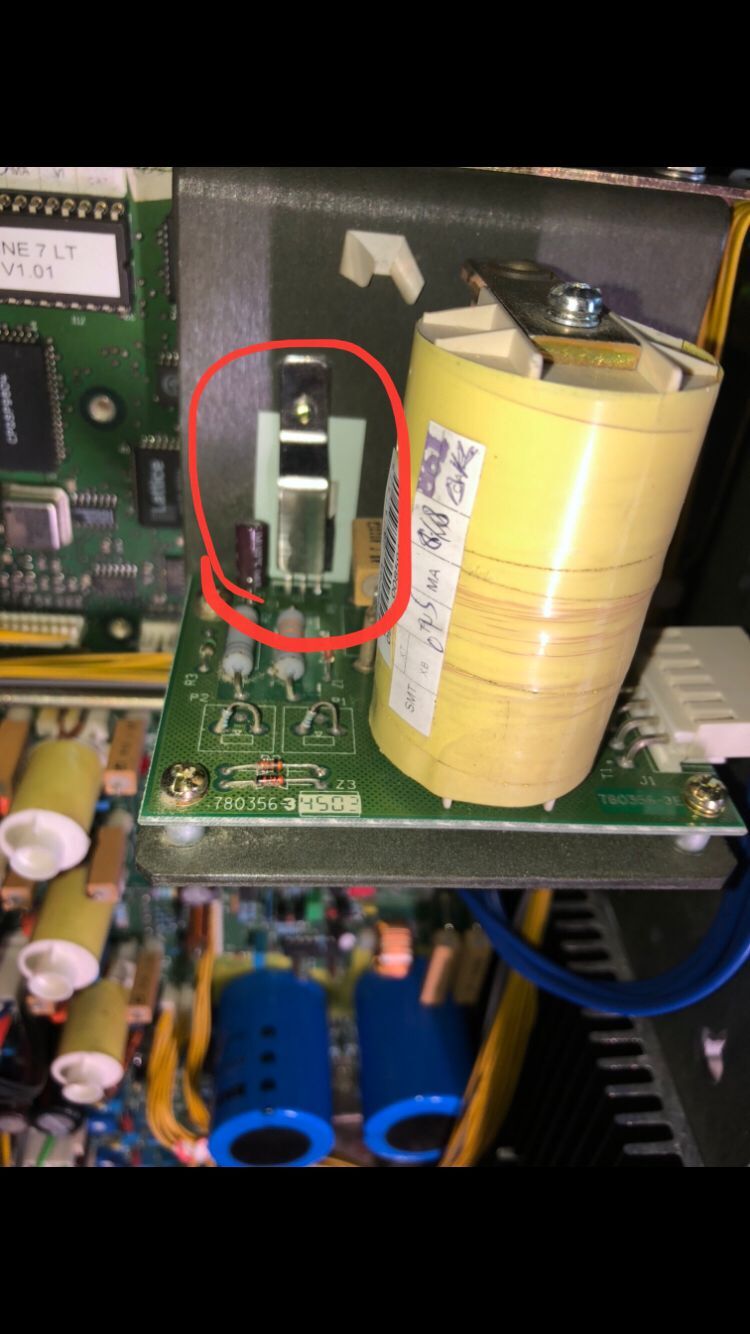

The part in the red circle of C7 is different from the measured value of 708,I don't know if this part is good or bad

Posted: Tue Jun 21, 2022 10:11 am    Post subject: Barco 708MM “HOLD DOWN EHT” fault
This is it

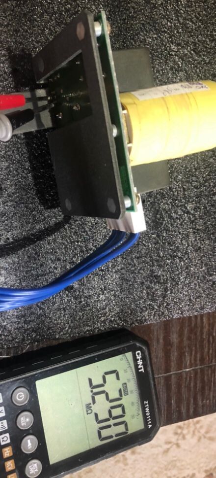

Posted: Tue Jun 21, 2022 10:15 am    Post subject: Barco 708MM “HOLD DOWN EHT” fault
Is the measured value correct?
