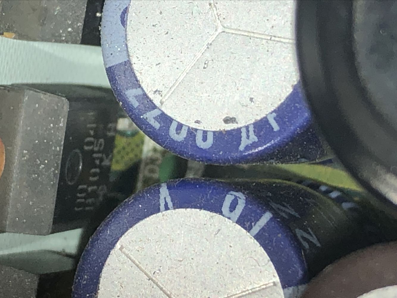

Parameters of D37?I will buy it. thanks!
bluemoonhu
Joined: 16 Feb 2021
Posts: 259
Posted: Sat Jun 04, 2022 4:58 am    Post subject: Barco 708MM “HOLD DOWN EHT” fault
Parameters of D37----B1045
 Filesize:  166.36 KB
 Viewed:  4377 Time(s)

Posted: Sat Jun 04, 2022 6:56 am    Post subject:
No. Looking at the schematics, the only components connected with F13 fuse are D37, C81, C82 and L23 (coil L23 in unlikely to fail).
Send me a PM with your e-mail address and I will send you the schematics of the power supply if you wish.

That's the one. Search for MBR1045 Schottky Rectifier Diode
Hulio
Joined: 15 Apr 2006
Posts: 494
Location: Belgium
Posted: Sat Jun 04, 2022 7:33 am    Post subject:
By the way, don't look at the value when measuring. Just dial the multimeter to diode reading and check the continuity.
The diode should act like a valve, allowing the current in one way only. So you get a beep in one way, and no beep when reversing the measuring probes. If you get on both ways a beep, or on both ways no beep, the diode is shortened and must be changed.

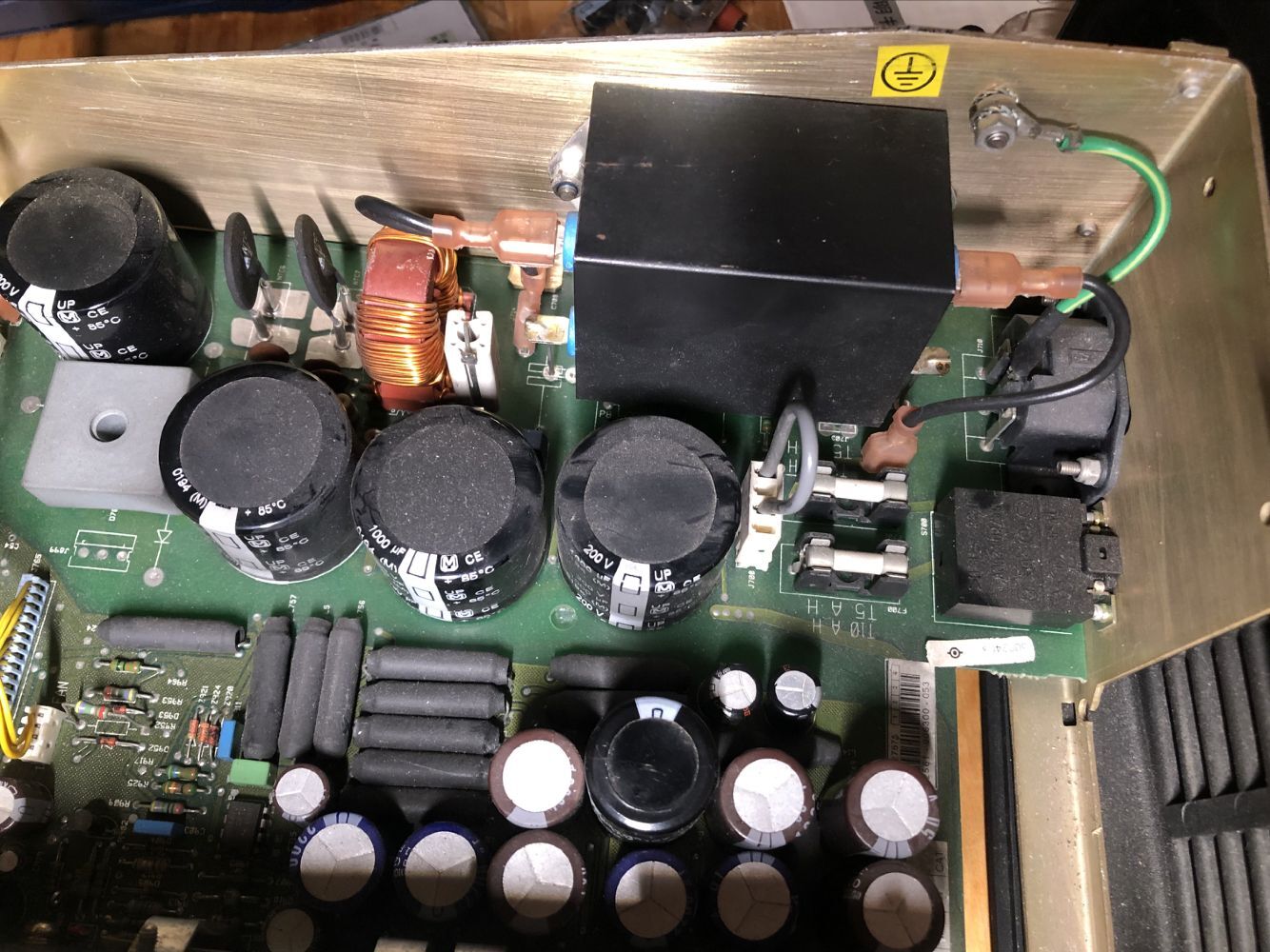

Posted: Sun Jun 05, 2022 2:45 pm    Post subject: Barco 708MM “HOLD DOWN EHT” fault
I don't know whether such a connection mode can obtain 220V?
 Filesize:  228.15 KB
 Viewed:  4297 Time(s)
Hulio
Joined: 15 Apr 2006
Posts: 494
Location: Belgium
Posted: Sun Jun 05, 2022 3:14 pm    Post subject:
That white connector in front of the fuses, with thick grey wire on it. Must be with the text "220V" on it facing upwards.

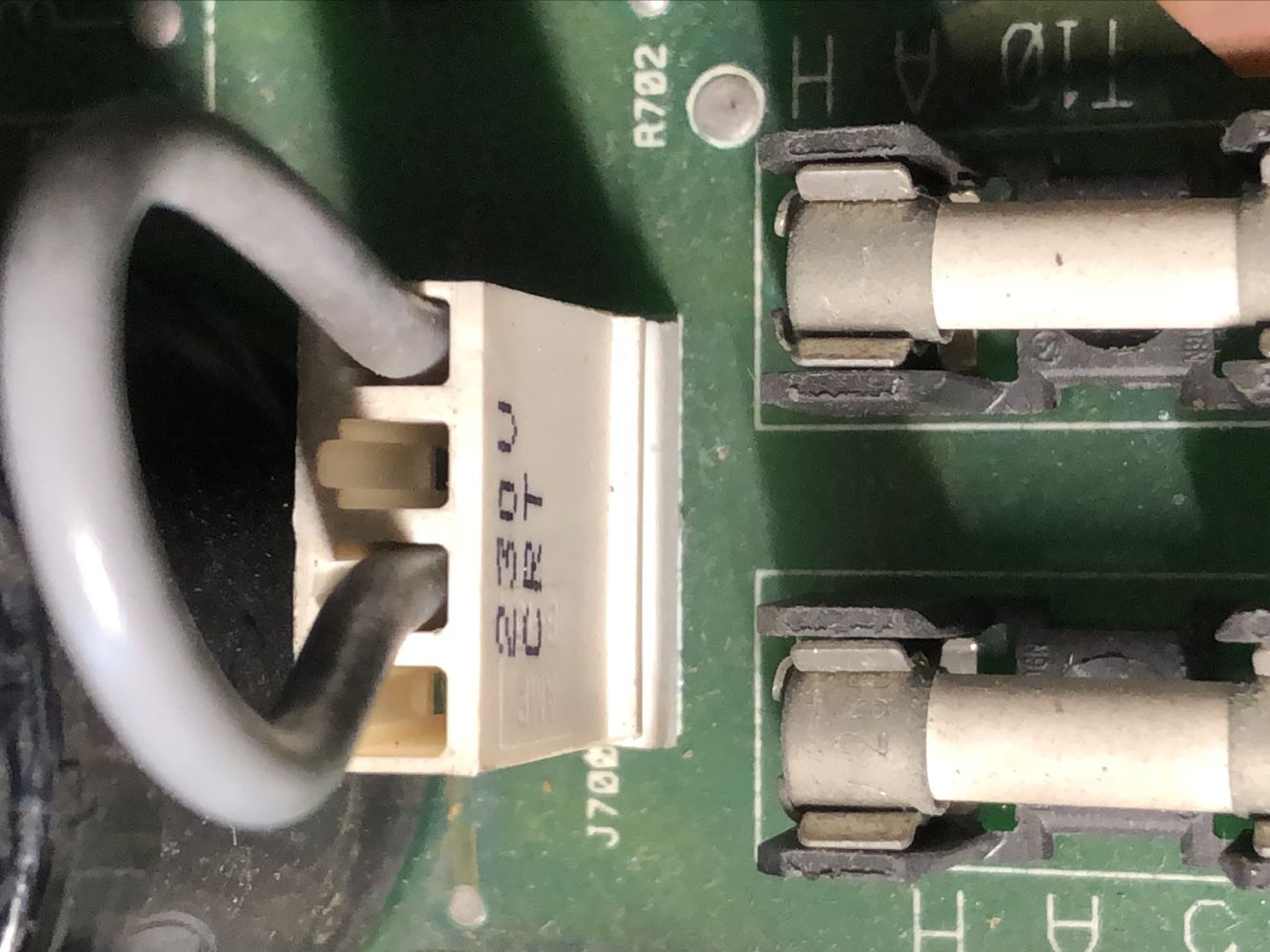

Posted: Sun Jun 05, 2022 10:37 pm    Post subject: Barco 708MM “HOLD DOWN EHT” fault
Is it reversed?
 Filesize:  153.89 KB
 Viewed:  4284 Time(s)
Hulio
Joined: 15 Apr 2006
Posts: 494
Location: Belgium
Posted: Mon Jun 06, 2022 6:45 am    Post subject:
Yep, J700 is the one. It is already in the right position, I see 👍
