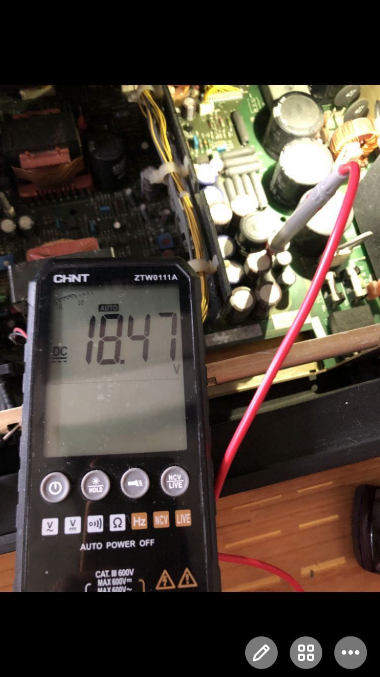

The voltage of L14 is not very stable, and the fluctuation value is between 17.7-18.8v
bluemoonhu
Joined: 16 Feb 2021
Posts: 259
Posted: Mon May 30, 2022 9:19 am    Post subject: Barco 708MM “HOLD DOWN EHT” fault
The voltage of L14 is not very stable, and the fluctuation value is between 17.35-18.8v

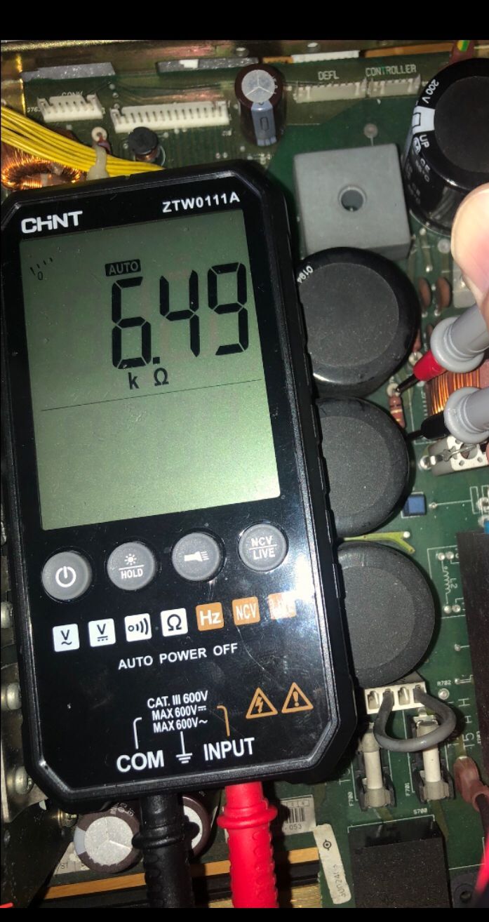

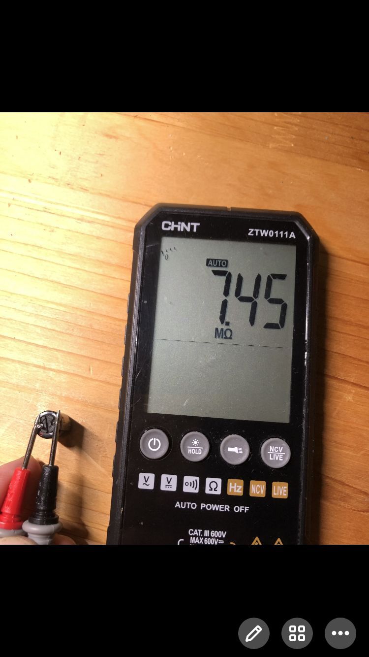

Posted: Mon May 30, 2022 12:06 pm    Post subject: Barco 708MM “HOLD DOWN EHT” fault
C45 is removed

Posted: Mon May 30, 2022 2:45 pm    Post subject:
Can't your multimeter be set to capacitance ? It should read 470uF (with a tolerance of 10%).
bluemoonhu
Joined: 16 Feb 2021
Posts: 259
Posted: Mon May 30, 2022 3:20 pm    Post subject:
yes! Iwill buy a 470uF capacitance .

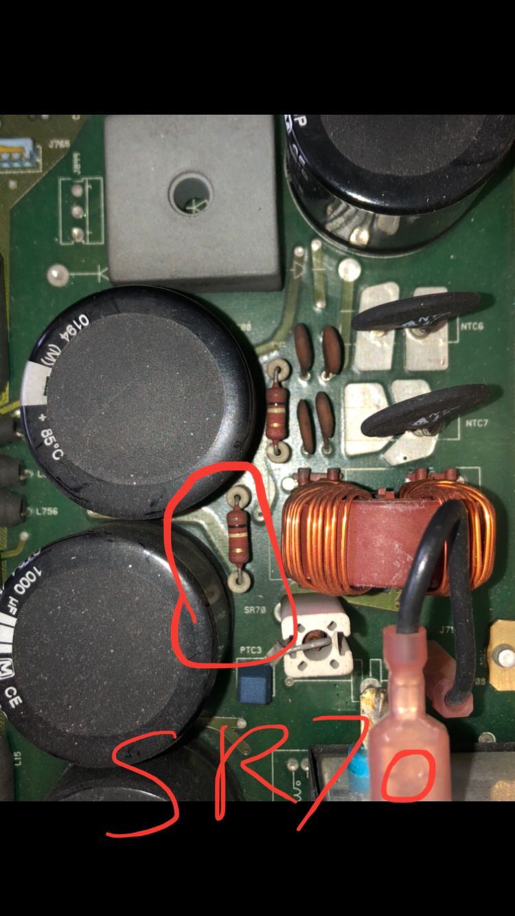

Ok. In the meantime, you can also check the safety resistors SR20 and SR70. No need to desolder those, just check for the continuity, like a fuse.
SR20 is close to the quadrupler, SR70 in upper-right corner of the SMPS (close to those big capacitors).

Posted: Tue May 31, 2022 2:09 am    Post subject: Barco 708MM “HOLD DOWN EHT” fault
SR70
 Filesize:  128.67 KB
 Viewed:  2334 Time(s)

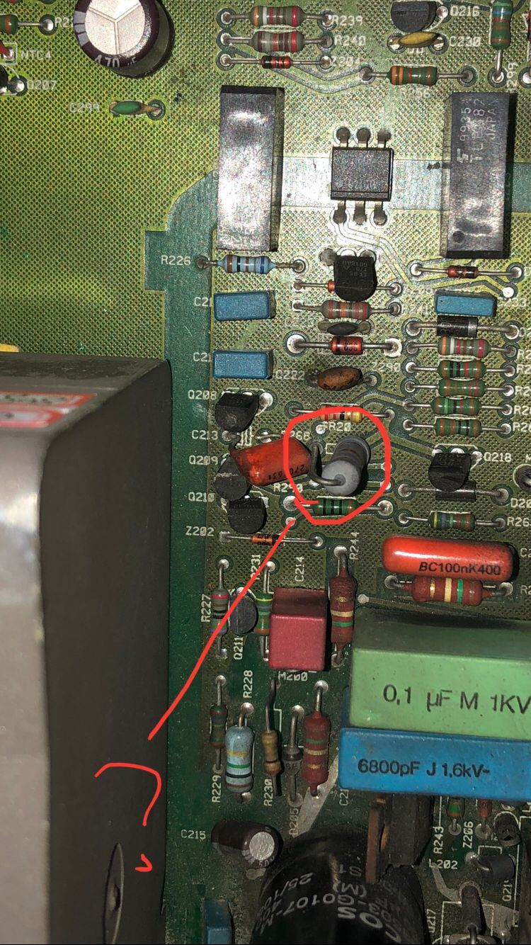

SR20 or R20?
 Filesize:  261.97 KB
 Viewed:  2333 Time(s)
bluemoonhu
Joined: 16 Feb 2021
Posts: 259
Posted: Tue May 31, 2022 2:58 am    Post subject:
SR20 or R20--269Ω,it's normal

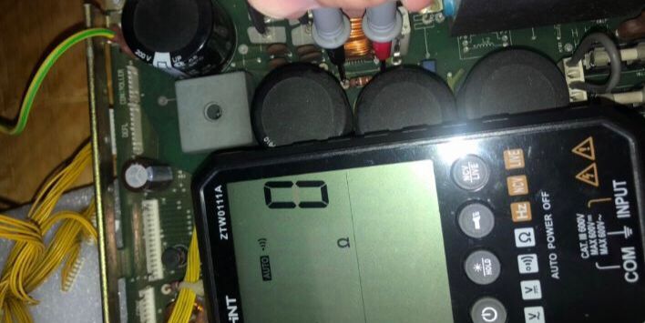

Posted: Tue May 31, 2022 3:58 am    Post subject: Barco 708MM “HOLD DOWN EHT” fault
SR70
 Filesize:  143.22 KB
 Viewed:  2326 Time(s)
bluemoonhu
Joined: 16 Feb 2021
Posts: 259
Posted: Tue May 31, 2022 3:59 am    Post subject: Barco 708MM “HOLD DOWN EHT” fault
SR70
 Filesize:  42.77 KB
 Viewed:  2325 Time(s)
