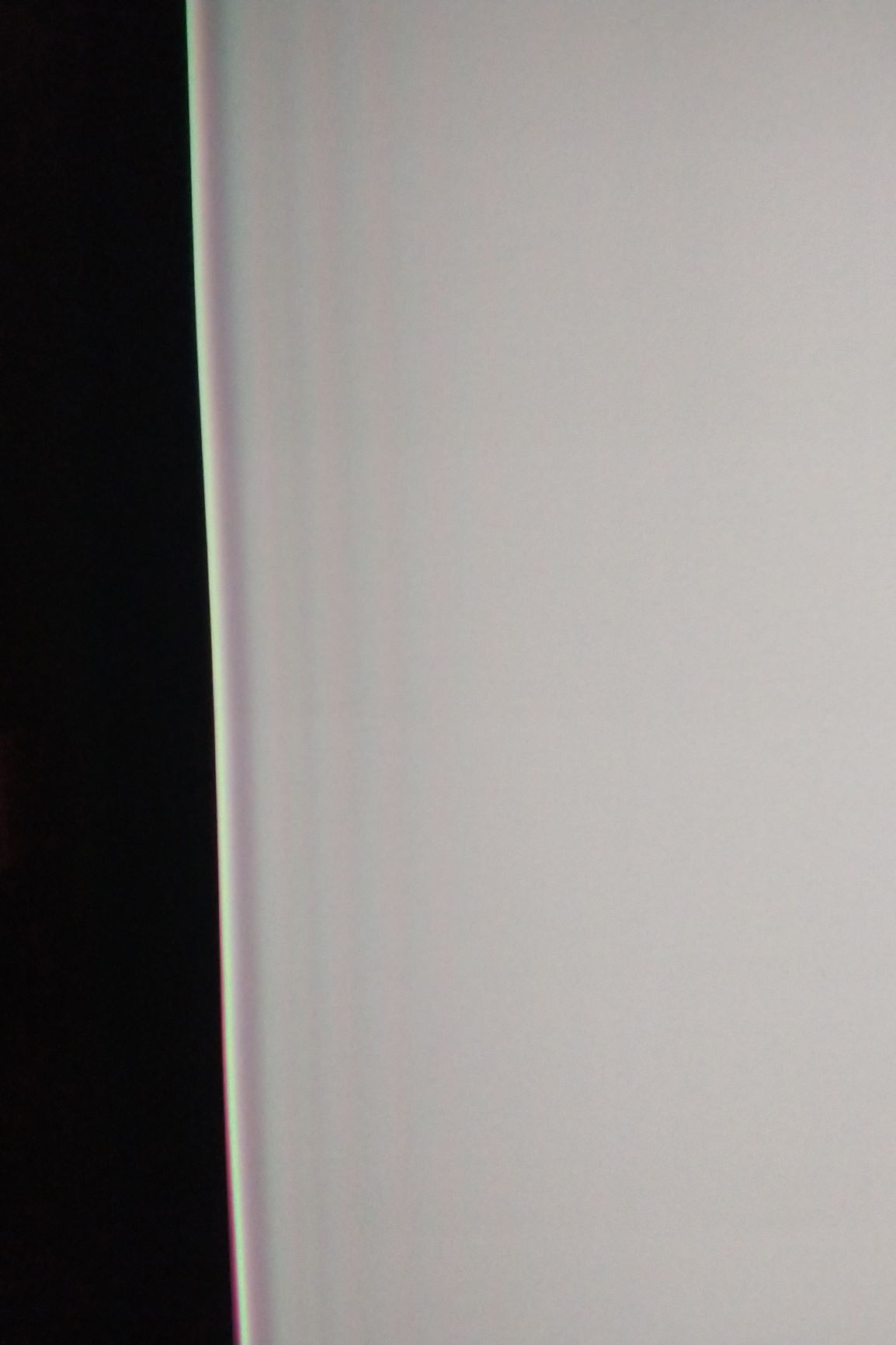

So, as far as the other issue is concerned, when projecting the internal full white image from the crosshatch menu, here is what I am seeing; There seems to be some sort of "crushing" concentrated only on a small segment of the left hand portion of the screen running vertically (they appear like ripples).
I have no clue what this may be, or, if it was precipitated by me

Looks like "raster ringing". Search the forum for it. Common issue.

Raster ringing is a very common issue, not only with Marquee projectors but any CRT (since it's raster related). Examples:

Some with video processors (like a Radiance) will use a wider raster width so that a large front porch can be used to allow the image to stabilize before it gets into the active image area.
I remember doing something similar with my Barco projectors where I would increase the raster size so that the left side was off the tube face but I put the active image area all the way to the right in the raster within the active phosphor. Same idea.

From what I was able to comprehend, the core of this issue is related to "ringing caused by the resonance of the interwinding capacitance of the horizontal deflection yoke and any series inductance; That includes the wires connecting the HDM and the yokes"
It seems that you have outlined a manner by which to effectively contend with it in your reply; I need to examine the details in greater detail since I am assuming that it will necessarily require a complete reset of the system. Or, alternatively, investing in some highly modified boards which I am unable to invest in at this time.

From electrical standpoint none, it is totally up to the viewer's personal tolerance. It is more visible with light content.

Not necessarily. Increase raster width, move the active image area to the right of the raster to get it away from the ringing area, then center on the tube face. You'll probably need to do some minor convergence geometry adjustments too. The whole thing should take 5-10 to do for someone experienced with Marquee setup. How much you can get rid of it depends also on the porch sizes created by the source device, so no way to know ahead of time how much this'll help. I suggest just trying it to see.
