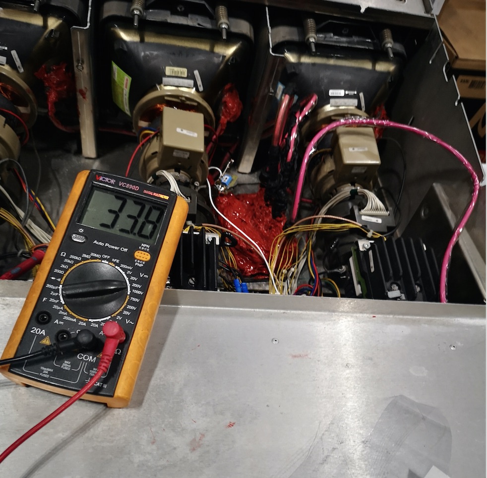

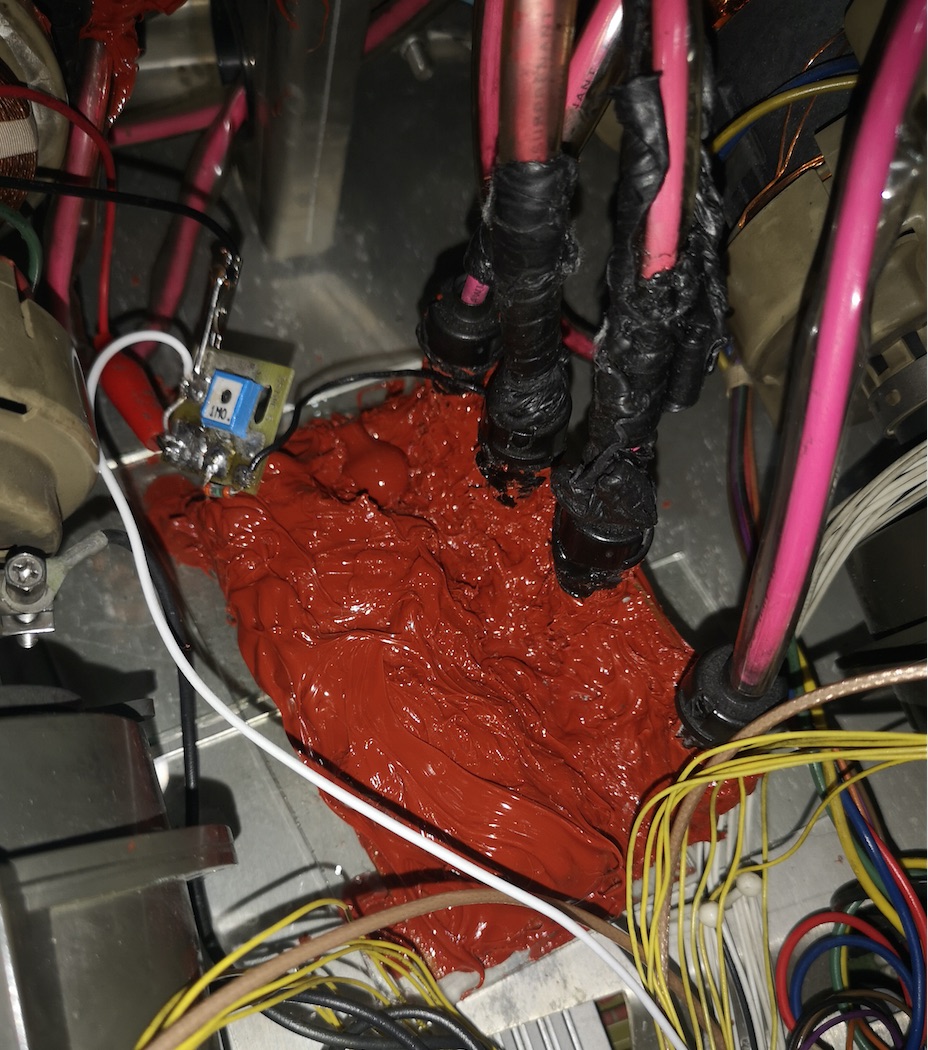

I have installed the DIY splitter and it is potted in red high temp silicone,
The red silicone is rated at 650 degree f, and is a branded automotive RTV silicone gasket maker.
For me high temp and high voltage insulation are totally related.
So far no hissing sound and voltages are stable at 33.8V dc.

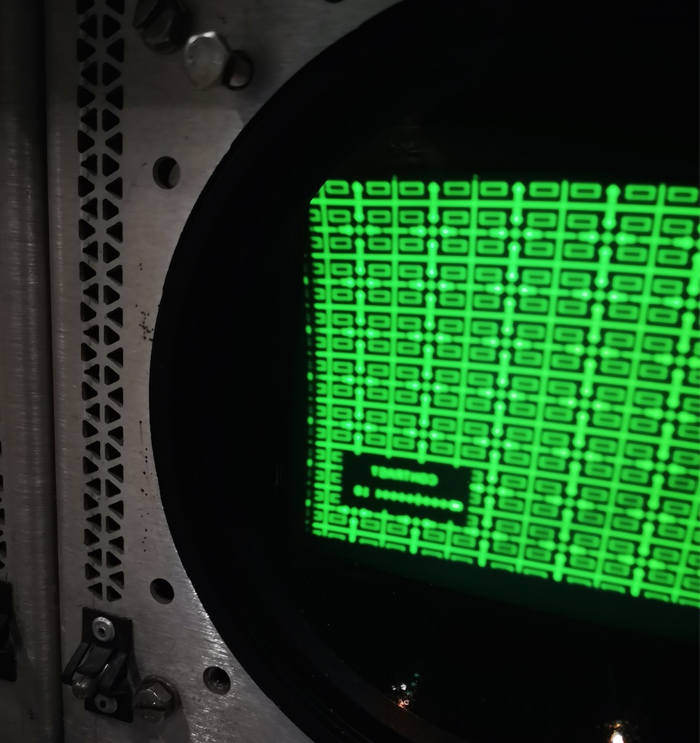

Main issue, FOCUs is really bad. As shown in the pics below, contrast is down to 20 to avoid blooming.
Out of focus is on all three crts, had to rule out video amps,
since on a normally working splitter, the focus was tight on these same neck cards.
Pleass help me out guys, what causes the blooming / soft focus ?

out of focus screen shot
jaredjaric
Joined: 05 Jun 2007
Posts: 228
Location: Philippines
Posted: Sat Oct 17, 2020 5:55 pm    Post subject:
screen shot

Posted: Sat Oct 17, 2020 11:02 pm    Post subject:
I'm completely impressed that it works! Smile
If you have blooming, you have bad HV regulation. If it's the same as before you modded the splitter, then I'd suspect the EHT board. If not, then the quad.
Those are the only 3 parts in the entire HV section, the problem is, they all interconnect, with that white wire being the feedback loop from the HV output to the EHT board. But.. there's nothing else outside of those 3 parts that can cause HV problems.
While a scan fail will affect HV, it will simply shut it down, and not cause blooming or other HV problems. Ditto for a bad video card, as there's a connection between one of the RGB cards and the scan fail shutdown line.

This red thing reminds me of the movie The Blob Very Happy
