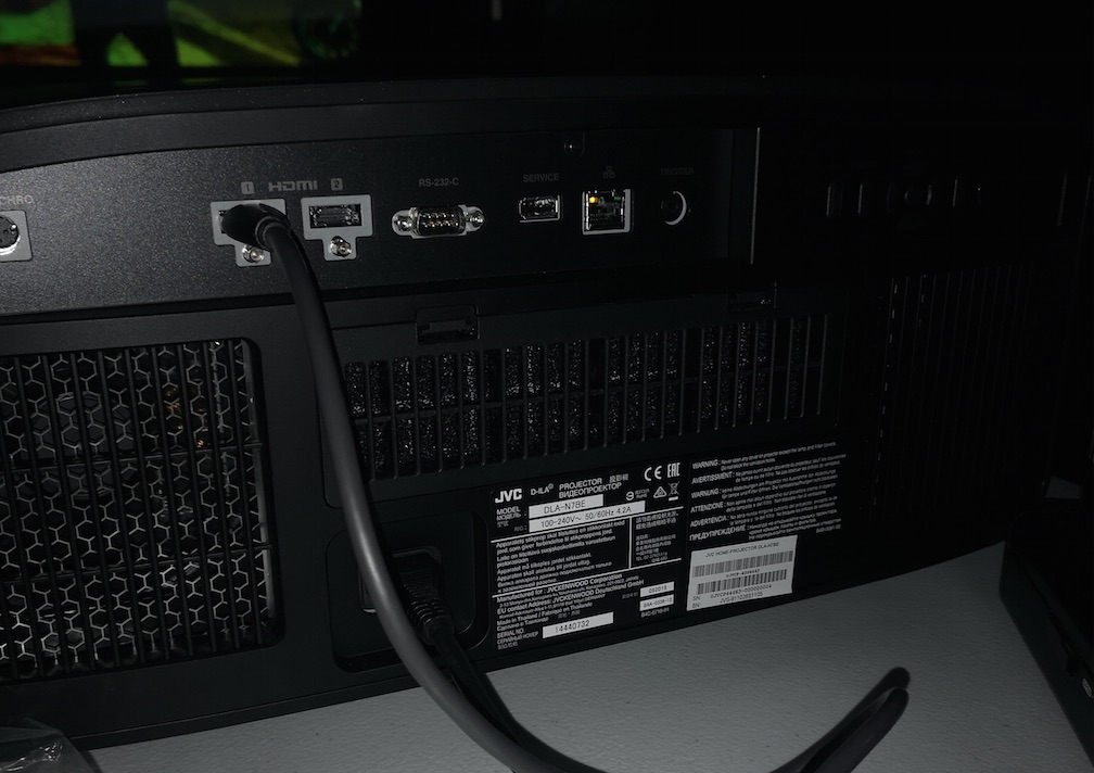

Posted: Fri Sep 18, 2020 4:44 am    Post subject: tried digital last May
I made a comparison of JVC N7 ( NX7) last May,
it wins in sharpness definitely,
the subtitles are very important.
I have enjoyed reading the subtitles, and went into zombie mode.
digital is the way to go if you love to get engrossed in the movie,
Korean language just seems so fluid.
Forgot about the good flesh tones of CRT,
or CRT's great Dark scenes with all the highlights and perfect shadows ?
Digtal has HDR10+ and Dolby Vision embeded already for free,
that a Lumagen/crt combo does with full control seperately but for around 3k to 9k , plus the all the hdmi conversion in between.
During the movie, while reading the texts intently.
Ever so suddenly a bright Bluish light comes on and it is like the sun is an oncoming Car,with HID headlight
is in front of you. It so real or surreal.

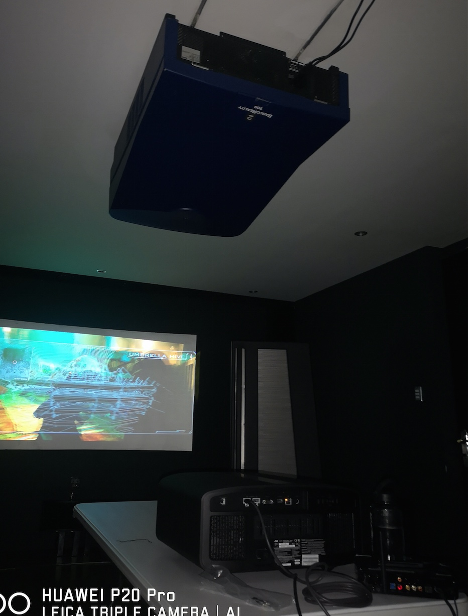

Posted: Sat Sep 19, 2020 7:52 am    Post subject:
A white ceiling is contrast killer number one. CRT contrast cannot show its potential.
Any plans that you paint it black ?

Posted: Sat Sep 19, 2020 8:43 am    Post subject:
HI Eits,
Any spliiters to spare?
I agree with you, but my wife hates an all black room.
it is not my Bat Cave, she is the one that uses the PJ 90% of the time .
And actually the first 60cm of the ceiling is all black( starting right above the screen),
it was just too dark on the Pics to show. Smile

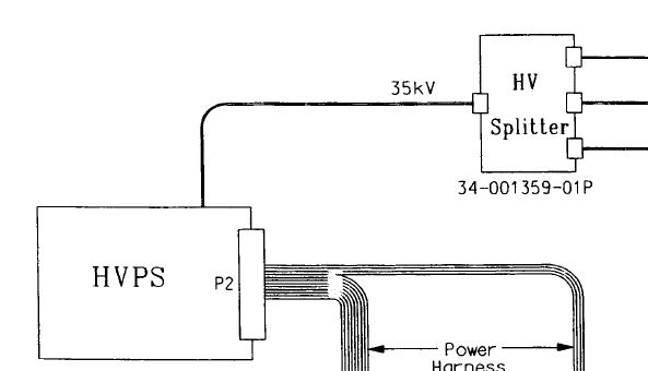

Posted: Sat Sep 19, 2020 12:35 pm    Post subject:

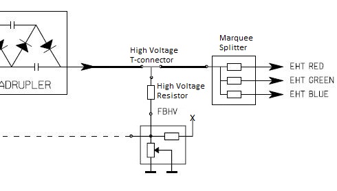

In theory, it would be possible to replace the Barco splitter with a splitter from a Marquee (which rarely fail). What would have to be compensated is the missing High Voltage feedback line. Inside the Barco splitter there is a resistor connected to the HV-Line which -together with the pot on the small PCB- works as a voltage divider (something like a 1000:1 ratio). If this resistor could be placed at the input of the Marquee splitter, it just would do the same as in the Barco.
Please refer to the pictures below. The required resistor would have to be a HV-type or a chain of smaller resistors. Its value would have to measured (difficult) or to be calculated from the pot value.
If we call the HV-Resistor R1 and the pot R2 then for a 1000:1 ratio (Vin = 1000 * Vout) the formula is as follows:
R1 = R2 * ((Vin-Vout)/Vout)
So for 35KV as Vin, 35V as Vout and a pot value of 100K ohms (=100000 ohms) we would get:
R1 = 100000 * ((35000-35)/35) = 99900000 ohms
So, this would be a 99,9 megaohms resistor

Posted: Sat Sep 19, 2020 4:29 pm    Post subject:
That looks like a high voltage problem and you'll probably do better using a high voltage probe to verify the 35K
The one in the image will be shipped to Tim Martin soon, check with him about either using it or if he'll want to sell it. It works with most Fluke digital meters. It's what I've used to work on the 909's back in the day.

Hi Mike,
I did opened up the splitter , and did found 4 100kohm resistors in series and another three on the output to RGB,
plus 4 caps of 6000pf at only 10kv rating.
The caps are definitely the ones failing.

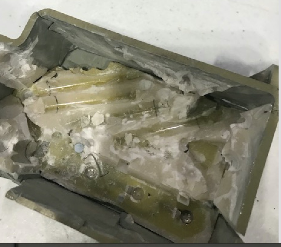

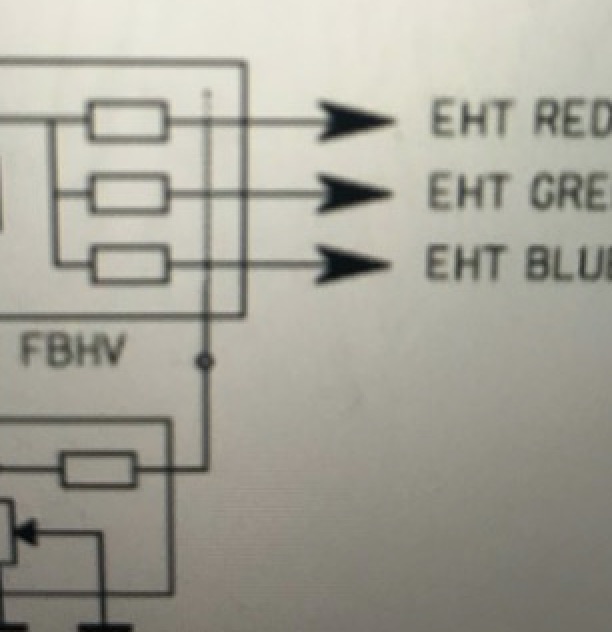

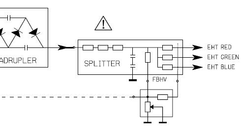

Posted: Mon Sep 21, 2020 2:53 pm    Post subject: splitter inside wiring
HI Mike,
Hope you can help me on this, i have opened up two splitters and can not spare the wires, all the wirings are just messed up after carving out the epoxy.
Is it possible for you to explain how the wires to the RGB posts are connected ?
 Filesize:  52.41 KB
 Viewed:  6483 Time(s)

Posted: Mon Sep 21, 2020 2:56 pm    Post subject: splitter close up
here is one of the splitters cracked open.

Posted: Mon Sep 21, 2020 4:27 pm    Post subject: Re: splitter close up
Check with barclay66 concerning what is in the insides of the splitter. as it seems he had already mentioned something on this previously in this thread.
With it having a very few components I'm thinking repair should be achievable once you can deal with removing the compound.
When you can present the parts that are in there, then I'll like to get involved in which components to use and even how to build back up to put it all back together.
Be mindful to use only potting material that's high voltage rated. That means it would have a zero water or moisture content during manufacture.

Posted: Mon Sep 21, 2020 4:40 pm    Post subject:
regarding the insides, i have determined the resistors are 6 10k ohms carbon type 3watt ratings and caps at 4 pcs. 6kpf 10kv rating and that is all.
i just don't know what those dotted lines in the diagram means, it shows parallel wiring, which i doubt very much.
