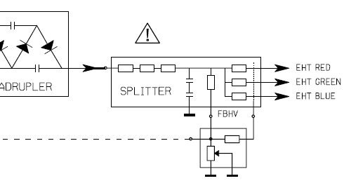

i mean are those RGB posts wired in parallel going to the eht feedback board ?
Posted: Mon Sep 21, 2020 5:56 pm    Post subject:
According to the image Barclay posted in a thread previously, there seems to be something on each post. Waht those devices are I have no idea.
Curt may be of help here, and if not maybe Barclay would know what's going on inside that unit, because he had suggested looking at using a Marquee splitter I think.

Those on the posts are resistors at 10kohm each, i am referring to the dotted line, does it mean high voltage?
Posted: Tue Sep 22, 2020 1:12 pm    Post subject:
The dotted line in the diagram is a Feedback line that's used to regulate the high voltage as Curt pointed out. That section of the diagram is where the sealed Pot is located. You should see a small and separate maybe shielded wire connected on the splitter that also goes to the chassis. That wire would be your dotted line on the diagram.
That area in the diagram and on the splitter would be what we call a "Critical Safety Component" area. And is also as Curt had pointed out would need to be a precisely set Pot (glue). That Pot would either be used to help regulate the high voltage or be used as a shut down enable for over voltage protect, or both.

jaredjaric wrote:
regarding the insides, i have determined the resistors are 6 10k ohms carbon type 3watt ratings and caps at 4 pcs. 6kpf 10kv rating and that is all.
i just don't know what those dotted lines in the diagram means, it shows parallel wiring, which i doubt very much.
on barclay`s picture it suggests there are only 2 caps present in the splitter.
so you say there are 4 caps?
and if so how are they connected?
perhaps 2 in series with the other 2 also in series and paralelled.

I just found out what those dotted lines stand for.
It is the barco mega ohm resistor going back to the eht diagnostic circuit.
Posted: Wed Sep 23, 2020 3:41 pm    Post subject:
It's actually that shielded white Teflon wire that is super hard to strip. I made the mistake more than once of forgetting to connect that, or the hot wire came loose after soldering, and I didn't catch it. That will also send the EHT to well over 50Kv, and arcing happens everywhere. I was lucky not to blow the neck of the tubes off!

barclay66 wrote:
In theory, it would be possible to replace the Barco splitter with a splitter from a Marquee (which rarely fail). What would have to be compensated is the missing High Voltage feedback line. Inside the Barco splitter there is a resistor connected to the HV-Line which -together with the pot on the small PCB- works as a voltage divider (something like a 1000:1 ratio). If this resistor could be placed at the input of the Marquee splitter, it just would do the same as in the Barco.
Please refer to the pictures below. The required resistor would have to be a HV-type or a chain of smaller resistors. Its value would have to measured (difficult) or to be calculated from the pot value.
If we call the HV-Resistor R1 and the pot R2 then for a 1000:1 ratio (Vin = 1000 * Vout) the formula is as follows:
R1 = R2 * ((Vin-Vout)/Vout)
So for 35KV as Vin, 35V as Vout and a pot value of 100K ohms (=100000 ohms) we would get:
R1 = 100000 * ((35000-35)/35) = 99900000 ohms
So, this would be a 99,9 megaohms resistor
I get it,
Inside the barco splitter is a 150 Mohm resistor.

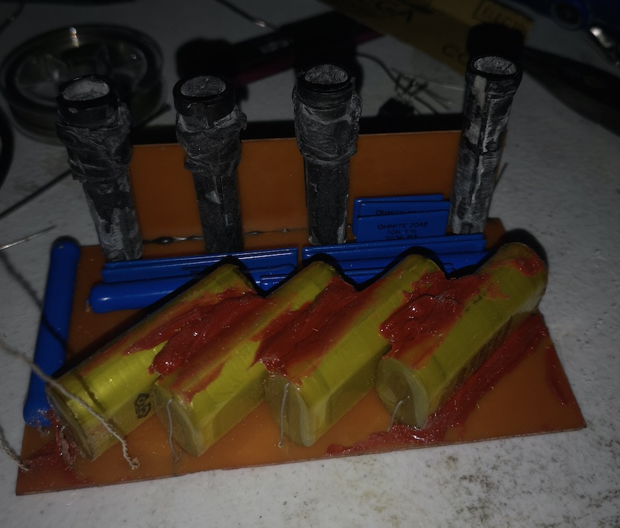

Posted: Wed Oct 14, 2020 5:14 pm    Post subject: splitter rebuild
after stripping and scraping bad splitters,
I am rebuilding or making a new one, all resistors are metal film 5kv rated, and caps are the eros 30kV rated 3000pf .
I have an old school tech guy doing it for me to make sure all is right.
Hoping this goes well

Posted: Thu Oct 15, 2020 4:34 am    Post subject:
https://www.ebay.com/itm/3000PF-10-30000V-9102-MKT1815-METALLIZED-POLYESTER-FILM-CAPACITOR-EFO-EHP3N0D30/191993046508?hash=item2cb3ad65ec:g:jAIAAOSwLF1X~S2J
these are the same caps
dvh99
Joined: 25 Dec 2009
Posts: 2158
Location: nederland
Posted: Thu Oct 15, 2020 4:41 am    Post subject:
https://www.ebay.com/itm/1-Lead-polystyrene-Film-High-Voltage-Capacitor-CB80-30KV-3000PF-4-Marx-generator/312745973860?hash=item48d11cd864:g:C8kAAOSwbe9dZSEM
might prefer polystyrene there
dvh99
Joined: 25 Dec 2009
Posts: 2158
Location: nederland
Posted: Thu Oct 15, 2020 4:46 am    Post subject:
1 more thing to consider is shelf life.
i have no clue how long these caps stay well but the first link and the equivalent of the ones in the barco splitter are new old stock and perhaps 25 years of age.
to be on the safe side i`d opt for the second link i provided but maybe curt or barclay ormike chime in and have a more professional verdict.

In any case I always would use new parts when building something. Especially when it comes to high voltages and/or currents. First of all, the plastic used for capacitors could develop cracks over time and resistors age too. Secondly, newer parts tend to be smaller and could give You an advantage as You could leave more space between them.

I am using these NOS polyester films as i have a bunch of them,
I will try those polystyrene later, tech guy says they maintain capacitance better at HV , but more prone to heat stress.
but i really prefer the higher temp ratings of polyester films.
it has better insulation both from voltages and heat.

Posted: Fri Oct 16, 2020 8:03 am    Post subject:
not cheap but sufficient electrical insulation i guess.
you might want to contact barco and ask which compound they used or in any case which properties the compounds used have as the one from the link above is plus 100 euro.

i am also very curious how this works out.
you might want to use some sort of vacuum chamber to get most of the airbubbles trapped inside out.
Posted: Fri Oct 16, 2020 11:57 am    Post subject:
I think this is the key. I mean, mostly anything you can use will have sufficient dielectric strength. On the long run the stability is question, whether it develops micro cracks or how it absorbs water, but datasheets don't tell much in this regard.
Also you have to be careful with the vacuum too, if the vacuum level is too good it may prevent the compound to cure.
