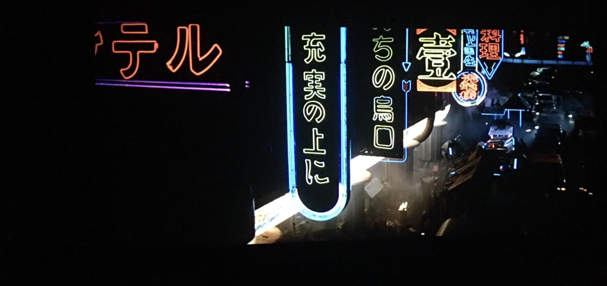

Posted: Sun Aug 30, 2020 5:41 am    Post subject:
Cool

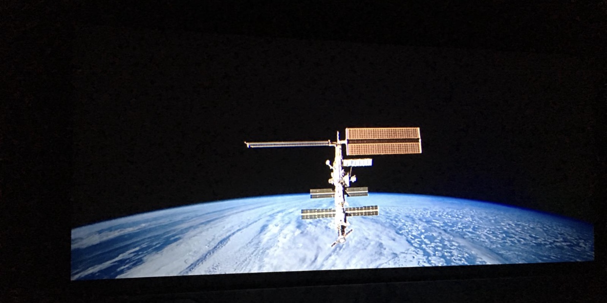

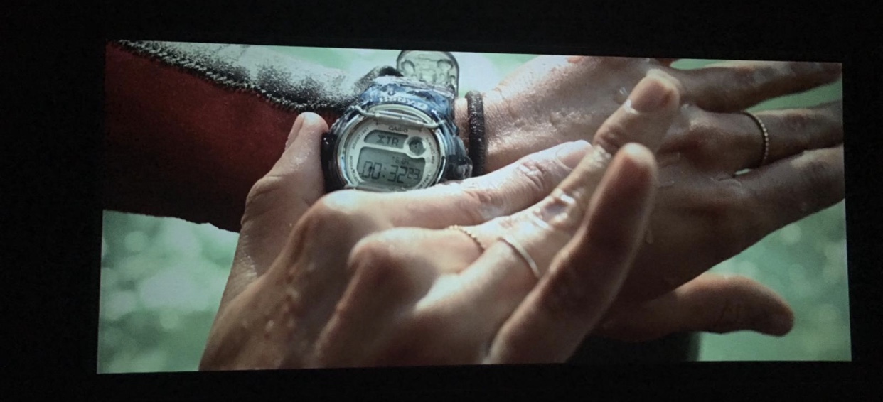

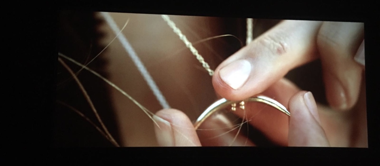

Posted: Sun Aug 30, 2020 5:51 am    Post subject:
Thumbs Up

General BB
Joined: 29 Feb 2016
Posts: 18
Posted: Sun Aug 30, 2020 9:13 am    Post subject:
@ElTopo
I think that the interest in watching your photos belong somewhere else. Maybe a photo thread.
Kal explained this to you well.

Posted: Sun Aug 30, 2020 9:36 pm    Post subject:
As you mention kal, its hard to see much from a screenshot, what i see in Eltopos shots is a lot of processing, and we all know that no CRT can properly resolve 1080P 8bit, so that parameter is likely related to lack of information on the screen. The JVC N series is resolving 1080P 8 bit very well, UHD 10 bit is some behind, but no worse than most other 4K UHD projectors.

Posted: Mon Aug 31, 2020 12:06 pm    Post subject:
Even if (what i don't think) a 9 inch CRT is not able to "resolve" 1080p with 8 bit correctly the picture looks absolutely amazing especially with 4K UHD coming 1080p from an Oppo.

Posted: Mon Aug 31, 2020 2:35 pm    Post subject:
The fast test would be to put on your copy of DVE and display the Pixel Phase test pattern, then shoot a screenshot of the 1:1 pattern there you will see both bandwidth, tube and lens related issues resolving it. To determine the 8 bit resolution you can try measure a 8 bit gray scale, what tolerances do you think it takes to call it resolved?
I dont dispute that you prefer your CRT image over everything else, just find it sad when die hard CRT fans dont know the basic limitations of the CRT. The same can be said about digital, you need a open mind, some willingness to understand the strength and limitations to get the best compromise no matter what type of projector you have.
